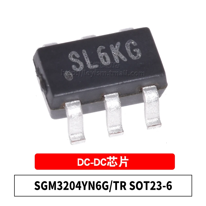

https://ae01.alicdn.com/kf/S5bcfc51f4ea0464dac9383b3cba98120W/5-sztuk-SGM3204YN6G-TR-SL6-SOT23-6-Brand-New-and-original.jpg (SGM3204YN6G photo)
https://www.sg-micro.com/uploads/soft/20211209/1639041870.pdf (SGM3204YN6G datasheet)
APPLICATIONS
GaAs Bias for RF Power Amps
The device is typically supplied by a pre-regulated supply rail of 5V or 3.3V.
