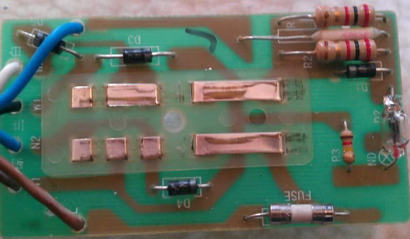

Hi all,
My electric blanket has four settings. 0(off), 1(low), 2(med), 3(high). Low setting works, but 2 & 3 stopped working. odd. I took it a part, not a lot going on. I removed the components & tested them, they all seem to be working (diodes, resistors, thermal fuse etc..). Looking at the contact pads on the board, it looks like it's worn away, but using MM on continuity it seems fine. Looks like it's still copper. (I have since re-tinned (is that the term) the contacts.)
Switch seems to be functioning ok. I soldered a wire to the live & a wire to the neutral then using alligator clips, jumped the contacts to each setting (low, med, high). Seems to detect doing that (led indicator light comes one, whereas it would only come on using low setting), so I suspect contact between the switch and the pads being the issue. Unfortunately I must have touched something, blew the fuse.  :palm:
Looking online, I'm having trouble sourcing one. Closest is Mouser but they don't carry in stock so would be 12week wait (plus post). Most fuses I've come across seem to be the cylinder type that needs to go into a fuse holder, I need one with the axial legs to solder through-hole.
Written on the fuse itself is, "T800mA 250v". Not 100% sure if it's a 'timed' or 'fast blow'. Some things I've read is 'F' means fast, so maybe 'T' means timed? It blew pretty fast so I dunno  :-//
The fuse measures at roughly 4mm x 11mm
Are there alternative fuses I can use in its place if I can't locate one?

T = time delay
Offline Shonky
  • Posts: 298
T = slow blow, yes
Just find anything say 800mA (maybe 750mA will be easier) rated 250VAC or greater that will fit. Prefer ceramic.
What is the spacing? Perhaps you can fit PCB mount clips instead?

Just purchase a regular, glass, 800mA 250v fuse, and solder some wire to it. It will work just fine.
You can even solder any resistor in place of fuse, cut it off, and insert fuse, and then solder fuse to wires.  :-+
Offline Swake
  • Posts: 588
These are in-line ceramic tube fuses. The size is 3.6mm x 10mm.
Like these, unfortunately they don't have 800mA versions and I don't know how much we can trust the ratings of these fuses: https://www.aliexpress.com/item/1005005464493861.html
I can not recommend soldering the wires to a generic glass fuse. You risk changing the properties of the fuse and would only know after your house has burned down.
The fuse in the pictures is a ceramic version. Make sure to replace by the same type.

Thanks guys :). I'll hed up to the local Jaycar, see what they carry in stock.
T = slow blow, yes
Thanks Shonky. Would there be any potential issue choosing a lower 750mA or higher 850mA fuse instead of sticking to an 800mA ?
In regards to the spacing you asked, you mean distance between each hole for the fuse legs? 17mm I measured.

Generally if you can't replace a fuse exactly it's better (well safer) to go lower at the risk maybe blowing a bit easier. 50mA up or down from 800mA is really stuff all so I would have no problem using 850mA if that was all you could get. 0.75A/750mA is just more likely to be available.
Slow blow is designed to allow for a small inrush or surge of current beyond its rating at the expense of slightly extending the time before it blows.
Yeah 17mm spacing might allow fitting the inner pins of clips like these https://www.altronics.com.au/p/s5983-m205-pcb-mount-fuse-clip-pk-8/ and then using easy to get M205 fuses. Maybe drill for the "outer" pins for a solid mount.

I confess that I don't understand the need for a slow blow fuse in this application. Isn't the blanket just a fixed resistor? It's not like an incandescent bulb with a low cold resistance, or an electric motor, or a large capacitor that needs to be charged.
Online TimFox
  • Posts: 8779
Wire resistors that are designed to be heaters usually have a positive temperature co-efficient and their cold resistance is lower than operating (hot) resistance.

For me, the most intriguing aspect of the design is the 6-leaded white component at the bottom right corner. After examining PCBs from other electric blankets, this device appears to consist of two parallel power resistors sandwiching a thermal fuse.

This scheme provides similar protection to a domestic circuit breaker, though non-resettable.  The fuse provides protection for gross overloads and the thermal fuse + resistors provides protection against smaller sustained overloads (e.g. partially shorted heating element) that may not draw enough current to blow the fuse in a reasonable time.  An MCB includes both a magnetic and a thermal trip to cover the same situations.
