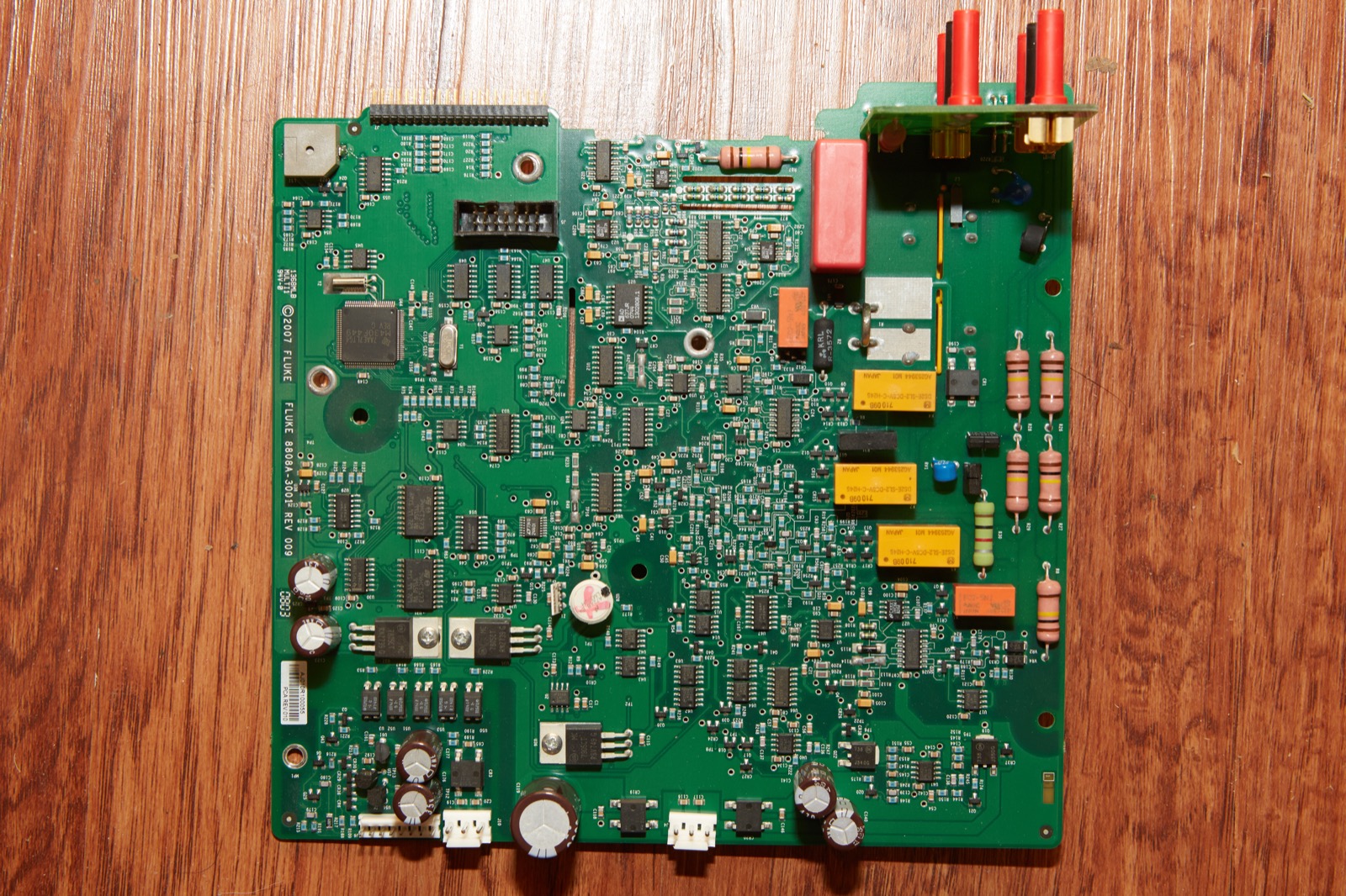

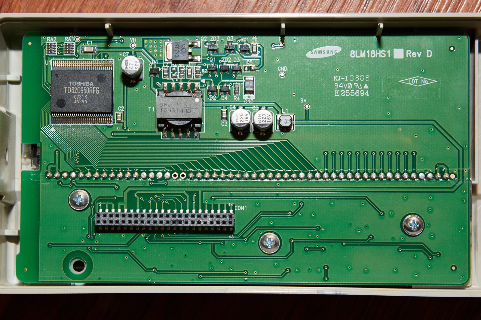

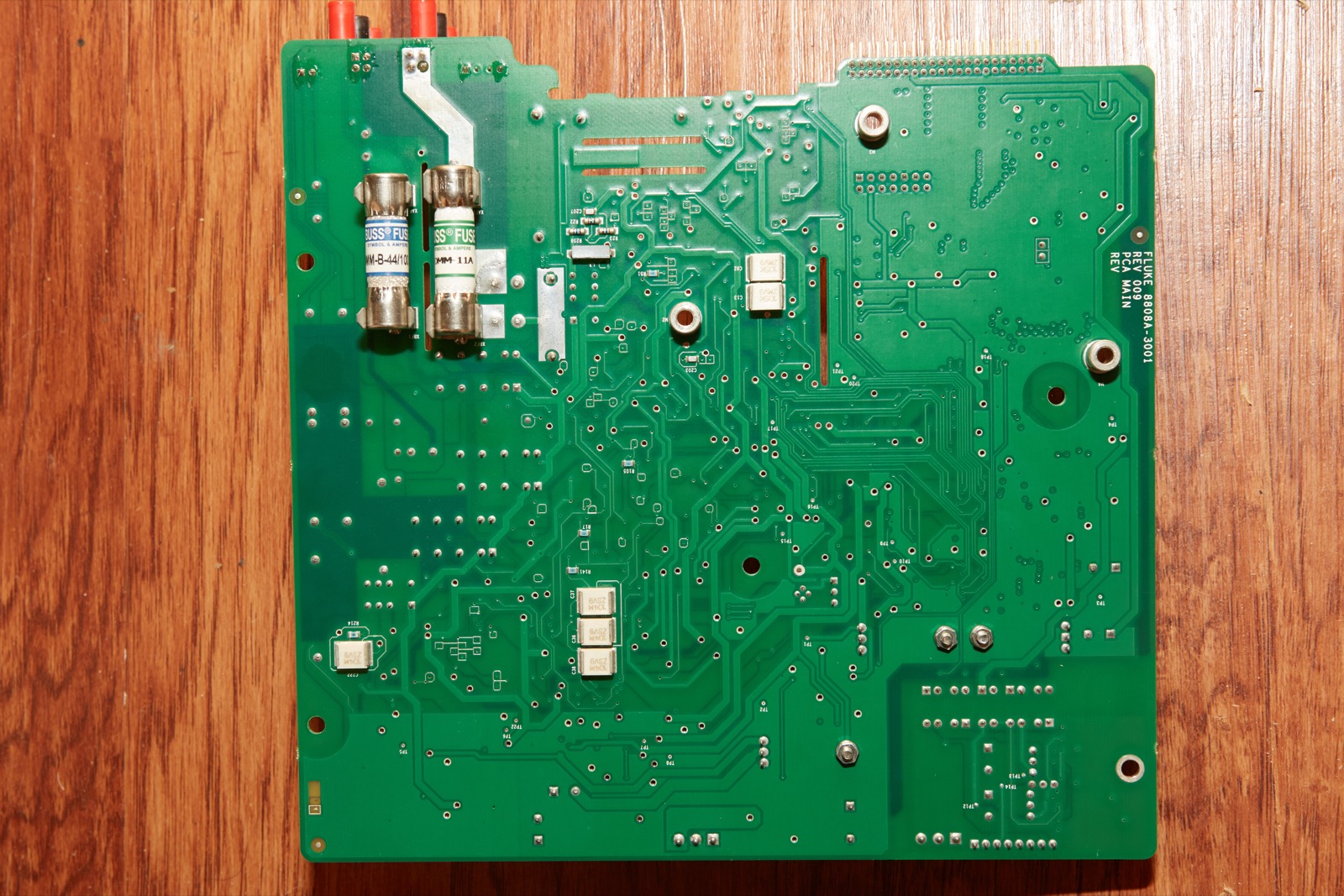

Got the shields off and took some detailed pics of the boards.

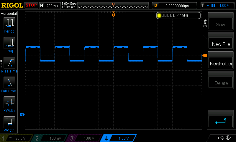

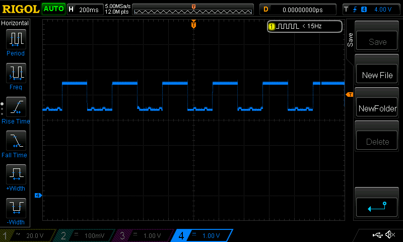

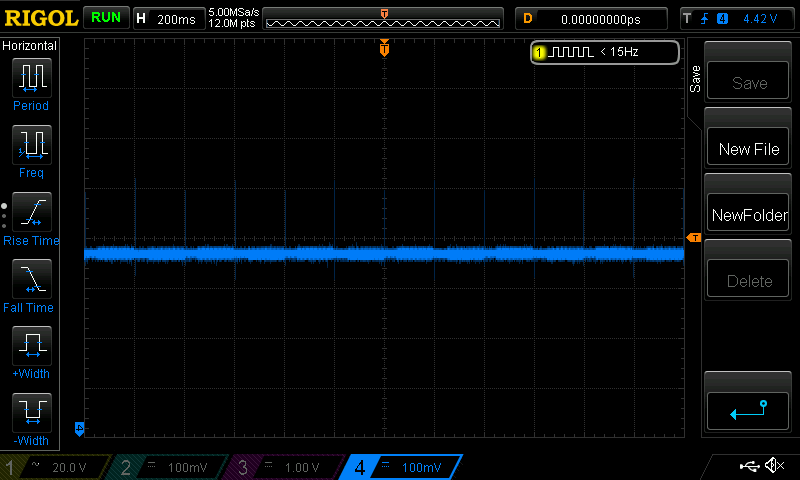

All of the readings with ~ in front of them are moving constantly. Here's the scope looking at 5.0VDC in on the outbound side of R28 (The first resister in the path). This behavior is on 200mV and 2V ranges only. As soon as the relay kicks in for 20V, the line is flat. This behavior is variable. If I reboot the 8808a it may only do it for some voltages. When this occurs, the inbound side of R28 is flat.

Since there is no service manual, I'm going make some guesstimates based on how other handheld Fluke meters works.
1) Most Flukes have a precision network resistor that acts as a voltage divider when the meter is in volts mode and as a reference resistor when in ohms mode.  This network is usually marked Z1.  On the 8808A, Z1 is next to the LM399 as this picture shows
https://doc.xdevs.com/doc/Fluke/8808A/photo/ourdev_634637W7XGTB.jpg
https://doc.xdevs.com/doc/Fluke/8808A/photo/Fluke-Vref.jpg
https://doc.xdevs.com/doc/Fluke/8808A/photo/DMM4020-PCB-Annotated.jpg
2) The precision network resistor, depending on the selected range, lets the voltage pass through or divides the input by 1/10, 1/100, 1/1000.  So if you are sourcing a 9.15VDC and assuming the 8808A full scale reading is 2V, I would expect to see 915mV on one of the pins of the precision network resistor.  The COM jack is ground.
3) If you see 915mV on one of these pins, that implies the analog portion of the meter is likely working.  If you see something like 800mV and the 8808A is showing 8.00V DC for a 9.15V battery, then there is something wrong with the analog part.
4) Since you mentioned the 8808A can be put into Fluke 45 mode, there is a service manual for the Fluke 45 and the theory of operation describes the above in more detail.
« Last Edit: January 10, 2016, 10:18:47 pm by retiredcaps »

Board looks like its only 2 layer - take some hi res pics of it with a light behind, always good to help deconstruction / reverse engineering.  :-+

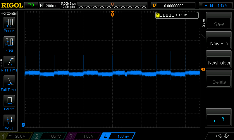

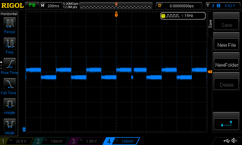

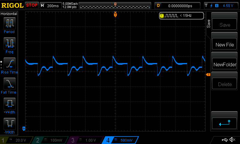

I took 10.00VDC in and measured all three pins on Z1 through all ranges on the meter. Here are the results:
Range           P1        P2        P3           8808a Display
200mV           ~4      ~1.3       ~-3              ~130mV
2V              ~4      ~1.3       ~-3              ~1.52V
20V             ~4.4    ~1.74      ~-2.45           5.0363V
200V            ~4.39   ~1.725     ~-2.45           9.041V
750V            ~4.386  ~1.720     ~-2.422          9.05V
P1 was *never* stable, though the differences get smaller as the range increases. Here are the scope traces. Note that at 200mV and 2V the vertical scale is 1V, while on the rest the scale is 100mV.
All at 10.00VDC in. Probe on P1 of Z1
200mV:
2V:
20V (note the smaller vertical scale)
200V
750V

Red: Unable to probe since the parts cover the connetions. Mine are different parts and are labeled TAIYO AG20 which are indeed spark gaps.
Can you measure the resistance of the spark gaps on the backside of the pcb?
0L on both.

I am a little late with this. I decided to record the analog switch address lines in DC and AC Volts modes similar to how Keithley did it in their service manuals. They are recorded in the attached spreadsheet. All readings are 5V logic except U60, which appears to use 3.3V logic on pin 9.
Hmm... I set out to test all of these. Every pin 9/10 I tested from the spreadsheet in 200mV is doing something like this, though this is not from this test. The range of the fluctuations got smaller as I stepped up the 8808a's range just like it did on the Z1 tests.
I set out to test the power supply and managed to have a probe slip and blew the AC fuse. More testing will have to wait until I can score another. My home office is all torn apart and I can't find anything so I'll have to go buy another if I can't source one close in value from something else.
