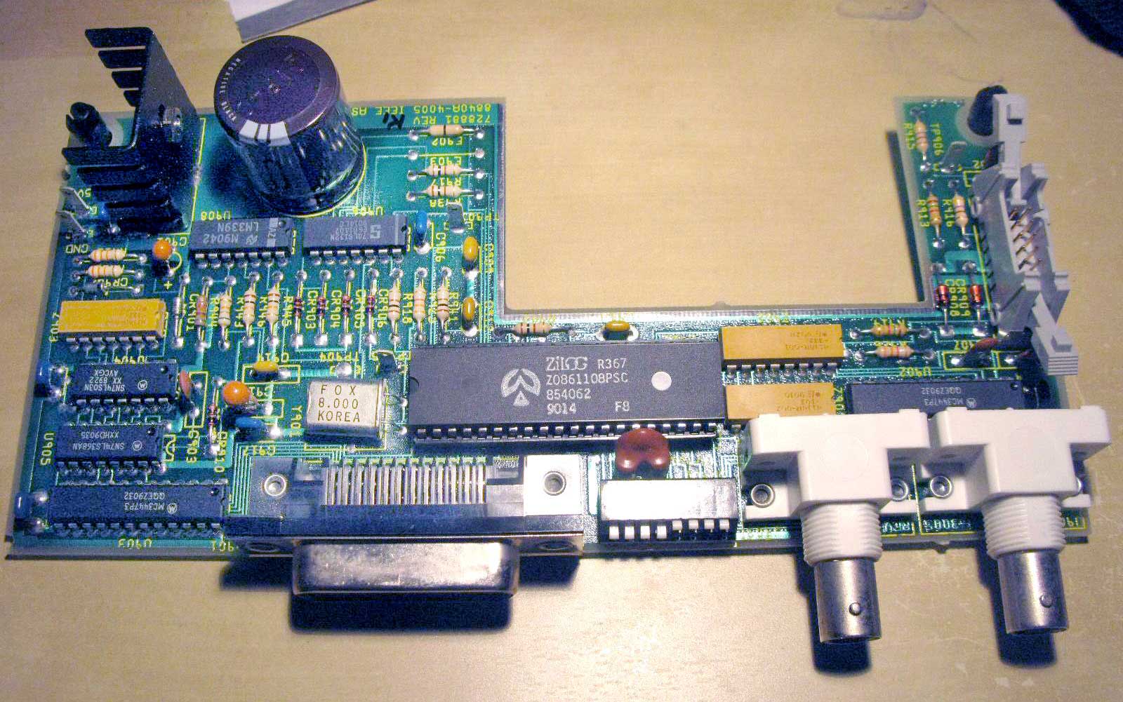

This is how my early GPIB card looks like:
One sees at first glance that this is ancient electronics :).  A Zilog Z8 with piggy-backed ROM!

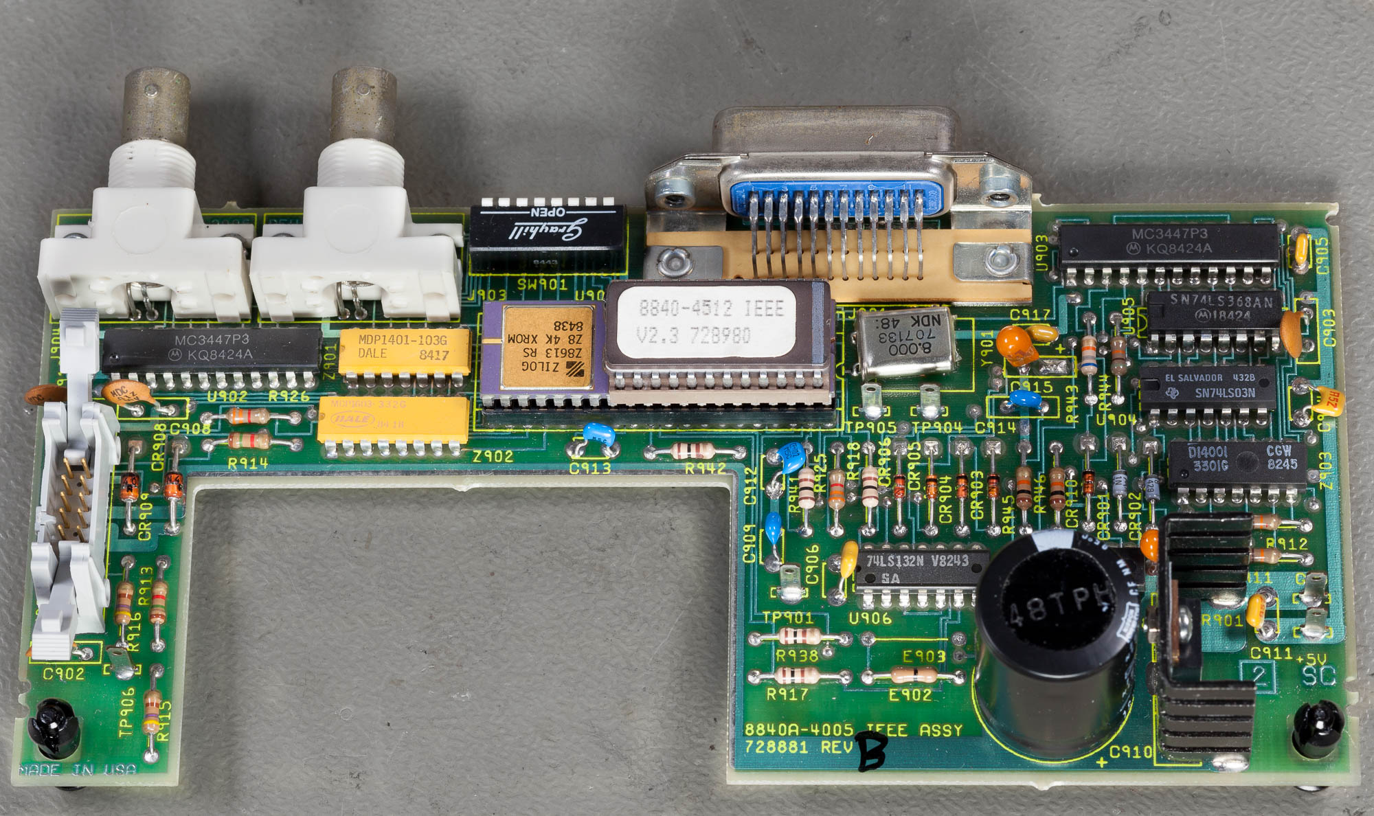

Around 1990 an identification command was added to the GPIB command set, the "G8" command. Those later version GPIB cards are looking a lot more modern too:
So, it depends on the version of your 8840A GPIB card whether it will reply to a "G8" command.
It is easy to test: just send G8. If the card is too old, it will return "ERROR-Code 71", as you found out :). If the card supports the "G8" command, it will return something like "FLUKE, 8840A, 0, V4.0".
You can find detailed info on all the different 8840A GPIB board versions in this post: Fluke 8840A/AF GPIB board.
