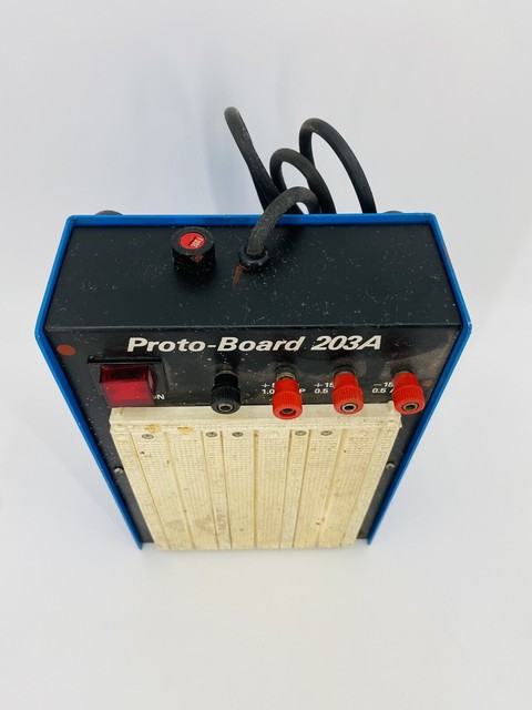

I bought a powered breadboard from the USA hoping it would have a split primary so I could convert it to run on UK mains.
My gamble didn't pay off and I didn't realise a transformer with 15v 15v and 9V outputs would be hard to find.
Question to UK based folk - can I get a transformer made here - I know it's possible but no idea of the cost for a one off.
Has anyone got such a transformer for sale with enough VA to give me after regulation 2 x 15v  @ 500mA and  5V @ 1A
Squeezing separate ones in to the space for the 15,15v and the 9V looks too tight.
I did send an email to Global Specialties but didn't hear back.
Last resort is to use a smps but would prefer not to.
The breadboard wasn't such a bargain after paying £50 postage but still much cheaper than buying a new one here though the fact it doesn't work here is a slight disadvantage!

I found a used Smart 2 step down transformer unit and fitted a three core mains plug on the breadboard in place of the two pin plug.
I find it strange how anything with a metal case could have been wired lacking a  protective earth.

Are you sure it’s genuine??
On the Global Specialties website, it is shown as having a 3-pin IEC input and a voltage selector switch: https://www.globalspecialties.com/product/PB-203A
What is odd, though, is that the manual lists only 115V input. Maybe they have different versions?
(FYI, it is common to have metal housings and no ground. It just requires all hazardous voltages to be double-insulated. It’s common on consumer AV gear.)

I think this model is quite old and has gone through several revisions over the years.  I've got a very similar board from the same company (same size and probably the same model number, can't remember offhand) and I think it's from the 1990's...  Mine has an attached power cord and no voltage selection and looks very much like this one I found on eBay but the framework is all black painted on mine...
