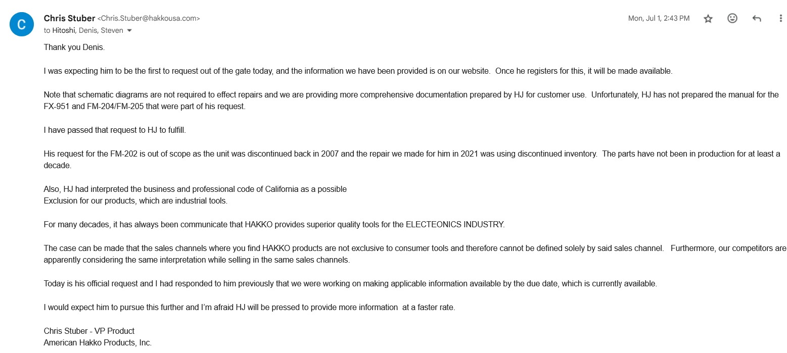

I believe I have Chris Stuber (On Audio) saying they do board level repair and have schematics and firmware for their use no time right now to sort thru the recordings.
This e-mail here shows their intent to not comply.
Also the section they are trying to use exempt themselves in the Business and Professions Code - BPC. Pertains to ATV's, Farm Equipment, Machinery. a Heavy debated during the legislative sessions I watched them all.
I interpret the law’s wording as meaning that a manufacturer has to provide the same documentation as they provide their own service technicians and to authorized technicians for the purposes of repairs, but not internal documentation that isn’t provided for the purposes of repairs. (E.G. engineering documentation.)
If Hakko is giving its own technicians additional documentation like schematics and firmware to do component-level repairs, but withholding that from others, then they’d clearly be in violation of the law. If their own technicians perform component-level repairs but do so without special documentation, that might be OK.
