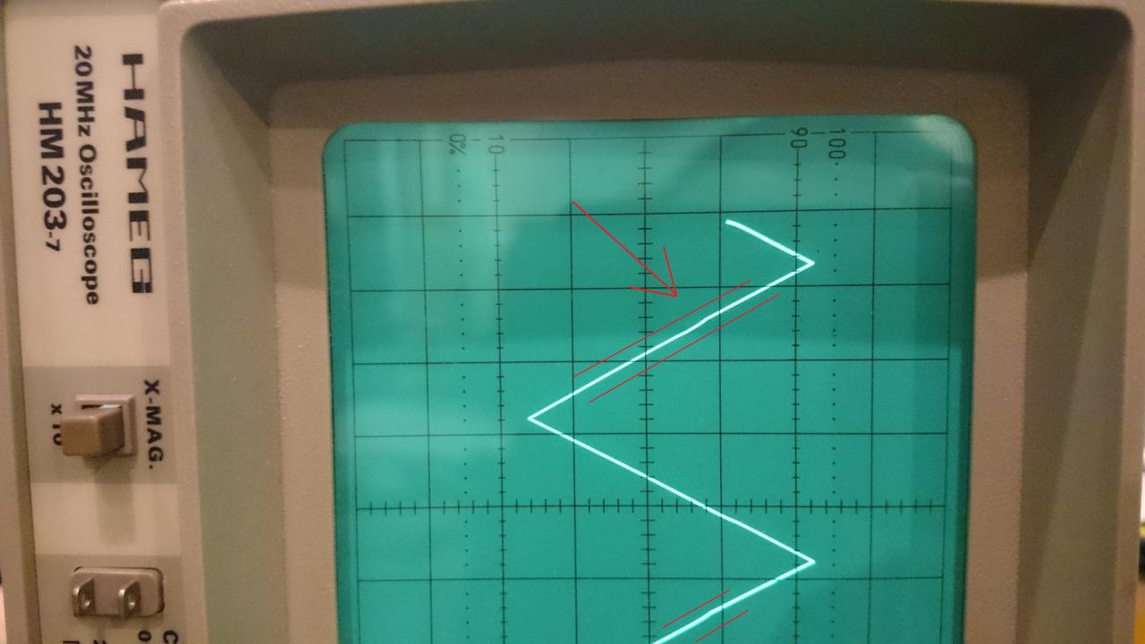

I have a really nice Hameg scope 203-7 (20Mhz) on the bench that I have cleaned up. After fixing the dreaded VAR knobs and checking some solder points and calibrating the Y-Gain, I suddenly have a slightly deformed problem in every second half of the wave.
 You can notice it the most in a saw waveform. I think that this could be calibrated, I have the service manual but don't have a clue where to begin.
Go easy on me, this is my first scope that I am restoring (and my first post).
Here is a picture that shows the problem. If a kind soul knows what I could do, please share the knowledge.

« Reply #1 on: October 05, 2020, 07:26:42 pm »
The HM203-7 should still be an old school analog scope. So there is no calibration or such for corrections.
A first point would be to check how the error changes when die curve is shifted up / down and also changing the channel.
I see mainly 4 possible sources for the error:
1) A problem with the generator
2) A cross over error with the output amplifier to drive the tube (so same error for both channels)
3) The input amplifier  (could be different for the 2 channels), would likely change with continuous variable gain.
4) Coupling from the trigger signal to the displayed signal. (could change with trigger settings)

I actually just got rid of it and I don't exactly know how.
I re-adjusted the Y-gain of both channels once more and it just disappeared :-+
This is the situation now, definetly a lot better than before. The sine wave looks as it should be! :-+

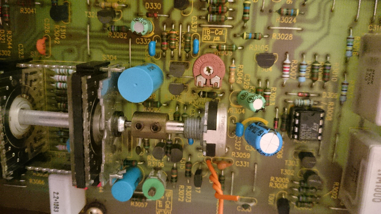

I was looking around on the PCB, it should be trimpot VR303, I guess that this is the trimmer I have to adjust?
Thanks for the help guys!

« Reply #5 on: October 07, 2020, 05:56:33 pm »
Yes, but only if timebase is out of calibration on the low timebase settings.
If also off on the higher ones start with the horizontal amplitude adjustment.

« Reply #6 on: October 07, 2020, 09:26:45 pm »
A total succes! Timebase correctly calibrated. ^-^
