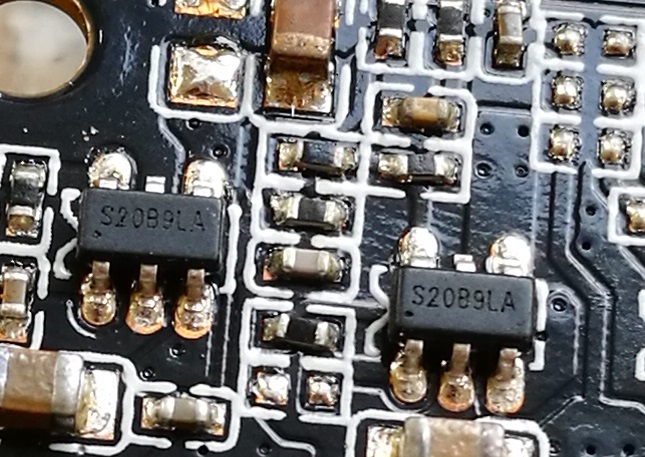

Offline meauummels
Re: Heed help identifying IC
« Reply #6 on: February 25, 2020, 06:21:30 pm »
Sorry ik can't help u , but im im searching for a component 2 from androidbox ik think ist a voltage regulator
 i hope anyone knows
You'll need to post more information.   This doesn't look like a voltage regulator.  I'd guess an opamp except that it appears that the right hand side two pins are likely tied to vcc/ground, and that isn't a common pinout for a 5 pin opamp.
Do you know what this part of the board is likely doing?

« Reply #8 on: February 26, 2020, 01:27:53 am »
Dunno if you have realized that but there is corrosion on PCB, including on pads of this component. Seems like liquid damage. And corrosion easily causes current leakage or even short circuit.
I'm assuming you're talking about the second poster's pictures.
I don't definitively see corrosion, other than perhaps on the caps near the top (hard to tell, but I agree it does look somewhat corroded/tarnished).  I also see what looks like an ENIG  board where the solder didn't completely cover the ENIG pads.  But the picture is bad enough that I can't tell for sure.
