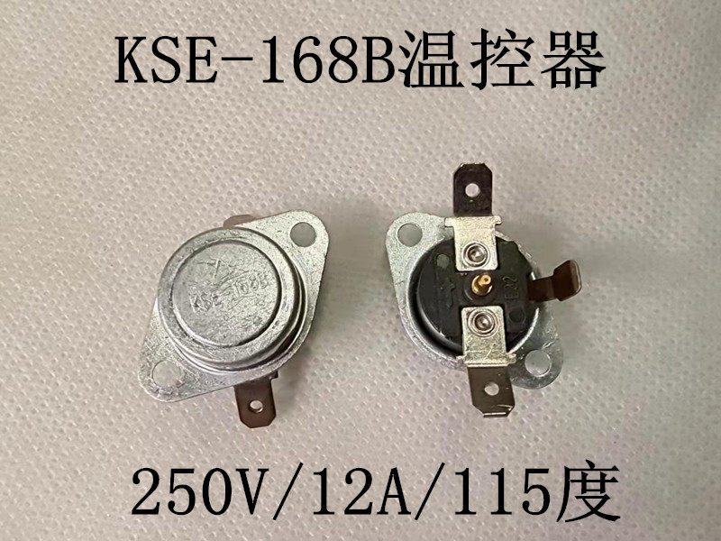

I have a thermostatic switch which I need to identify the temperature for but unsure which value to use.
These are the markings on the unit:
 KSE-168C
12A250V~210C RS 2
I need help to ensure I pick the correct cut off temperature 168/210.
It’s a safety mechanism so I’d like some support.
Thanks
Tinkerer’

The 210C might mean 210 degrees Centigrade? :-//

This was my problem is it 168C or 210C
Personally more inclined to 210 degree C since it’s written following the voltage and amperage
Tinkerer’

You can match the A logo and then trace the manufacturer and datasheet.
Temperature trip rating is on the collar 210°C.. It has a manual reset pushbutton pin.

« Reply #5 on: October 06, 2022, 07:27:28 pm »
"168" is obviously the part number. That's why I highlighted the "B" in "168B".

« Reply #6 on: October 06, 2022, 07:50:30 pm »
I found this part with the same logo:
https://www.indiamart.com/proddetail/ramcon-ksd-thermal-cutout-thermostat-20725050833.html
https://5.imimg.com/data5/SELLER/Default/2020/9/SJ/TE/SI/4360251/ksd-thermal-cutout-thermostat.jpeg
It purports to be manufactured by Ramcon, but the logo doesn't appear to be theirs.
Some thermostats have a "CQC" logo, but that's probably a certification mark:
https://www.cqc.com.cn/www/english/aboutcqc/
Edit:
The "A" logo is the certification symbol for TUVRheinland:
https://www.tuv.com/australia/en/
« Last Edit: October 06, 2022, 08:04:13 pm by fzabkar »

Any chance you guys can help find a 210 degree one rated for 12A. I’ve found many 10A ones available in the UK.
I’m after an automatic reset one, upgrade to no longer require the manual switch

Changing the operation from manual reset to auto-reset changes the safety properties of the appliance.
It's supposed to overheat and trip once, and go to the the repair shop.
If it's regularly overheating, there is something else wrong - airflow etc.

On this occasion I’m modifying it since the encloser has a 20cm gap to where the switch is located (therefore a plastic rod used to push the button which is lost - not that it trips consistently).
I don’t feel comfortable gluing a rod  to the switch to account for the gap only for it to get lost (again)

What is it for?
How much current does the actual load draw? Is it more than 10 amps? You could use a lower current thermostat to control a relay in a pinch.

It’s a commercial desktop oven
Honestly, I would not tinker around with stuff commercially used, especially if it is safety related.
Ask the manufacturer for a spare part, pay 20x the Aliexpress price, but feel yourself on the safe side, when insurance claims arise. (Probably not fun, when the commercial oven overheats due to a failing Aliexpress part and burns down a company.)
