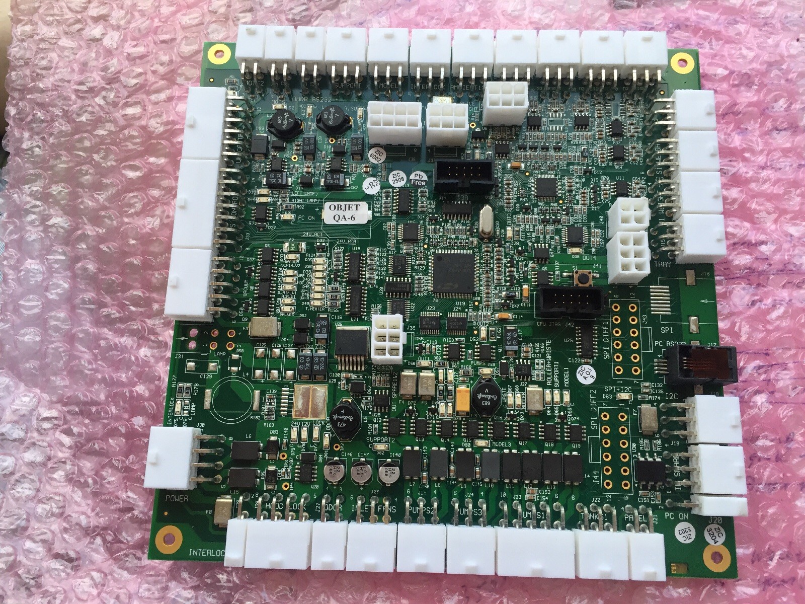

We are trying to identify a fried component on a system board for our Objet Eden 250 3D printer. Can anyone tell me what the component might be? It looks like there's some similar components on other areas of the board, but I have no way of knowing if this one is the same.
Here's a similar board on eBay for reference:
Also, what's the best way for us to clean up said board prior to soldering on the replacement component?
Thanks in advance for the assistance!

Probably a tantalum capacitor as a filter for that switching regulator. Unfortunatly, it has exploded, erasing its value, you'll need a schematic to find what it was. Also, are those LEDs still on?! You should always remove power if a component explodes to prevent further damage. :-BROKE
Rubbing alcohol should get it of the soot, hopefully the board itself isn't burnt.

Probably a tantalum capacitor as a filter for that switching regulator. Unfortunatly, it has exploded, erasing its value, you'll need a schematic to find what it was. Also, is that LED still on?! You should always remove power if a component explodes to prevent further damage. :-BROKE
The reason that the LEDs are still on is that we still actively use this printer... Oddly enough it seems to work ok without that component! That said, we'd like to fix it ASAP.

Looks to me an input cap of a buck converter. So what's the input voltage of that board? You can get this number by measuring the 6 pin header next to the blown cap.
Then multiply by 3, say, you have a 12V input, then you need a 35V replacement cap. Get the highest capacitance you can find that will fit. It looks like a 7343 (metric) size to me.
What are the potential risks associated with choosing the wrong capacitance?

Ok, check this out! Got a picture from one of the eBay sellers. I think these are the markings:
R+
686
25k
534
What do you make of it?
Any idea why our machine could be still operating with it fried?
Is there a more robust component to safely replace it with that will be less likely to fry again?

K is 10% accuracy, 25 is 25V, 686 is 68*10^6*10pF=68uF.
534 is probably date code, 2005 or 2015, week 34.
R+ is manufacturer product series, I have no idea which that is.
Looks like it's a KEMET branded component.
Here's the KEMET PDF: https://content.kemet.com/datasheets/KEM_T2009_T495.pdf.
I'm not sure what might be a more robust option to replace the existing component with. Any ideas?

I did a bit more research, it seems like R+ denoted T495 series of surge robust tantalum caps, how ironic.
Therefore, I would just either replace with same part number and hope I won't get another bad so called surge robust cap, or I will just bodge a leaded aluminum cap.
I'm not sure what might be a more robust option to replace the existing component with. Is it safe to replace it with a more robust leaded aluminum cap? For example, I'm really not familiar with component form-factors, so I have no idea what might even physically fit. I guess I should probably choose a component with a higher voltage rating, correct?

Here's the part number: T495X686K025ATE200, there are also 125mR and 150mR versions, but I prefer a higher ESR to reduce inrush current.
This is a perfect example of higher grade (lower ESR) is not always better. I bet the 200mR version works better.
So, would the T495X686K025ATE125 be safer, as it has a higher Max Inrush Ripple Current (1149 vs 908 @25c and 1034 vs 817 @85c)? Is there anything else to consider? Or should I switch to a Leaded Aluminum cap? Or try to move up to 35v cap?

There are aluminum or tantalum polymer caps that don't explode easily, but those have very low ESR. There is a risk that this behavior may cause inrush damage to your power supply or mess around with its control loop, so I would not recommend to replace them with a capacitor with stupidly low ESR, somewhere around a few mR. Those are good for output filtering capacitors (providing the SMPS designer knows what he is doing), not that good for input capacitors, especially not for board level input capacitors.
However, non polymer aluminum caps are never in such footprint, those 7343 package is for tantalum solid (MnO2) and tantalum/aluminum polymer capacitors only, you will never find a wet aluminum capacitor in such a size. Therefore, if you want to go for a wet capacitor, you need to bodge one instead of looking for a perfect fit. It won't happen.
It's worth noting that the power supply powering this costs ~$13k to replace... So I definitely want to avoid that drama.

The size code is X, because D is much thinner, X is taller. This rules out T495D686025AE200. As for the other ones, I have no idea, but I think you should use a higher ESR one, so I picked the 200mR version for you.
Got it. That makes sense. Thank you for all the help!!!
Also, is there anything I should check to make sure there's not something else causing this that will make it fry again? Or do I just need to slap it in there and see how it does?

If it blows up again, report to Stratasys as this can be a serious design flaw, and replace that with a 35V one or just leave it open. If it works fine, then that's great.
Thanks again! You were extremely helpful!!! I'm buying the T495X686K025ATE200 and I'll let you know if there's any fireworks. Ha
