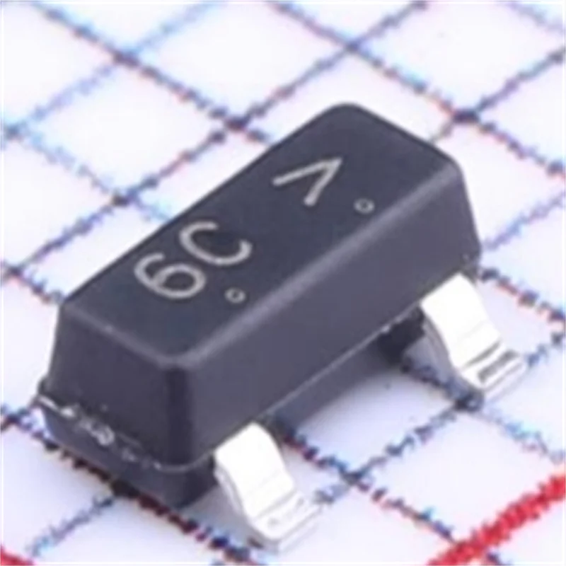

I'm trying to figure out what these are. They are on a Fluke 175. I'm thinking they might be BC817's going by the 6B marking, but the > after is throwing me off. I can't seem to find a 6B> Thanks guys.

The > maybe just a manufacturers mark.
I think BC817 and the post below may assist you.

I think "6B>" is an LBC817-25LT1G (= BC817-25).
Here is a listing for an LBC817-40LT1G ("6C>"):
https://www.aliexpress.com/item/1005006444969128.html
https://ae-pic-a1.aliexpress-media.com/kf/S487a58780da445fda3ccd467977213d55.jpg
(photo of LBC817-40LT1G)
https://datasheet.datasheetarchive.com/originals/library/Datasheets-SW12/DSASW00231749.pdf
(page 123)
