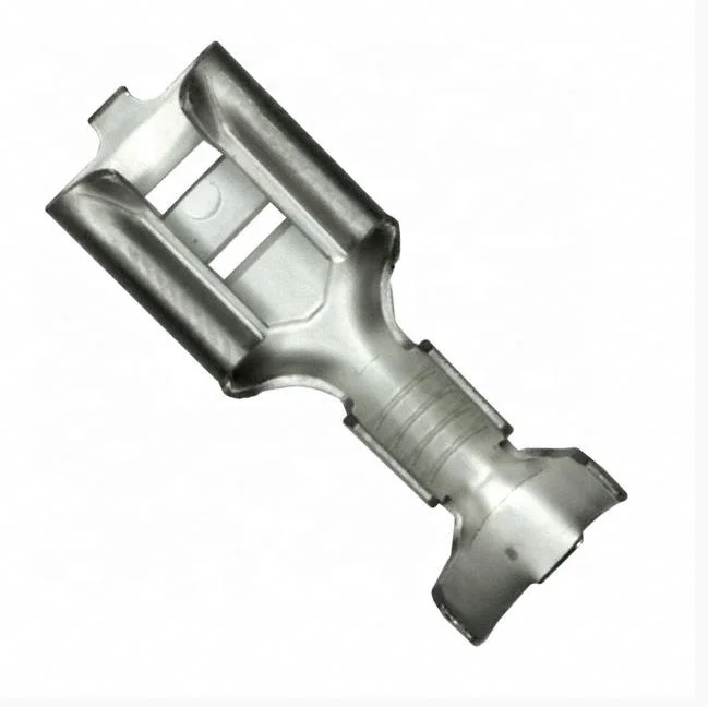

Hi guys, I am in the middle of rewiring an espresso machine. I couldn't find the exact matching types for the following cable connectors. I couldn't find the proper names for these as well, maybe different manufacturers are using different names.
The dimension of this connector is 6.3mm x 2mm (front side) and 20mm long. Uninsulated, the cover also looks different from what I normally see and some of the connectors use a black cover.
Hope you could shed some light on it.  I'll include the other connectors in next post.

Usual FASTON connectors.
I also thought so too, but couldn't find this kind of locking type. Also if I search for 'spade' connectors similar type of connectors are shown  |O

« Reply #6 on: February 21, 2021, 02:11:37 pm »
FASTON come in non-locking and locking types. Despite locking mechanism may be looking different from different suppliers, they are completely interchangeable. Also what looks as non locking, still has a bump for locking in place. It's just that in locking type you must release the lock before removal.

« Reply #8 on: February 21, 2021, 07:46:01 pm »
As others said it's a faston...
I recently helped a friend of mine with the expresso machine repair.
Be aware that all the wires that are connected to or near to heat sources (heater), should be suitable for high temperatures and so the connectors. Do not use regular Cu-Sn fastons for the heater, they will burn out pretty soon...
We used a silicon insulated wire, rated for 180°C and Nickel coated steel fastons for connections. I got them from Farnell.
Whenever you meet a connection to the hot part of the heater, allways use appropiate high temp. cable lugs or fastons and use stainless steeel bolts/washers/nuts. Never use regular zinc plated nuts and/or Sn coated cable lugs!
