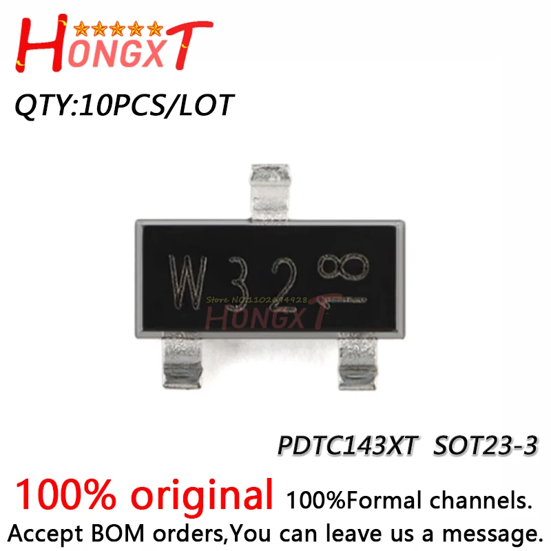

Sorry, I just had another look at your photos. I missed it the first time, but is the damaged part the one with a circuit reference of D20? If so, then that is a diode. If this diode is connected across the relay coil, then it is a snubber, in which case reverse polarity would certainly kill it.
The "W32" part is a PDTC143XT NPN resistor-equipped transistor by Nexperia:
https://assets.nexperia.com/documents/data-sheet/PDTC143X_SER.pdf (datasheet)
https://ae01.alicdn.com/kf/Sc61e5d686652477996866e278dc25205k/10PCS-100-New-PDTC143XT-W32-T32-SOT23-3-Chipset.jpg (photo)
The marking style of the diode is similar, so I expect it is also a Nexperia diode. This diode would only need to be a standard silicon rectifer, probably 100V, 1A or less.
A BAW56 dual diode (marking A1W) could fit the bill. <-- No, this a common anode pair.
