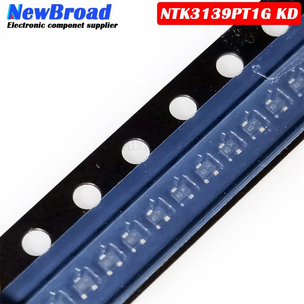

If it helps, "KD + Y" appears to be an NTK3139PT1G P-ch MOSFET.
https://www.onsemi.com/pdf/datasheet/ntk3139p-d.pdf
https://ae01.alicdn.com/kf/He1282cbb1207433d943f99f5d1c75bd5v/Diodo-de-protecci-n-antiest-tica-nuevo-y-Original-NTK3139PT1G-KD-SOT723-20V-750mA-MOS-FET.jpg
Logged

Re: Help to identify 8 pin IC
Reply #8 on:
December 13, 2023, 10:32:50 pm »
This is 3 pin.
One from picture is 6 pin
here are the readings both diode and ohms
Logged
fzabkar
Super Contributor
Posts: 2735
Country:
Reply #9 on:
December 13, 2023, 10:41:37 pm »
Pins 2 and 3 look like Ground and Vcc, respectively. If so, then that would invalidate my previous guess.
Last Edit: December 13, 2023, 10:43:54 pm by fzabkar
