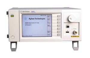

I have recently got opportunity to buy an Agilent N9360A Mobile Station Tester for a very cheap price. It's a very specific device, intended to simulate or test GSMs and related protocols.
I don't have direct usage for it, so I do not forcibly want to repair it, but at least I would be really happy if I could reuse some of its parts, like the 10MHz reference.
https://www.keysight.com/us/en/product/N9360A/mobile-station-tester.html
The device is faulty, the stand by LED comes on, but when I press the start button, the front LED color changes (from orange to green), and if I look very closely to the LCD screen with a light source, I can see some random black lines (and no backlight). But nothing else happen : HDD not spinning, Fan not spinning, no sound...
There's only another LED on inside of the device, it stays lighted only as long as I have the finger on Start button.
When I release the start button, the device goes back to Stand By.
