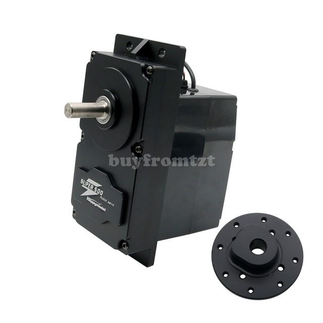

I've come here in despair. Here's the problem. I have bought one of these:
https://i.ebayimg.com/images/g/~JMAAOSwPVFcObXr/s-l640.jpg
This is for a little simple project. Worked fine when arrived, now it just moves side to side without stopping as soon as I power it up, even if not connected to a receiver.
How did it happen I hear you ask.
Well, I had to make another casing and in the process I took off the motor wires and reconnected them the wrong way around. I corrected my mistake after I first tried it and that is when the problem appeared. When tested with the wires crossed, the motor moved slowly at first for half a turn (the output shaft, that is) and then stopped dead. Upon inspection I found the mistake.
Some description of the circuit (keep in mind I am at best a dilettante).
Here's a picture of the top side of the board:
https://www.hobbyporter.com/u_file/1812/photo/36c3a9090f.jpg
I had to bridge the VR pads in the bottom left for I am using a digital remote control.
The motor is just a run of the mill DC motor. It has some bidirectional diodes on the terminals to cut EMF spikes and is driven by a bridge with four N channel Hexfets (Infineon LR2705). These seem to test fine (in circuit; I don't really want to pull them out for fear of further trouble, but I did order a bunch of new ones from RS Components). Now the test is not that reliable, I could only test the Drain-Source resistance which seems suitably high and the S-D diode, which shows about .5V. Not sure if I can test anything else in circuit.
The position sensor in this servo seems to be some sort of magnetic sensor (doesn't use a VR). Now if I take the board out and away from the bottom of the output shaft, which has a magnet stuck to it, the motor just keeps going around.
The two adjusting controls/VRs (blue, bottom in the picture) still seem to do their job, in that they adjust the travel and response speed, and I know that because shortening the travel makes the servo move quicker because it gets quicker to the end of travel (again, keep in mind I have no receiver connected so there is no signal) and so does the response speed. Connecting it to a receiver doesn't make any difference.
The only difference is when I have the servo connected to a receiver and I apply a command for the other channel (I use a two channel radio and I have another "normal" servo connected to the other channel) and move it to its max travel and hold it there the big servo stops doing anything, which I take it is a sign the voltage drops (the other servo drains a lot of current).
Also, when I apply power the first time, it takes say one-two seconds before the defected servo starts doing its thing. Could be a capacitor charging?
All these tests are done with a good NiCD at 14.4V (the large servo has a 5V out for the receiver). At 7.2V, the servo doesn't move (needs at least 12V).
Ideas?

I mean there is no physical space on the board to remove the magnetic sensor and put a VR connected to the output shaft. Connecting it in circuit would be another problem above my pay grade, but I would happily blunder my way through that if it looked like I had a chance in hell.
I think you hit another nail on the head with the direction of movement. Yesterday night (late) I was trying to test the servo every which way I could and realised that the motor does not spin the output shaft in the direction it is going to find the endpoint.
Let me explain.
When you move the stick say left, the servo (output shaft) should turn around left, go as far as you command and stop. Well, what I did was to again take a gear out of the g'box, turn the steering wheel all the way and watch what happened. The servo motor starts spinning when you apply command, so I spun the output by hand in the corresponding direction (I followed which way the gears rotate) trying to find how far it goes before the motor stops at travel endpoint. Well, there isn't an endpoint! I could spin the output 180 degrees to the point where it starts getting confused and twitches. However, if I spun the output the other way to what the gears would do, I found the endpoint! So I found the point where the motor stopped by itself as if it had reached the travel endpoint requested by my command. And this is consistent both ways. Flippin' 'eck!
I then started wondering if the motor had been wired correctly and checked the polarities indicated on the board and motor can end. And yes, everything is as per instructions. I even checked the motor can (there is a small PCB soldered on the motor terminals directly with filter capacitors and bidirectional diodes so I looked at the tabs bent over to close the can on the outside, the negative one has a locating slot for the plastic endcap/brush carrier indexing, see endbell picture in the link below), thinking maybe they put the motor the wrong way around, and no, it's all correct.
https://www.foneacc-motion.com/Uploads/5baaf0c411964.jpg
Red dot marks +, check out the tabs near the negative and no tabs near the positive; that is what I could see on mine without taking the little PCB off its terminals.
So right now my thinking is, if I reverse motor polarity, it should spin the way that will send the output shaft the correct way around to find the travel endpoint. Considering this was my first "mistake" I am a little bit reluctant to do it again so bear with me while I build up the courage to try.
Not sure what can happen, but from experience with brushed motors, they have a little bit of timing added, that's why they are "polarised". Otherwise, I don't see any problem, reversing the motor wires that come off the board would only expose to reverse polarity the bidirectional diodes and the filtering capacitors (spike filtering). None of that matters, there should be no problem. The only difference is, if the motor does indeed have some timing added, it will spin in reverse slower than forward. Which it would have done anyway when connected as per the polarity indicated on the PCB.
If the motor doesn't have any timing (which is what I suspect, given I didn't notice any difference in its speed when cocking about with it), then the only consequence of reversing the polarity of the wires is that it will spin backwards to what the designer wanted. Which is apparently what I need!
I'll report back.
May the force be with me.
« Last Edit: November 16, 2019, 03:39:22 am by viorel »
Offline viorelTopic starter
  • Posts: 25
Re: Help with large servo please
« Reply #16 on: November 16, 2019, 04:43:38 am »
Well, it works.
It does show different speeds (so I take it the motor does have a little bit of timing) and it doesn't seem to travel equally left and right, but I'll take it for now.
Not the end of the process, I still have to put it in the car (it is a little electric car for toddlers) and see if it works to steer under load but thank you everybody for your input.
I have powered it until now out of two 7.2 NiCd packs (connected in series) which are known good packs capable of quite some grunt, but I still think the voltage might be on the low side for the motor to have full power/speed. The car has two SLA 12V batteries in series. Not as powerful (in terms of max amps) as my NiCds but they have the voltage. We'll see.
