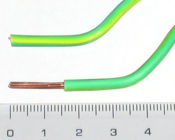

although less pretty, i usually bend up one end to use as a handle,
for down to about 15mil traces one can compfortably use a strand of copper out of 2.5mm earth wiring, if they have some about,
this stuff http://www.bitsen.com/images/medium/earth_cable_2.5mm_MED.jpg
also, being how commonly i have to replace tracks, i will say this, the tape method isn't useful if your break is less than 1.5cm long, generally if you tin the piece of copper, you can get it to act like an SMD part and self center,
