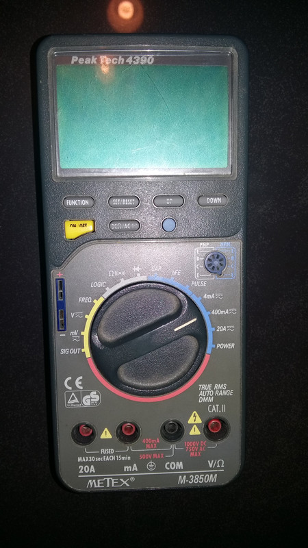

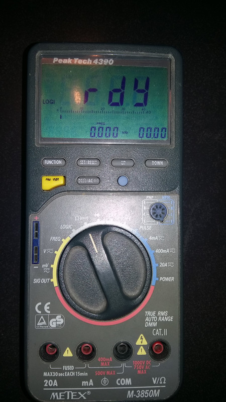

Hello Everyone.
Today I connected a charged capacitor to the instrument, after which I only have a message on the display.
Does anyone know how to get rid of the malfunction.
Thank you.

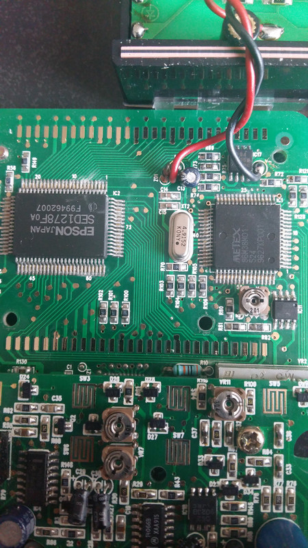

Probably the maxim MAX130CPL or the equivalent intersill 7106A has been overloaded due to the capacitor still having too much charge. This chip is mounted just underneath the LCD display.

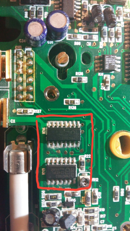

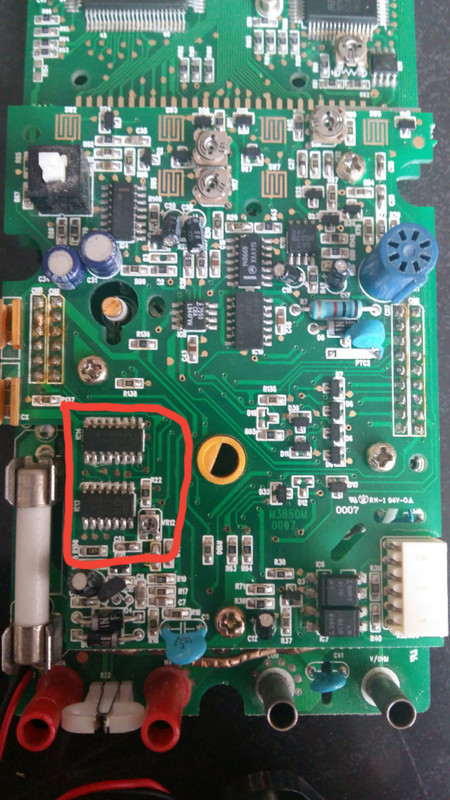

There is a different situation on this type than with me.
Is it possible that the marked elements in the images are damaged because they were first affected by a charged condenser?

Your version also has a service manual available
https://elektrotanya.com/metex_m3830_m3850.pdf/download.html
Are all ranges faulty, or just the capacitance range?
Logged
coromonadalix
Super Contributor
Posts: 6856
Country:
Re: How to repair metex M 3850 m
Reply #5 on:
February 23, 2019, 04:47:19 am »
same as Emo said
Start with each range / function check the 2 fuses too
chances ic4 may have busted and or the ic 5 too
