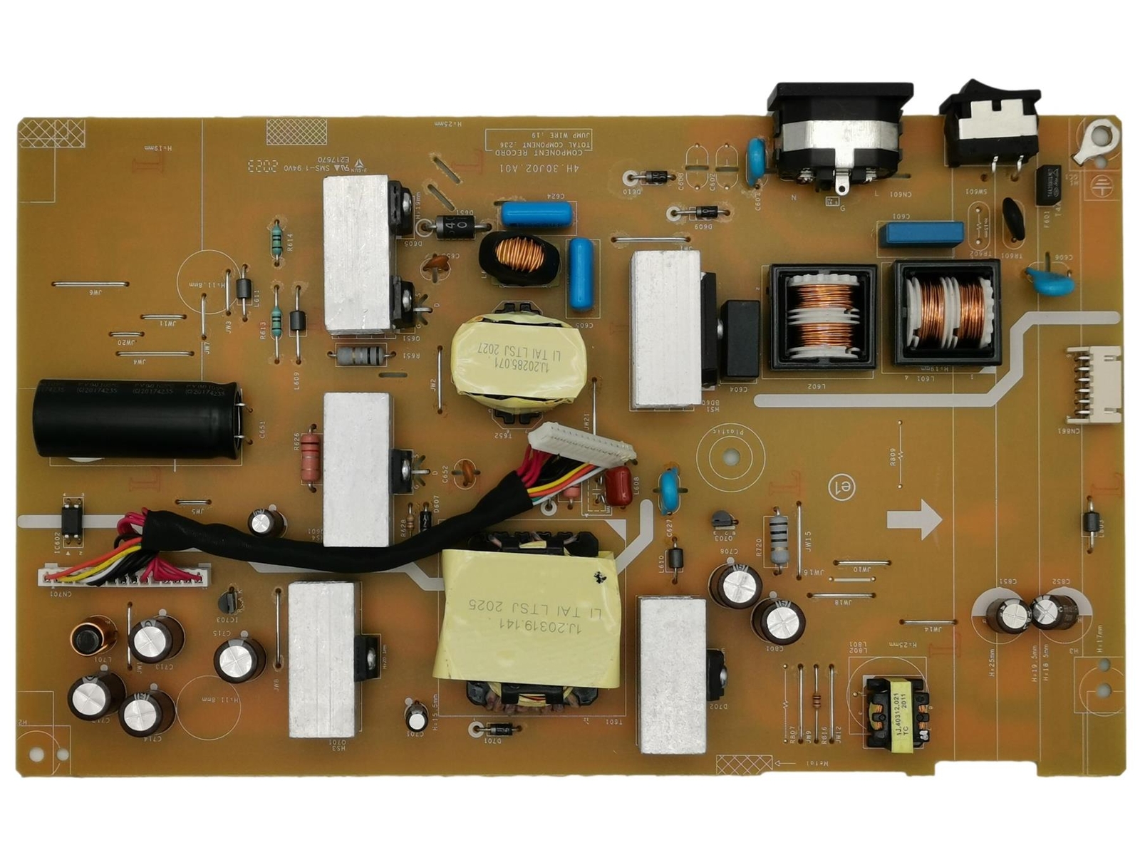

My Acer XB271HU (bmiprz) 27" 1440p IPS monitor failed to start yesterday morning, quite possibly due to the lightning storm the previous night.
It does seem somewhat unlikely to be caused by the storm as I was using it without issue until about 11pm, then powered down and pulled everything out of the wall when the storm got closer. I saw it work as usual maybe 15 seconds before pulling the cord. On the other hand, it's a hell of a coincidence that it's worked perfectly for two years and breaks when powered down for the night during a lightning storm!
Symptoms are that the power LED blinks blue, which AFAIK it should never do -- power save mode is amber. The soft power button doesn't do anything, so I can't turn it off. There's no image of any kind whatsoever, and the backlight seems to be always off, though I'm only 90% sure of that.
A friend with a very similar monitor (XB271HUA) says his turns on to a manufacturer logo, then says "no signal" and the LED goes amber, if nothing is plugged in. Mine simply blinks the power LED in blue and that's it. The soft power button on the front also does nothing, so I can't turn it off that way.
As I have no way to get it repaired (for a reasonable price), I figured I'd take a crack at it as I have some experience with electronics repair. There are also power supply PCBs for this exact model available from e.g. eBay, to fully replace the power supply.
Board images:
https://imgur.com/a/jT6rwA7 -- I recommend right clicking the images and opening in a new tab to see the full size.
Especially note the discoloration/bad solder joint at Q703, and the resistor next to it (R720).
The output connector (shown in the capacitor image) does produce 12.1 V between the magenta and black wired while powered; the other colored wires appear to be at 0 V relative to black.
There's also a big capacitor near what seems to be the output side (see images in the "bonus question" below), that was changed to something very high, IIRC 380 V and drained very slowly (1.5 hours or so until it was at a safe voltage of 15 V or so).
The main question is really this:
Based on the images and the fact that there *is* output voltage, do you think this PCB could be the only reason the monitor doesn't work, meaning it's relatively likely replacing it will make the monitor fully usable again?
Bonus question:
Is the weird discoloration around the transistor (on both sides of the board) likely to be a sign that it's dead (and likely by overvoltage)?
There is no such discoloration in the eBay images I found of this power supply:
https://i.ebayimg.com/images/g/URYAAOSwsCliqHPM/s-l1600.jpg
https://i.ebayimg.com/images/g/18YAAOSwPIdh7Wue/s-l1600.jpg
https://i.ebayimg.com/images/g/-2sAAOSwBGRiqHPM/s-l1600.jpg
If so, I'll most likely buy a replacement power supply PCB. I figure component-level repair is probably more trouble than it's worth, especially considering the risk that many components are damaged despite looking fine.

Do you have a soldering iron to resolder Q703?
Those 35V caps look a bit bulged as well. Anything you can test them with?

The discoloration would unlikely to be from lightning strike, that looks like heat from long term use. Maybe when you put it away it shook enough to break the solder joint.
Does the multimeter have a capacitance test? Its not as good as ESR meter but would be a quick check.

No matter if it looks good or not, do the basic tests like checking diodes with a multimeter to make sure they're not open or conducting in both directions.
The Q703 part ... that's long term heating of the PCB, it's not caused by lightning. You need to clean the pads with a soldering iron and apply new solder. The R720 is also producing a lot of heat, hence why it's positioned so high on its leads, to have airflow around it and not heat up the pcb as much... but it still conducts heat into the PCB.  The solder joints look bad, so I'd also remove the solder and apply new solder.
I'd replace at least the capacitor closest to Q703 even though it doesn't look swollen - it has been subjected for a long time to the heat from Q703 and R720 and also from the mosfet or transistor on that heatsink below it.  It's hurting.
And you'll also need to inspect all the solder joints of components around that part, but it doesn't take a lot of time to just resolder all components around that part.
The capacitors near that connector are degraded, they do seem swollen, those should be replaced.
You can discharge the big capacitor after tests by applying a resistor across its terminals ... try 470 ohm - 1 - 2 kOhm for 10-20 seconds across the leads. But don't use your fingers, hold the resistor by its body with some pliers or something.

Q703 has desoldered itself, it seems. Judging by other solder joints, it might have been crappy soldering in the first place, or it became too hot (not meeting current demand). I would exchange it, put a little heatsink on it (to be safe).
R should be fine, the caps are also not too close to the transistor, they should be fine (thermally). However they do look bulged and have probably (very likely) failed or are about to fail. Check other caps as well.
You should check all soldering joints close up. E.g. JW15 (bottom) and C708 (bottom) don't look too great. Might be just a viewing angle issue, but I'd just resolder odd looking joints.

I've gotten started. I think the transistor is dead -- my transistor knowledge is extremely rusty but these values don't make sense, right?
I'm using the multimeter in diode mode and checking various combinations.
The results are:
+ on base, - on emitter: OL
+ on base, - on collector: 0.72 V
- on base, + on emitter: OL
- on base, + on collector: 1.60 V
Assuming it's dead, any ideas how to find a replacement?
It's marked K946 / C200 / Y (three lines).
The bulging caps are probably also dead, as the multimeter jumps between 15 uF and OL 1-2 times a second. I've only tested one so far though.
The cap closest to the transistor is likely fine as it reads as almost exactly 330 uF and looks fine.
Edit: All but one of the bulging caps give crap readings. I'll replace all of them anyway of course, assuming I can find a transistor replacement as well.

It's probably 2SK946 ... but I'd suggest desoldering it and testing it again out of the pcb.
Go on Youtube and look for mosfet testing using multimeter, to see how to properly test mosfets.

The casing does not match for 2SK946; try 2SC200 instead.

KTC200
Y:hfe 120..240

https://www.el-component.com/bipolar-transistors/2sc200
The KTC200 is the same as 2SC200, just in case it's confusing. The hfe comes in different classes, "Y" is required.

Uhhhh.... I checked the output with the oscilloscope now as I figured it might look bad -- and it looks... far worse than I expected.
In case the image doesn't work: there's a TON of ringing with Vmax = 52.8 V, Vmin = -39.2 V (Vpp 92 V). The average and RMS are around 11-13 V, which is what the multimeter shows...
Is there even any point in trying to repair this? Could the capacitors and everything else in the supply have survived this?
To be clear, this is in the current state, without the transistor. Which might have been a very bad idea, but the average output voltage was the same WITH the transistor as it is now, so I would guess that the waveform was the same before I touched the supply PCB at all.
There's also the question if the output looked like this while it was connected to the rest of the monitor, in which case that too might have taken damage.

what output.. sec.winding.. linreg.. rectifier
broken rectifier would lead to MOSFET failure due to capacitance loading
Offline exscapeTopic starter
  • Posts: 43
Re: Is this monitor PSU fried? (Acer XB271HU, possible lightning damage)
« Reply #22 on: August 31, 2022, 04:12:24 pm »
I measured at the connector that goes to the rest of the monitor, so the output of the power supply. 12 V, 19 V or whatever it's actually supposed to be. I figured 12 since I measured 12.1 V with the multimeter, but I now realize that was probably entirely meaningless.
The ground lead was on a heatsink that had <0.1 ohms to the connector's ground pins, because it was so much easier and safer to place it there. It doesn't stick to the ground pins of the connector.

R709 38,3k
R710 10,0k
19V
dried output caps = this ringing
