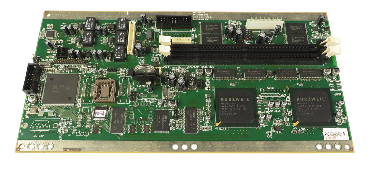

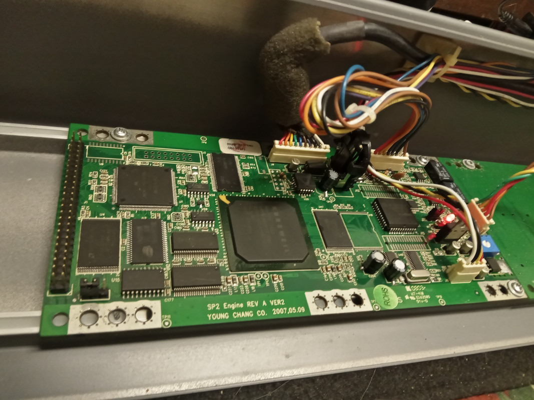

Hi Folks, here with a question about firmware recovery. I have a strange issue with a Kurzweil SP2X digital piano. The main question is how to connect a TL866 programmer to flash the mainboard soldered TSOP48 Eeprom chip using the 50 pins connect_boot on schematics.
The equipment is a dead non working unit that came years ago for repair from other service center. Unfortunately the DSP unit is partially damaged with random issues caused by the extreme working temperature of the ASIC sound DSP array. At the beginning the main problem was a faulty capacitor that entered in short circuit fusing a protection +Vcc resistor on the display and switches panel board. I replaced that and the unit started to turn on again supposedly without issues. I also checked voltage regulators replacing the 7805 and 7812 on the MIDI and 88 keys Fatar scanner board with new ones and tested the 3,3V and 2,5 and 1,8 volts SMD regulator on the main board, everything was fine. But after 1 hour of usage the sound started to distort with a white noise like a FM weak radio station. Sometimes the noise affected only the left channel, then the right channel or both in an randomly way. I suspected first a clock frequency drift on main Xtal 24,576 Mhz but with the oscilloscope the frequency is 100% accurate without drift issues, also checked the 12,288 Mhz Kurzweil MARA proprietary DSP clock out. Also checked the 6 Mhz secondary Xtal for the USB and 4Mhz clock fot the MIDI RS232 serial to parallel transceiver. Because everything was fine I suspected data corruption in the mask ROM chip were samples are stored or issues on the DRAM for the effects unit. With the heat station I reflow the DSP chip and figured out that heating the mask ROM or DSP the white noise disappears for moments and came back. But the strange of all was that lowering the 3,3 volts for the DSP chip to 2,15 volt the noise goes of totally. The sweet spot was around 2,3 volts and 2,8 volts for the DSP unit. It seems that the high temperature of the MARA DSP chip approx. at 80 grad Celsius over the years of usage affected the ASIC core on the I/O bus. Lowering the DSP voltage requires less I/O current on the data and address bus so the point here is that the high temperature operation on MARA DSP chip wear out the ASIC core after 5 years of usage.
The MARA DSP chip is the big one, on the corner right side are the 3,3 and 1,8 volts regulators. I have in my room another SP2X that I buy used in 2013 replacing the potentiometers on the pitch and modulation wheels. Also I have soldered heatsinks on the 3,3 V and 1,8 regulators installing also a PC mainboard southbridge heatsink on the DSP MARA chip because the DSP working operation of 70 grads Celsius is unacceptable. No issues after 15 years of usage thanks to the heatsink lowering DSP operating temperature at 35 grads because I was aware that a DSP will not survive for many years working at 70 Celsius on plastic case cover, inside the ASIC core the hot spot runs higher at 100 Celsius or more. There are a lot of videos on youtube about the failures on dead Kurzweil's affecting the SP4, SP5, PC3Le because use the same DSP architecture running to hot.
The main question is if I can connect a TL866 programmer on connect_boot 50 pins to flash the AM29F160 Eeprom without unsoldering the chip from the mainboard. Why, because the only way to have the firmware binary file seems to be reading from my former 2013 SP2X the flash Eeprom data. But first I will check if the TL866 works properly in the dead mainboard detecting the AMD29F160 device. The corrupted firmware seems to run something because are active signals on data and address bus, but the communication to the panel display board is missing. And the proprietary Kurzweil way to update the firmware is through a MIDI file playback a file not in binary format at all. Because MIDI files are also binaries I expected that renaming to .bin would suffice but on Hex editor the format is Kurzweil proprietary. Here the link about the firmware files https://kurzweil.com/wp-content/uploads/2019/10/SP2X_COMBV110.zip if someone want to investigate, there are two MIDI files and how-to tutorial. I would be nice if the data can be extracted from the MIDI files, also the another question is where the bootloader information is stored, inside the AM29F160 chip?. In the TL866 application there is no way to select the bootloader Eeprom zone.
Any ideas on how to proceed using the boot connect port the 50 pin connector on left side same as a SCSI hard drive cable and if is possible to extract the Eeprom data in binary format from the zip MIDI files? Tanks a lot for any suggestions.

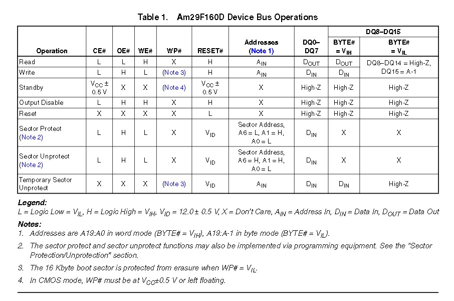

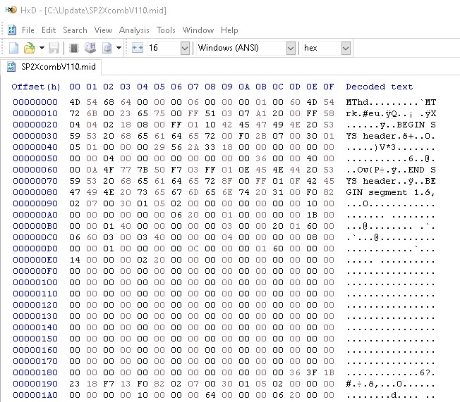

I include the information from datasheet about the signals for the flash Eeprom programming
And the 2 Midi firmware files top sections the bootloader to start up the system and the main code
Any ideas to extract the firmware data and see if the connect_boot 50 pin port can be used with the TL866 programmer? Thanks a lot.

It seems that the extraction of the firmware from the MIDI files would be impossible, so the best is to read from the former working SP2X the firmware. Based on the information on schematics to avoid the possibility of an accidental erase of data I will force the set of the programmer rising with a pull up externally the #WE pin disconnecting on TL866 #WE to set the flash Eeprom into read mode. This will be the best way because I don't want to have caused by an error on the computer application an accidental write. On the flash procedure a write command should be sent before to initialize the write mode because the memory runs an internal manager to write the data. This means that is impossible to assert a command erasing accidentally the data inside the flash memory with a voltage fluctuation or power lost on a device. Sometimes an unexpected data lost disaster happens. For safety the idea to force the read mode pulling up #WE externally to avoid an unexpected data erase.

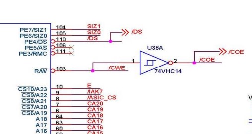

Inside the mainboard is a Schmitt trigger inverter 74HC14 connected between the CPU MC68331 and the flash memory to handle the #WE and #OE. Because the MCU68331 will not find the boot device removing the boot select J2 jumper on schematic all MCU inputs and outputs should be float in high impedance state. In the case of writing I will connect the #WE line to the TL866 programmer because the write procedure interchange handshake information to report the status, errors etc. Inside the memory is a factory AMD code that manages the initialization and write sector procedure. The boot sector is located on the bottom address on the AM29F160DB but I don't know is this is related to the bootloader or the internal write manager, In reading mode there is no need to send a command because works like a standard Eprom meaning that there is no way with a power spike to assert a write command interchange to initialize the write procedure erasing accidentally data.
For the programming I will use this setup soldering  on the top connectors a 50 pin SCSI parallel cable used in the old computers to the connect_boot  port. And with the tester I will check before the TSOP48 connections between the red PCB and the flash memory soldered on the mainboard.
The bottom adapter is needed to enable the write in 16 bits mode because is the way set by default on the mainboard with a pull up resistor on the flash memory, also is important to provide external 5 volts Vcc because of the current protection on TL866 and USB power limitation. I need to confirm that the adapter on TL866 works in 16 bits write mode.
Sounds good the idea exposed? Any suggestions corrections are welcome because is a complicated topic.
« Last Edit: September 30, 2023, 01:54:58 pm by alfredokiwi »

The adapter seems to use two 74HC373 latch address buffers expanding the bus lines to write the flash memory in 16 bits mode. And much better because the programming runs at lower speed enabling the use of a parallel SCSI cable.
This workaround forcing the memory setup only in read mode would not harm the working firmware in the reading process, but before opening the working SP2X I will test on failed mainboard if the flash memory is properly detected reading the entire code memory block to analyze what remains on data with an disassembler tool for the MC68331, family of the MC68000 Motorola processor.
I hope to have good news in the next days, please let me know for any suggestions if something is wrong.

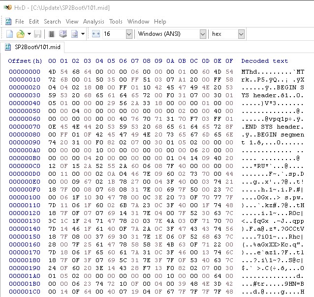

I wonder if the structure of the firmware update bears some similarity to Roland's?
https://forum.hddguru.com/viewtopic.php?p=249990#p249990
Offline alfredokiwiTopic starter

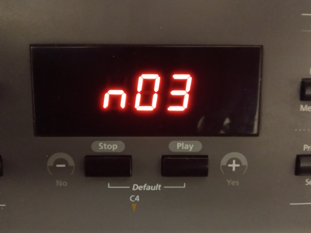

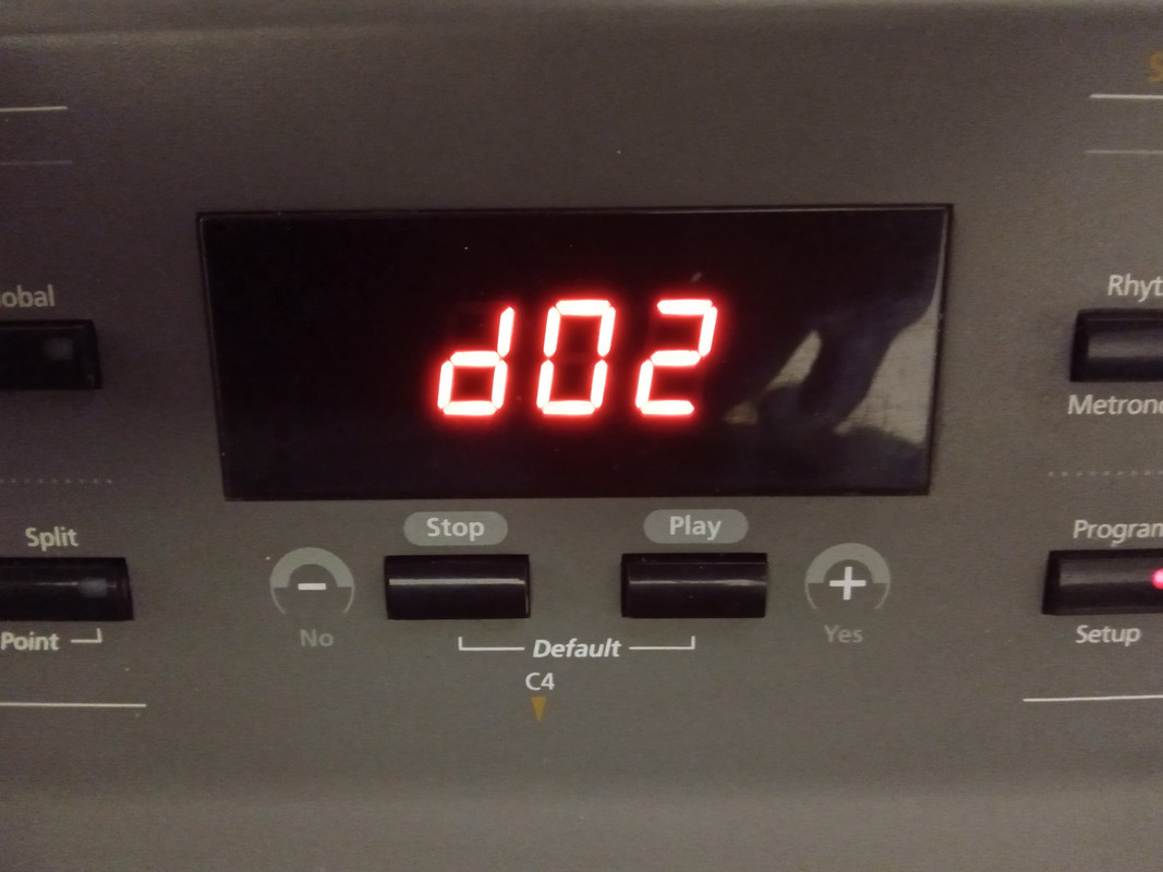

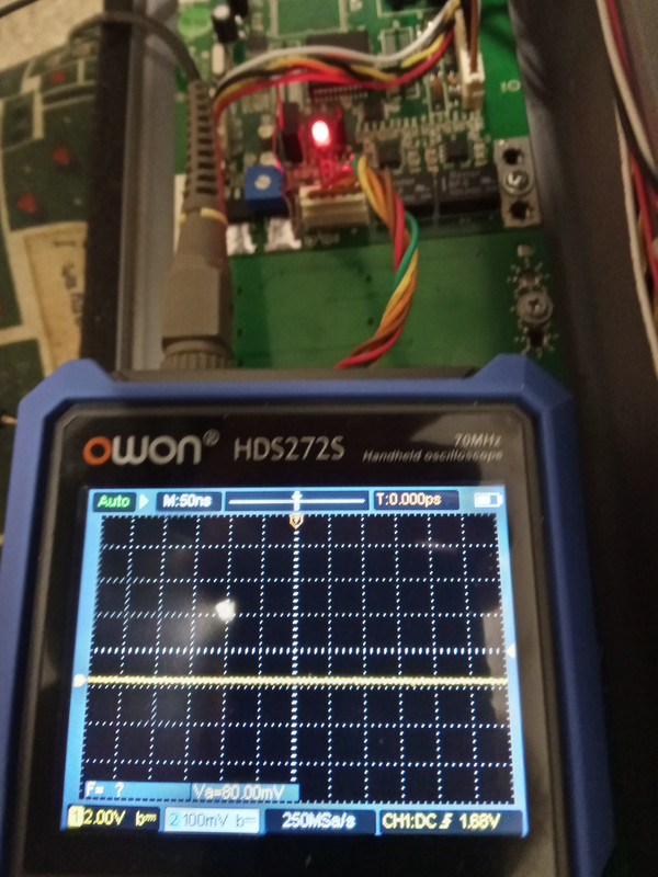

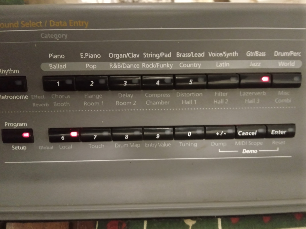

On last tests seems that the failure is on the DSP. I was able to start up again the Kurzweil, forcing a reset on the DSP. The main CPU 68331 is waiting for a response from the Kurzweil MARA chip. This is the reason why a hot reset on the DSP overrides the issue. On the previous hot reset days ago the DSP worked fine in the sound output and effects adjusting the DSP Vcore at 2,8 volts below the factory 3,3 volts. But now it was impossible to make it work again with sound output, only the display and buttons panel works properly. And every day that pass the DSP consumes less power running at cool temperature meaning that there are issues caused by the high DSP temperature on the past without factory heatsink. I have some pictures and a video here the display and push buttons panel started to work properly because of the forced reset lowering the Vcore on the Kurzweil MARA DSP core. In other words the main CPU received a DSP Ok message starting the normal operation, communicating the UART with the panel and display. The DSP reset works like a sort of DSP error override.
In the first picture is running the demo 2 a MIDI format song inside the flash Eeprom chip
Here is selected the piano sound  3
The selection of sound on the panel buttons working properly after DSP hot reset
To know if the system DSP started I soldered a red led on the coils of the mute relays, the red led means DAC sound output enabled. Kurzweil decided to use relays for the DAC output avoiding the pop noise on DAC initialization. With the blue trim potentiometer soldered on the 3,3 volts regulator I make the adjustments to lower the DSP voltage. This was the way at the beginning to eliminate the output white noises lowering the voltage on Kurzweil MARA DSP. But DSP degradation continues despite the lower Vcore voltage. The root cause is the inside silicon core deterioration caused by the past hot running temperature in the range of 70 celsius without heatsink. This is the reason why in year 2013 I installed on my former SP2X a passive southbridge heatsink on DSP, because inside the silicon ASIC hot spots are at 100 celsius or more.
The oscilloscope helped a lot to understand what really happens. Here the culprit part is the poor silicon quality of the MARA Kurzweil DSP ENGINE. Inside the DSP seems that a degradation caused by the hot running temperature exhausted the chip core. I don't know if the DSP runs a sort of microcode but in the case of the effects the allocation  of the algorithms is dynamic depending of the sounds in use and user patch configuration.
I will continue to investigate.

Offline fzabkar
  • Posts: 2735
The .mid file consists of 8802 blocks of data of size 0x106 bytes beginning with ...
F7 13 F0 82 02 07 00 30 01 05 02 00 00 00 00 00 00
The blocks are contained within segments.
This is an example of a block that is filled with data. Many blocks are full of zeros.
Offset(h) 00 01 02 03 04 05 06 07 08 09 0A 0B 0C 0D 0E 0F
00000000  F7 13 F0 82 02 07 00 30 01 05 02 00 00 00 00 00
00000010  00 01 18 00 00 29 34 00 00 00 06 20 00 00 00 00
00000020  00 00 00 00 00 00 74 40 60 0E 48 08 01 5B 00 00
00000030  00 0D 59 00 00 00 6E 00 07 00 04 65 20 00 4F 50
00000040  62 53 70 00 64 3E 4F 4F 60 09 52 64 28 3E 00 0D
00000050  04 09 79 28 2A 3E 04 66 29 50 04 7D 02 14 19 00
00000060  07 63 6C 7C 7C 01 4D 16 62 43 70 04 68 1F 4F 4B
00000070  42 53 70 26 3E 41 00 66 29 61 21 78 02 32 1E 67
00000080  68 00 04 69 34 14 1F 00 06 41 7C 7C 56 15 1F 02
00000090  53 14 68 02 3E 41 0A 4F 40 03 11 76 3E 3D 00 66
000000A0  4B 41 21 78 02 34 10 27 65 41 29 78 11 19 28 00
000000B0  13 74 18 54 7C 00 19 0F 53 73 78 02 34 59 0A 0F
000000C0  40 03 21 02 3E 2A 0A 4F 41 19 4A 34 01 1F 20 45
000000D0  06 20 01 78 7B 1F 1F 00 33 25 58 50 7C 01 1A 07
000000E0  73 72 70 54 7C 09 4F 50 20 19 4A 38 28 3E 00 4C
000000F0  47 59 7A 00 01 1A 2D 05 07 60 01 50 3F 1F 15 45
00000100  20 5E 41 2D 24 68
In Roland's case, 7-bit data is converted to 8-bit by unpacking the 8th byte of each octet. Kurzweil seems to do it differently.

Here are 5 consecutive blocks. The data payload appears to begin at offset 0x1C within each block. The last 6 bytes appear to be metadata of some kind.

000000D0  22 4F 50 53 76 14 7E 05 1F 41 27 74 29 7E 0A 3F
000000E0  62 4F 78 54 00 15 00 45 20 11 28 08 2A 03 0A 41
000000F0  02 50 20 54 0A 15 03 05 20 71 28 1C 2A 08 0A 42
00000100  20 6C 7D 77 5F 30
The following users thanked this post: alfredokiwi
  • Posts: 10
  • Country: ar
