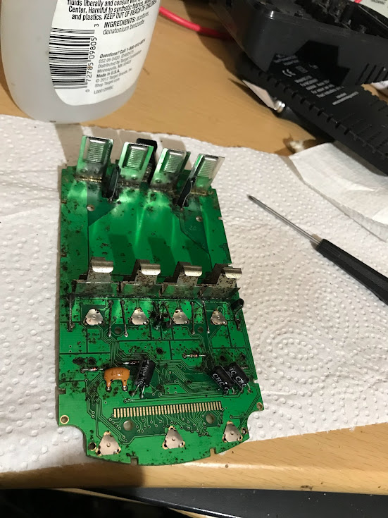

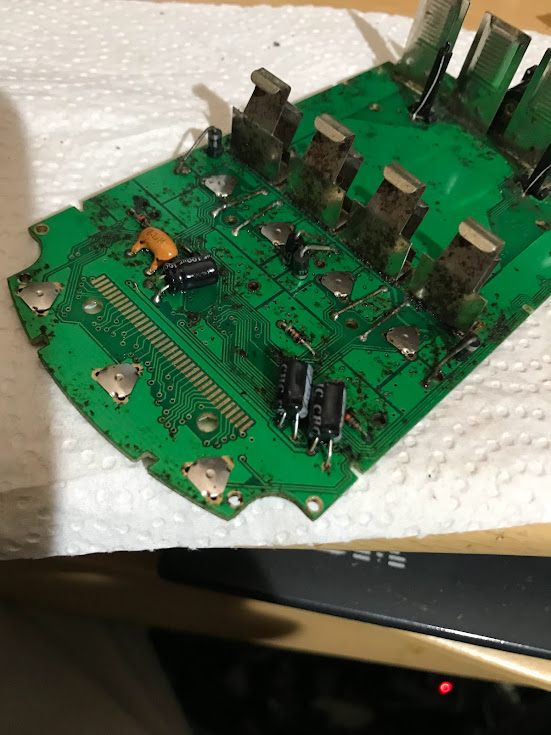

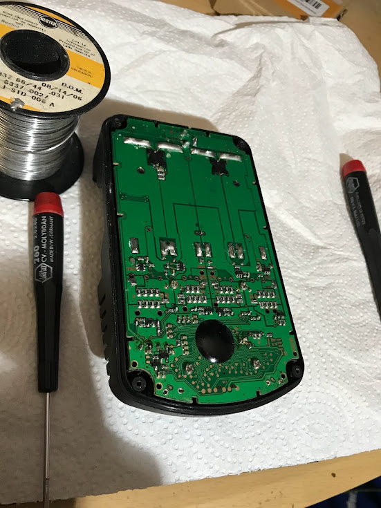

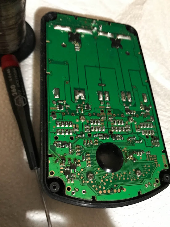

Anyway ... some photos I snapped ... note that only the top of the board has the roach excrement stains --- much has since been removed; it does not seem to be corrosive. The bottom (component side) was completely ignored by the roaches.
It's possible that a roach short damaged a transistor, or passive, creating the non-functioning button.
« Last Edit: January 17, 2022, 08:36:11 am by 13hm13 »

Can you tell if the deposits ate through the conformal coating? I see several places where a stain bridges circuit traces, which could short control signal lines.

SIGH!!! .... no, as noted prev., the roach poop did not eat thru the conf. coating  ... it comes off with 99% alch and q-tip. Though a little elbow grease is sometimes necessary.

The non-working buttons DMM (cont. test) work just fine on the PCB test points -- i.e., same as working buttons.
I did begin some component-by-component testing on the PCB ... and found a possible problem for the MODE button circuit. Note the "154" smd R. It should be 150k, but my Fluke 87 reads 6.7M. Haven't gotten round to replacing it. It may have blown because of a faulty transistor, etc. Dunno!

Removed the "154"R. Very messy .... one trace pad lifted off (!!) so had to trace that pad to trans. pin. SIGH!! Upon removal of the "154"R (which, again, my Fluke 87 read as 6.6M), the BC was plugged in ... NO display at all (unit was dead). Bodged in a 100K R (all I had). Unit working again ... but NO CHANGE in functioning/ non- functioning buttons. In other words ... all that work for nothin'!
