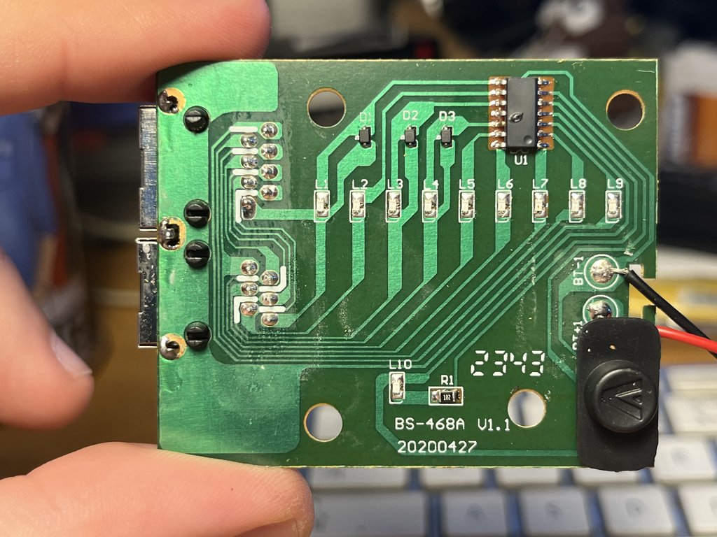

Hello! I have this LAN tester that got burned out by PoE voltage. This is a newer version than most common ones being driven by a classic CD4017 decade counder IC (16-pins).
Has anyone any idea which IC is being used here (it is unmarked, of course)? It's a 14-pin in SOIC14 package (if I'm not mistaken).
Btw, these testers go for a 3-4 bucks on Aliexpress but would like to fix it anyway, for fun and for good practice! 🙂 Thanks!  :-+

Knowing which pins are VCC and GND could help (at least to filter out the ICs that don't match). It's not quite clear from the photo: the GND (power negative) trace goes to under the IC, and it's not clear where the battery plus trace starts, as the power positive terminal is covered by that plastic cap.

« Reply #16 on: May 26, 2024, 11:04:01 am »
Pin 4 VCC and Pin 11 GND.
Pretty sure single chip solution for this kind of gadget is a MCU.
Looks like the chip is just painted over, maybe some application of various chemical can help. If they didn't sand it first ofc.

Okay I found two sources that claim that the IC might be an "SAM8928". Here someone posted a schematic (note the SAM8928 in the BOM links to an SN74AHCT02D which has a different pinout, I guess they just used that one for the SOIC-14 footprint and renamed it). On this page somone analysed and modified different version of those testers.
A quick google search did not yield any sources for that IC.

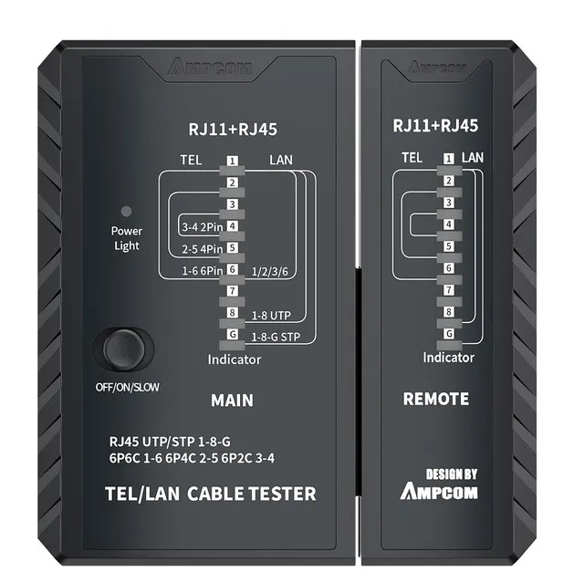

The chip clearly contains both an oscillator and a counter, and apparently pressing the button even puts it into a "slow" mode.
Sounds like it's some dirt cheap Chinese microcontroller with appropriate firmware. Even if you could somehow identify and buy the MCU, it's still worthless without the code.
