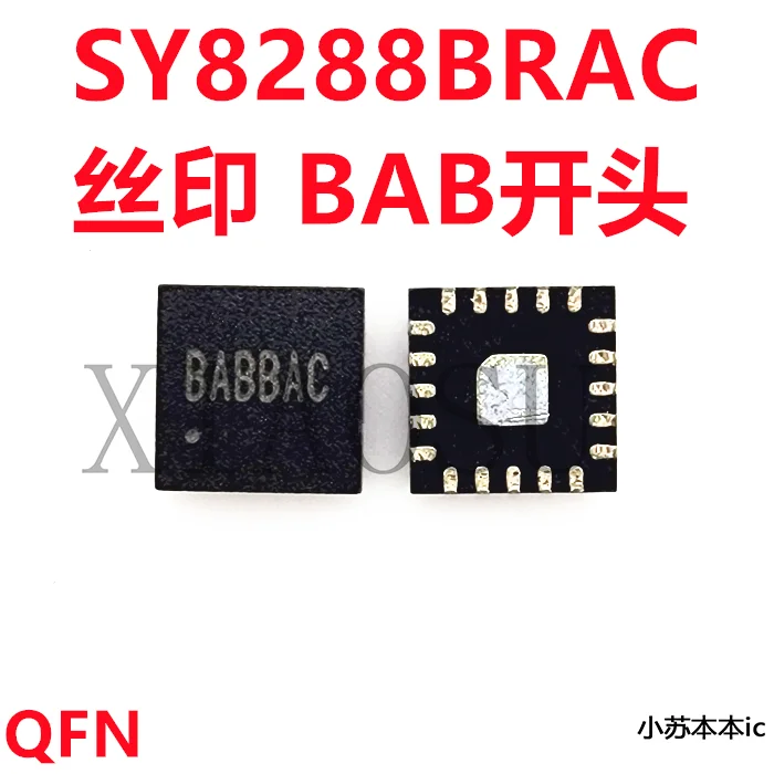

I'm betting it's a Silergy part.

That thread is talking about this chip:
https://www.semiee.com/file/SILERGY/SILERGY-SY8386BRHC.pdf
Its marking is Qqxyz - Device code: Qq, x=year code, y=week code, z= lot number code
The case is important. For example, yQxyz and YQxyz refer to two completely different Silergy parts:
https://datasheet.lcsc.com/lcsc/2204071830_Silergy-Corp-SY7311AADC_C2986879.pdf

« Reply #11 on: December 03, 2023, 02:23:41 am »
LA-992 r1b schematics, I don't think it's very different from r1c?
The pinout of the SY8388BRHC seems identical.
https://www.aliexpress.com/item/1005003630991643.html
« Last Edit: December 11, 2023, 02:01:58 pm by DavidAlfa »

and it is the yQ part. thanks a lot David!

FYI, I notice that the "B" part is a fixed 3V regulator whereas the "A" and "D" parts are variable, and have slight pinout differences.
https://datasheet.lcsc.com/lcsc/2207201830_Silergy-Corp-SY8388ARHC_C5110279.pdf
https://www.semiee.com/file/SILERGY/SILERGY-SY8388D3RHC.pdf
