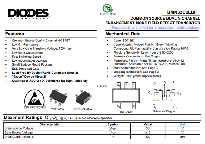

However, there is one more board (or actually 8 small long boards) still not described and it's the boards connected directly to the LCD panel.
I've included a photo of two of those boards here:
1620571-0
1620577-1
Unfortunately, one of those boards experienced some water damage, as pictured here:
1620583-2
I guess some water or other liquid was spilt on the TV.
Fortunately, these boards are fairly simple, mainly consisting of some capacitors and resistors.
After cleaning off the corrosion, I've found three capacitors had gone short circuit and I've been able to replace those.
However, there is also a 5-legged SMD IC labelled "J516T" which is performing unusually.
1620589-3
Unfortunately, I have not been able to find a datasheet or other information about this IC.
Does anyone have any ideas?

Attached are photos of the board (front and back) with the chip removed.
1621789-01621795-1
Unfortunately, the board looks like it is a multi-layer so not quite so easy to trace out visually.
U1 is the chip in question.
Pin 2 is definitely ground.
Pins 3,4,5 immediately disappear off to vias.  I would need to do some poking around with the multimeter to see where they go.
Pin 1 connects to a via _and_ a resistor.  I could measure the value of this resistor but not sure it would reveal anything definitive.
I was wondering whether the chip was a linear regulator, BUT the lack of any caps immediately nearby is a counter-indicator.
Looking up "_J51_6T" on the SMD marking code database suggests it might be a linear regulator, or an "ElectroStatic Discharge Protection diode".
https://smd.yooneed.one/code4a35.html
The first ESD SOT-23-5 that I looked up could be a winner.
https://au.mouser.com/datasheet/2/240/Littelfuse_TVS_Diode_Array_SP05_Datasheet_pdf-777043.pdf
The SP0504BAHTG has pin 2 GND, with a single diode going to each of the other four pins.
This looks to me to be the most likely bet - I'll check the chip with a semiconductor tester to see if this confirms anything.
Thanks again for the hints!

On twitter I speculated a dual mosfet.
A regulator without any caps doesn't make any sense.

So I was able to desolder a good version of the "J516T" chip and do some tests.
Buzzing out the chip with a PEAK diode/transistor/semiconductor tester indicated that the chip contains 4 diodes, as indicated in the diagram below.
The configuration is (to me) unusual and the forward voltage of the diodes falls into two groups (two are 0.65V and two are 2.8V) as indicated in the diagram.
For the bad "J516T" chip, the diode on pin 1 was open circuit, but otherwise the same as the good chip.
I also tried testing various combinations of the SMD legs to see if there was a transistor or FET present, but nothing came up - just independent diodes.
So... the plot thickens.
I didn't spot any SOT-23-5 devices with two sets of different diodes in the package when I was looking around.
Any ideas?

Is it possible you're measuring pin protection circuitry here?
Bit of a wild guess, but could it make sense for a differential line driver or receiver? Something like DS90LV011A (but not that exact one). Many SOT-23-5 all with the same basic pinout for driver or receiver.
Pins 3 & 4 are the differential pins so you may be measuring overvoltage for an LVDS pin relative to GND (pin 2)? (The LVDS maximum voltage is not referenced to VCC in these chips, although I don't know how they are actually implemented.)
However if this was the case then you'd also expect to be able to measure some protection circuitry directly between pin 1 (VCC) and pin 5 (the LVTTL single-ended pin), and probably also undervoltage protection between 3 & 4 and GND. Also, I have no idea why these boards might need this.
The only similar (equally wild guess) option there would be an op amp, which are available in similar SOT-23-5 standard pinouts and pins 3 & 4 are typically the op amp inputs.

I did some further testing on the board yesterday to check the chips connections to other points on the board.
Pin 1 and pin 4 of the J516T chip are connected together, and together connect to a zero ohm resistor (R394) (I think effectively a fuse), but it doesn't seem to connect to anything else on the board, which is really weird.  The only thing they might connect to is a connection on the thin ribbon cables that run to the LCD panel, but I'm unable to probe those.
Pin 3 goes to one pin on the input connector CN2 (pin 3) (which I think is a power supply pin, but I'm yet to confirm) on the other end of the board and there is one bypass capacitor (C305) on the line near the input connector.
Pin 5 goes to three sequential pins on the input connector CN2 (pins 68,69,70) on the other end of the board and it also connected to 8 bypass capacitors (C304,C316,C323,C326,C333,C336,C343,C346) going to ground along the way.
Pin 2 is ground.
I've captured a high-resolution image of the board, which helps understand the configuration.  The J516T chip is removed in this image.
1627087-0
Unfortunately, it seems the board is multi-layer, so this top view doesn't tell the full story.
But... given it seems there are only bypass capacitors connected to the J516T chip, to me it seems likely to me that this is a Transient Voltage Suppression (TVS) chip.
Given it's only one of the diodes (pin 1) that is malfunctioning on the bad J516T chip (which should have a forward voltage of 0.7V) I might just solder the chip back with pin 1 disconnected, and see if this allows the LCD panel to behave correctly.  I could solder a small external signal diode between pins 1 and 2 to replace the missing diode in J516T, but I wonder if that is absolutely necessary.  I was thinking of drawing up a simple schematic to illustrate what the circuit looks like.
But as you can see from the circuit board image, the J516T chip is the only chip on the board.  Everything else is just capacitors and resistors.
All comments, ideas and theories very welcome!  Thanks for reading this far!

3DMovieList, can you measure the height/width/length of the package?
I've measured the J516T chip with a vernier and the measurements are:
3.0mm (L) x 1.6mm (W) x 0.75mm (H)
« Last Edit: October 30, 2022, 04:30:17 am by 3DMovieList »

Good news!  There is LIFE in the TV!!!
I borrowed a "J516T" chip from another 65UB980T that I am repairing and that has brought the 84UB980T TV to life!
More details to follow, but replacing three SMD caps, and the "J516T" chip has brought the TV to life.
