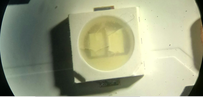

I have had the exact problem with the LG 50inch it uses the exact same panel as yours . The output voltage are stamps on the board.
 being the 50 inch has a few more leds . After checking it had 2 shorted leds on almost every strip and 1 open. As already said the LEDs are not fixed 100% good so the solder is not completely under the LEDs causing them to bend when hot and crack in the middle.
This is a fault on most LGs .
And we find a quiet a few in the recycling.
I just ordered a complete new set of back lights for a mere $18 so for a free smart tv I guessed it's worth it. Yes the biggest problem is space when lifting the screen up and not to bend it .

So far only Labrat101's photo gives me some form of credible proof on what actually destroys the LED's.
Sure running lower current is likely to improve their lifetime too. Modding the current sense at least is user-proof, when you know about the problem may as well turn the backlight down in the picture adjustments. (There may even be a service mode setting?)

Firstly LG especial all fail after about 5 to 7 years .
The manufacturers like this way . They are designed to work for so many Hours.
if the warranty says 5 year warranty don't expect to get more  :wtf: .
The LEDs rely on the double sided tape to cool them onto the back plate . The tape
looses heat transfer efficacy . If you check closely about 30% of all the LEDs are NOT soldered onto the stripe correctly ie only the ends are bonded These will warp and crack in the middle and will short opposed to going open circuit . This is part of the design every LED that shorts  puts more stress on the next . and the snowball effect starts . The over current wont kick in to about 5 or more LEDs have failed . Maybe.
Removing one resistor from the current sensor is fruitless turning the brightness to 55 % and increase the contrast to 90% has the same effect .
 Always replace the entire set other wise you will just have to do the whole job again in maybe a month and this time you will have a second chance to Crack the Screen.
and a totally wasted your time and have ... Still a non working TV  :palm:

The LEDs rely on the double sided tape to cool them onto the back plate . The tape looses heat transfer efficacy
It's not like that. Those circuit boards are made from single sided CEM-1 with poor thermal conductivity. So something like 50 microns of adhesive tape does not matter whatsoever. LEDs fail because of excessive heat, time they spend overheated and thermal cycling. It's not like cooling worsens over time. And it's not like some LEDs overheat because adhesive comes off, it holds well. I inspected LED strips under microscope, 100% of the LEDs had cracks in the compound, even though most of them were still functional.
That's some wild claim  :wtf:. Why "correct" soldering would save them from warping? Also why 100% of the LEDs become cracked even though only 30% of them are soldered wrong?
1. You calculated the number completely wrong, it reduces current by 25%. And max brightness loss is even lower since LED efficiency worsens at high current. Perceptible brightness loss is barely noticeable since eyes are not linear. 2. It's not fruitless, it limits maximum current/brightness and thus maximum heat.
And then you should explain this to everyone who uses the TV to never set the maximum brightness, even though it's often a default setting. And hope they will never forget over the years. Reducing maximum current limits maximum brightness/LED current to safe level. Increasing contrast is lame since it compromises image quality.
True, disassembling LCD panel bears a serious risk. And skimping on new LED strips may turn into cracked glass and TV going to the dumpster.
