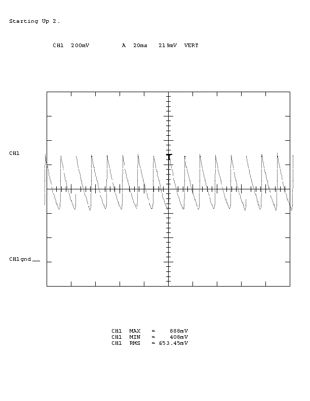

Thought I'd have a look at its behaviour under current limiting. Ewwww.
All readings are x10. I was using a cheap probe and it doesn't tickle the selector ring on the scope.
Using a 12V 21W lamp as a load. Current limited to bring the voltage down to ~6.5V :
So, Max volt ~ 8.,8 and Min ~4.0. Average is ~6.5 (which is what it read on the display)

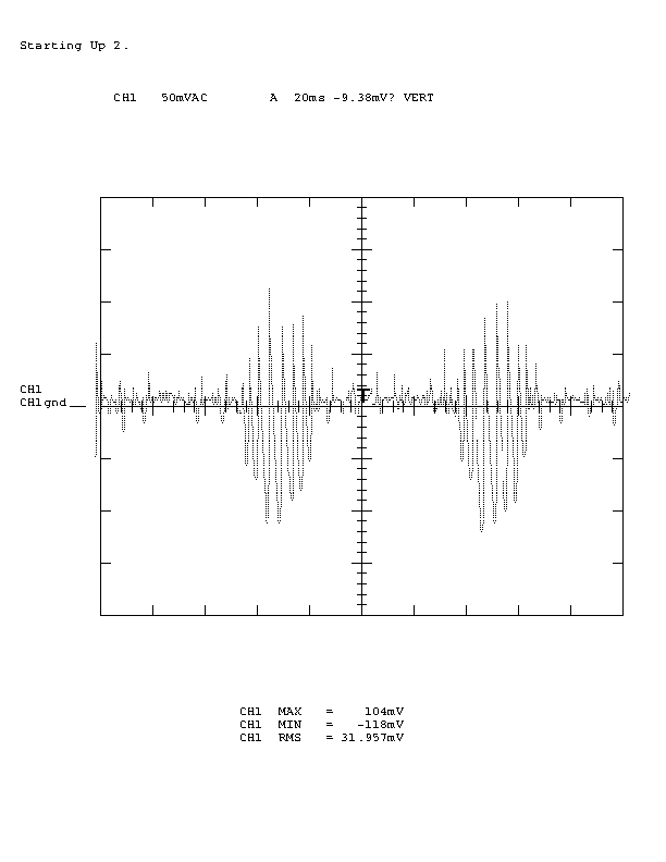

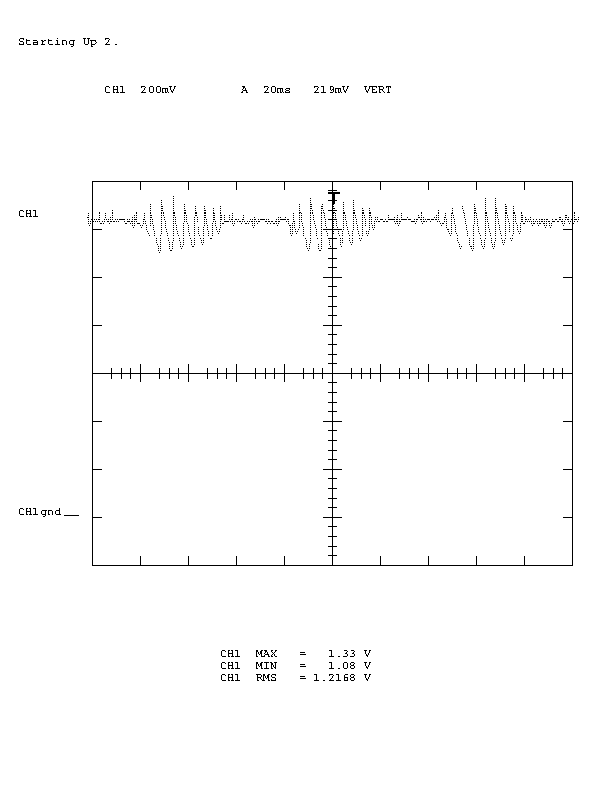

Ok then, so what happens as we start to get out of current limiting?  Bursts of limity noise goodness :
Same but AC coupled with a bit more amplitude :
So, this'll make a decent battery charger. I'm not sure I'd let it loose near anything valuable, particularly when approaching the current limits.
