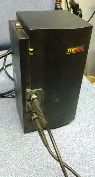

I own the Metcal MX500P power supply.
The model that i own is the 1 without the display :
My trouble is: when im using the power supply with the hadler (MX-H1-AV) my hadler after some minutes is going to get hotter in the middle of the hadling zone.
So im thinking to open my power supply and replace all capacitors,maybe this could fix my problem or maybe the problem is the hadler it's self ?

Seems to me that your tip cartridge is defective. Try a different one and see if that helps. In contrast to typical soldering stations, the heating power of these is determined only by the tip, not by the base station, which just acts as a big RF power amp.

« Reply #6 on: August 03, 2017, 11:48:30 am »
Problem is solved !!! 8)
Basically my STTC-144 is defective .
I tried to plug my brand new STTC 536 and the problem of the overheat on my hadler is gone :)
