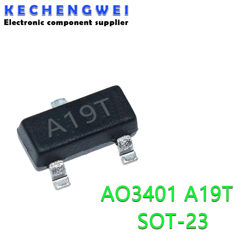

  • One MOSFET marked A19T, on the old board the equivalent is marked P05 with a sideways P
  • One MOSFET that's too exploded to read anything off of on the New board but is a 702 with a :C with the colon downwards on the new board. It may be the same on the old but with a different odd character after the 702, as there's at least one other 702 MOSFET on the New board
  • One blank black box with a chunk taken off the silver strip at one end. Measures no resistance or capacitance on the Meter. Some poking around suggests it may be a 0 Ohm resistor?
I think the 702 MOSFET is possibly an 2N7002.
The A19T is one of several components: HM3401C, HX3401A, or KI2301T
The P05 is possibly this: SO2907

702 is a "jelly bean" MOSFET (2N7002):
First, thanks so so much! Super helpful!
Also I hadn't actually run across the term "Jelly Bean" to refer to generic stock components, so thanks for introducing me to it! (I know, I know, it comes from EEV Blog, but I haven't watched nearly every video yet  ;D )
