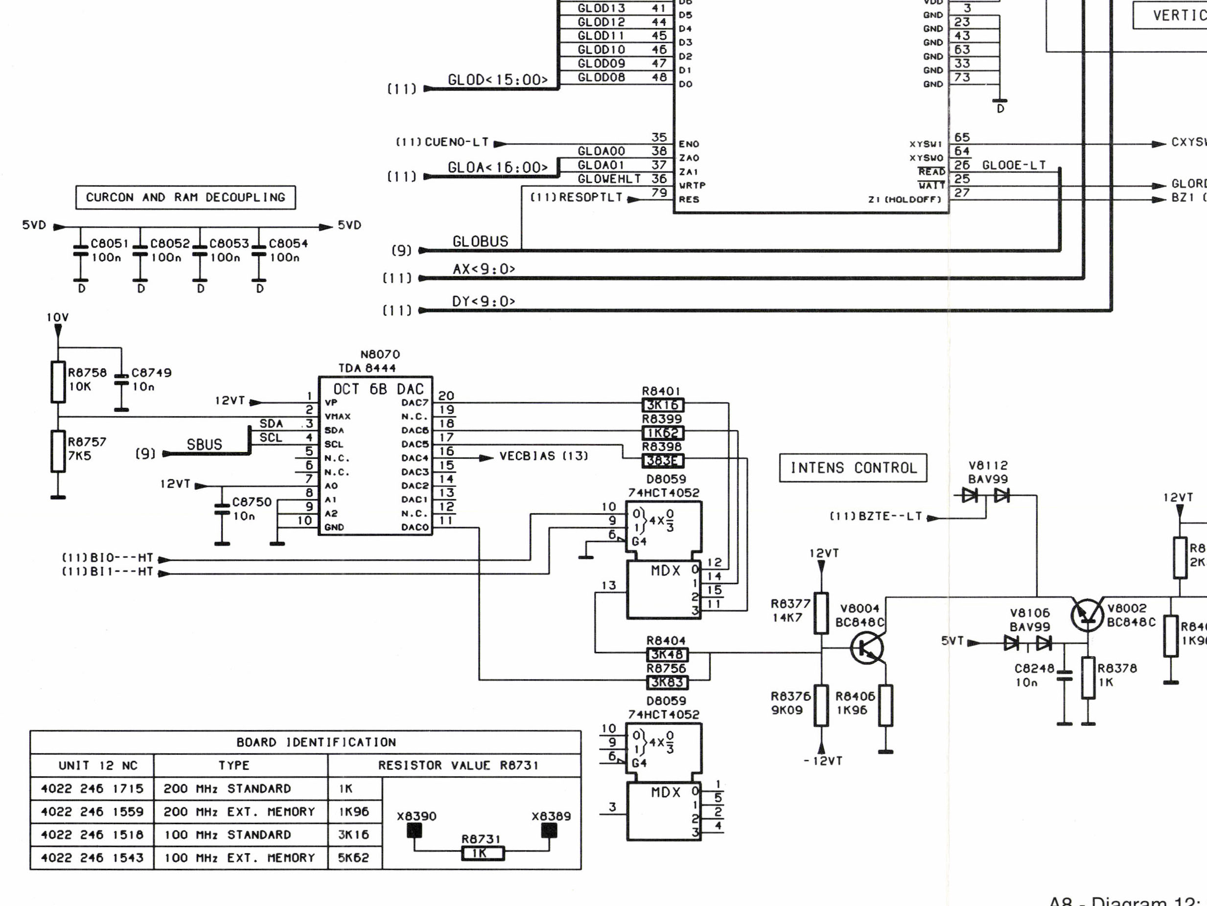

The easiest place to start is going to be with the dim readout text - this fault is quite likely to be on the A8 board since it was the same with either CPU card.
If you look at the circuit diagram the trace intensity is controlled by voltages output by a TDA 8444 I2C addressable DAC, these are then fed into a 74HCT4052 analogue multiplexer selected by a couple of control lines, and the output from that fed into the Z-Drive circuitry after a couple of other voltages are mixed in.
This is the relevant section of the circuit diagram - again it's a bit hard to follow on the thumbnail, click on the image for the full sized version
The lines control the intensity as follows:
BI1BI0
00Text
01Normal Trace
10Not Used
11Intensified Trace
Since the normal trace has good brightness it might well be that the dim text is because either the TDA8444 or the 74HCT4052 is having problems. It also ought to be fairly easy to debug - if I can get a DMM hooked up to the DAC outputs I can check whether the voltage increases/decreases as I adjust the front panel control. If not then the DAC is probably hosed - this is an obsolete part but easily available on ebay for a couple of quid.
EDIT: Anither possibility, looking at the truth table for the control lines is that BI1 is stuck high and it's actually switching between the intensified trace setting (which I'm mistaking for "normal") and the unused (and unconnected) input.
If the voltages coming out of the DAC and into the analogue switch look good then I can try to get a 'scope on the BI0 and BI1 lines and the multiplexor output and see whether that correctly follows the inputs. Or I could just replace the chips as it will be less than £5 for both.
I very much doubt it's the I2C bus as that would give lots of other problems, not do I think it is anything to do with the intensity control or Z drive after V8002 because that would affect all the intensities.

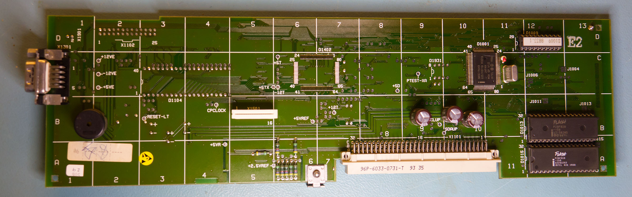

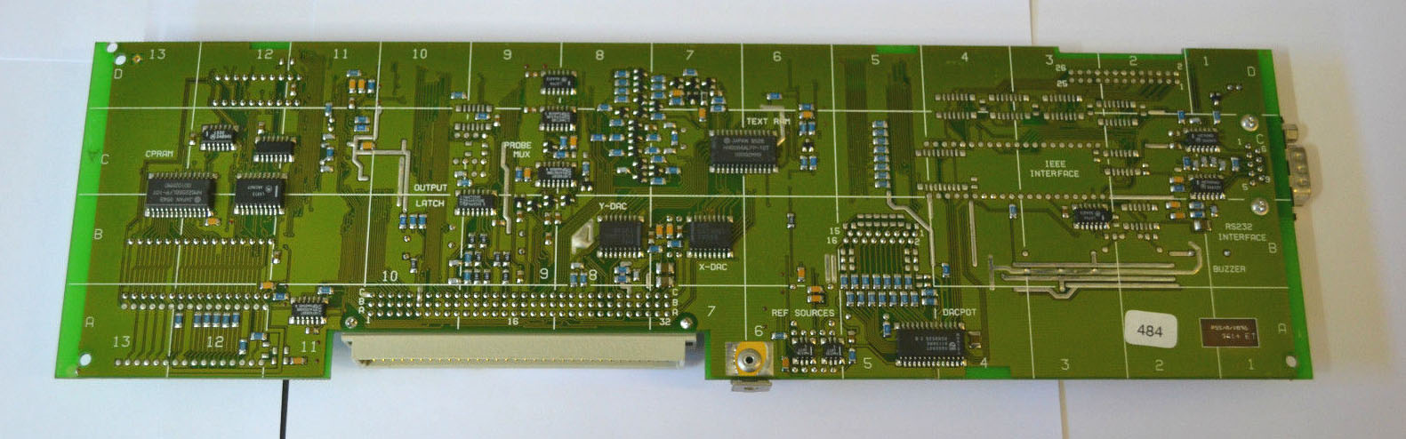

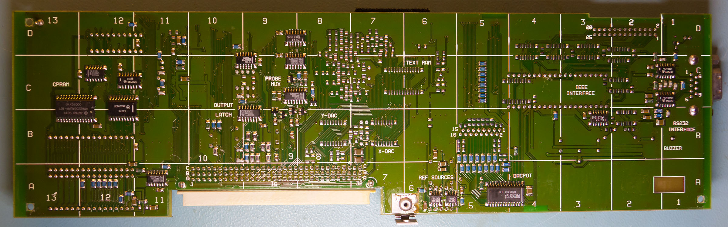

First of all the CPU card from my 3382 - this looks to be slightly newer than the card from the 3394. In fact the 3394 card doesn't really look to be the same vintage as the rest of the 3394 so might not be the original.
The silk screen has quite a bit of useful info with a number of test points identified.
Not sure what D1402 is but I suspect that the CURCON chip can be placed on the CPU board for some variants as there is also annotation for some of the missing chips suggesting that this card can have a text RAM and X&Y DACs.
In fact these are populated on the 30[89]x series which are analogue-only 100MHz and 200MHz 'scopes as can be seen in this picture of a CPU card from a PM3082 "borrowed" from an ebay listing.

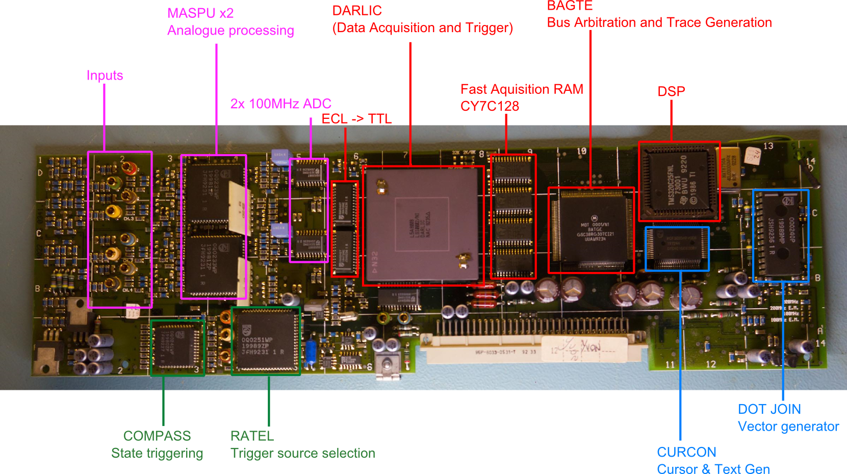

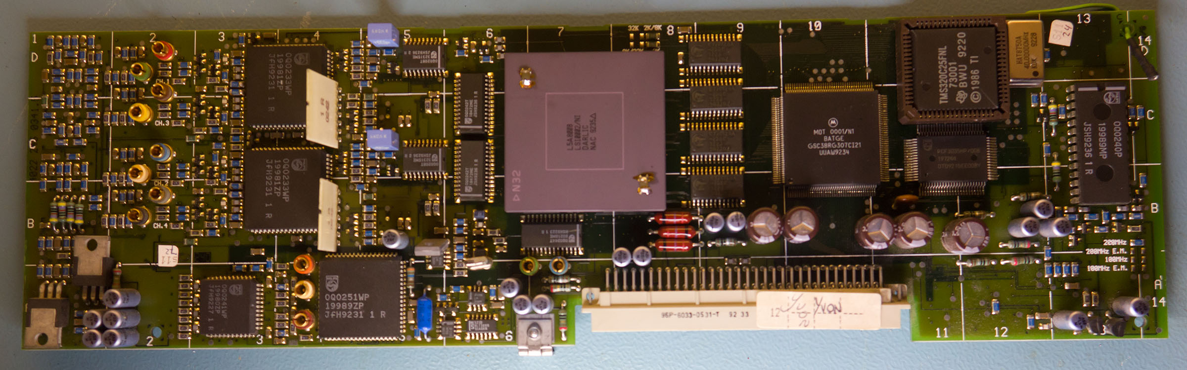

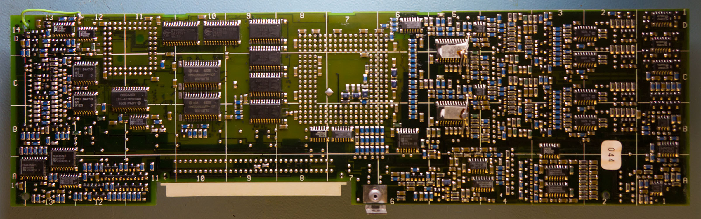

The A8 card is rather more densely packed than the CPU card - but to be fair it does contain all of the DSO functionality for the 'scope. Front and back views
This card is quite complex and has several custom IC's - so that you can see what's on the card here is an annotated shot.
With DARLIC's and UFO's it's clear that the design team was just a bunch of Sci-Fi geeks  8)

To recap, having fixed the CPU<->Front panel fault the remaining problems were very dim text which could not be adjusted by the text intensity control and an "DSP communications error" message on the screen at boot.
The first check was to plug in the digitiser from the 3380B - apart from the fact that I got an "A8 board wrong hardware ID", this appeared to work - in that it allowed the text intensity to be varied and would happily display four traces in both digital and analogue mode.
That confirmed a fault in the original digitiser board. At this point I considered just using the board from the 3380B as it works. That might sound a bit odd as the 3380B is a two channel 100MHz 'scope but in fact there are only a few real differences between the cards. For a start it might be that there is no 2-channel version of the DSO board - certainly the board High Voltage sent has components mounted for all 4 input channels so that just leaves the bandwidth difference.
Looking over the schematics only the front end has a 100MHz and a 200Mhz version and looking in more detail at those it appears that just 7 components per channel differ - shown in blue on the 2nd (100MHz version) diagram below.
200MHz DSO front end:
100MHz DSO front end:
So, it would not be impossible to upgrade the board to 200MHz, especially as I had a donor with just the right components in situ. However I thought it would be worth persevering with the fault finding.
I was originally suspicious about the intensity control DAC and multiplexor shown below
Now that I was able to probe some signals I found that the two select lines BI0 and BI1 were always low - this puzzled me quite a bit until I realised that in analogue mode the trace is switched between text and signal by a different signal and only the normal text intensity is used - the other intensities here are for DSO mode.
That exonerated the two control lines and probably the 74HCT4052 so I checked the DAC output to find that it did not vary with the text intensity control on the faulty card but did on the 3380B card. Swapping the DACs between the two boards did not fix the problem so it was not the TDA8444's.
However, if it's not the DAC then the I2C bus falls under suspicion - but if that was hosed I couldn't understand why anything worked because all sorts of control and select signals hang from it.
Looking at the schematics afresh, the DSO board has its own  I2C bus so, along with the error message about the main CPU not being able to talk to it properly the finger of doubt pointed very clearly at the DSP.
Sure enough moving the DSP from the faulty 3394 card to the 3380B card brings the fault with it so it looks very much as the DSP is hosed. The DSP itself is a mask programmed version so the only way to obtain a replacement will be from another one of these 'scopes. Before I put the good DSP into the faulty board I want to make sure that all the voltages on the socket are OK and there isn't another fault on the board which "killed" the DSP but it looks as though the faults have now been traced to their source.

I had a go at upgrading a 100MHz DSP board which did not go well, however I think I just tried to do too much changing the RAM and the input components together - the result was an unstable card that would not complete calibration so I might have to try backing out some of the changes to see what went wrong.
However since then I have had chance to try to upgrade a DSP card from a 3384B - that already has the extended memory so just the card ID and bandwidth needs to be addressed and I decided to make small changes with checks along the way to see what happened.
I have also ascertained that the DSP is not a mask programmed part. Presumably the main CPU writes the DSP code into its PRAM which is good news as TMS320C25's can still be found on ebay.
There are two sets of resistors which tell the firmware what bandwidth and memory options are on the card - R8901/2/3 and R8731 (one of the four is fitted) on the "large component" side of the board and R8349/8359/8360/8365 on the rear of the board. If these are set appropriately the board will "work" without an error message in a higher bandwidth 'scope (e.g using a 3384[AB] card in a 3394[AB])
As well as the changes I identified in the front end there are also a couple of changed values in the sym/asym converter - possibly to do with biasing the amplifiers in the MASPU, there might also be differences in the input biasing which are not documented in the service manual (i.e I found values not corresponding to the schematics).
Having done this on the 3384B card I was pleasantly surprised to find that even without changing the input RC filter values the DSP bandwidth was within 3dB at 200MHz, I need to check this out further but I am wondering whether, in practice, it is even necessary to change anything other than the board ID to "upgrade" from 100MHz to 200MHz.
