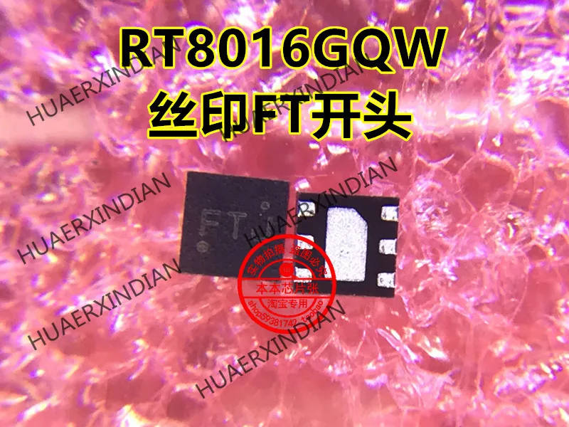

It's a different marking style (font and dot/dash codes), but this may be the "FTJ" part:
RT8016GQW, Richtek, 1.5MHz, 1A, High Efficiency PWM Step-Down DC/DC Converter, 2.5V - 5.5Vin, marking FTx, WDFN-6L 2x2:
https://www.richtek.com/assets/product_file/RT8016/DS8016-04.pdf
https://www.rom.by/files/Richtek_Marking_Code.PDF (marking FT)
https://ae01.alicdn.com/kf/H8948a44fc0cb49b494d5e9bc19676a68Y/New-Original-RT8016GQW-print-FTJ-FTH-FT-QFN6-In-Stock.jpg (photo)
