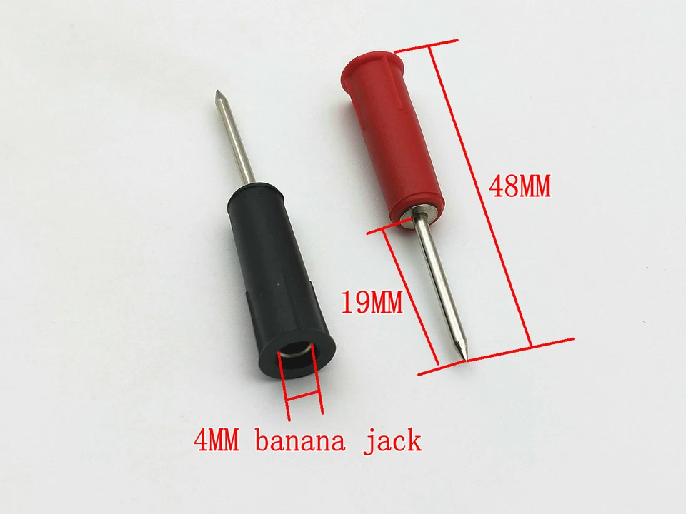

So you don't understand why I get annoyed when I pose a question regarding a goddamn tip plug, a penny-ante item, which I need a longer version of--something that should cost, oh, I don't know, less than a dollar, and I get the following responses:
  • Someone's eBay auction for a set of test leads for $19.95
  • Another eBay auction for a set of tip-to-banana adapters (not at all what I was looking for, btw) for $11.60
  • A listing for yet another set of tip-to-banana adapters in a language I don't understand (or perhaps I should just drop everything and learn Chinese for the occasion?)
If that's your idea of helpful, I just don't know what to say.
As I said, if worse comes to worst I'll just make a damn plug out of a nail. I would just like a ready-made solution if one is available and doesn't cost too much.

Actually, all of the posts were very much on point with regard to trying to help solve your problem.  My link to the eBay seller came along with a specific next suggested step, and if you scroll down the listing he offers additional services upon request.  Not to mention his eBay rating is stellar.  How hard is it to just send him a message via eBay and ask if he has a suggestion??  If he doesn't, no worries, you're just trying to solve a problem and sometimes a path doesn't work out.
The tip to banana jack idea is actually quite good, because it allows you to use many popular test leads, since banana jacks are so much more common.
Fine. It's in Chinese. I don't read Chinese.
So how many more unhelpful irrelevant replies will there be? C'mon, keep 'em coming!
There is zero excuse for language concerns these days, as many browsers offer a translate function, as does https://translate.google.com and even your smartphone.
