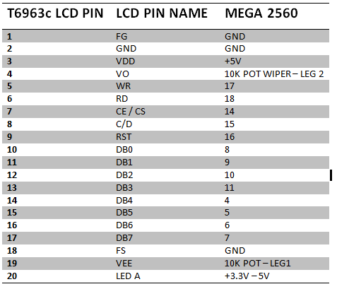

Here's a pinout I found for driving the LCD with an Arduino.
Keep in mind you may not need to connect all the pins.
Also, you the new LCD might not even be compatible.

I have use the T6369 controllers a few times.
CD (command/Data) is sometimes referred to as A0 (address 0)
CE (chip enable) is probably synonymous with CS (chip select)
The reset line is active low, it needs to be high for the controller to run, it should be toggled by software but could just be a static line at Vcc.
FG probably means Frame ground, i.e. the chassis / metalwork of the display
FS (font select) selects one of two inbuilt fonts, usually grounded.
The data sheet for the RA8855 looks as if it is a clone of the T6369
I'd say that if you get the connections sorted then there is a good chance it will work for you.
hth David.
