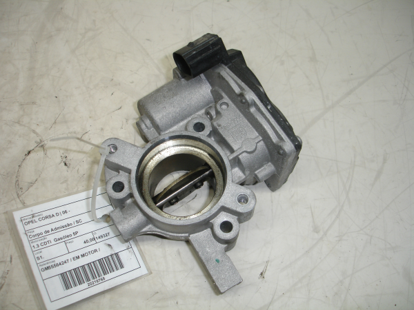

Are you sure you are not looking at the throttle actuators rather than the injectors?
https://www.eevblog.com/forum/repair/need-replacement-for-an-obsolete-mosfetcomponent/msg4415851/#msg4415851
I agree, I have never seen injectors driven by an H bridge, they typically have a single low side driver.  The H bridge that the OP is looking at is far more likely to be for the throttle actuator.
Offline digikTopic starter
  • Posts: 71
Re: Opel Corsa D ECU Repair
« Reply #21 on: June 20, 2023, 12:39:07 pm »
Carefully study the block diagram on page 3 of the datasheet ;)
Yeah, sorry  :-[
Then why the car is shacking at idle when the gas pedal is not pressed?
My throttle body sould be like this:
so an entire H bridge only for this sh*t?
