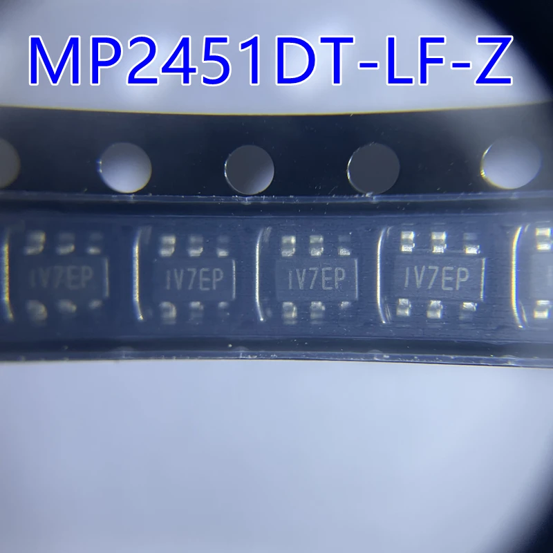

Hello to All
Plesase help to find what reference for this code of the following photo.
Thanks and Regards

IV7xx = |V7yw = MP2451DT
MP2451DT, Monolithic Power, Step-Down Converter, 3.3V - 36Vin, 2MHz, 0.6A, marking V7yw, SOT23-6 / TSOT23-6:
https://www.monolithicpower.com/en/documentview/productdocument/index/version/2/document_type/Datasheet/lang/en/sku/MP2451/document_id/253
https://ae01.alicdn.com/kf/S1c4b06e22e3447ddbd26e720c3b43798y.jpg
(photo)
http://markingcodes.com/search/c/iv7
