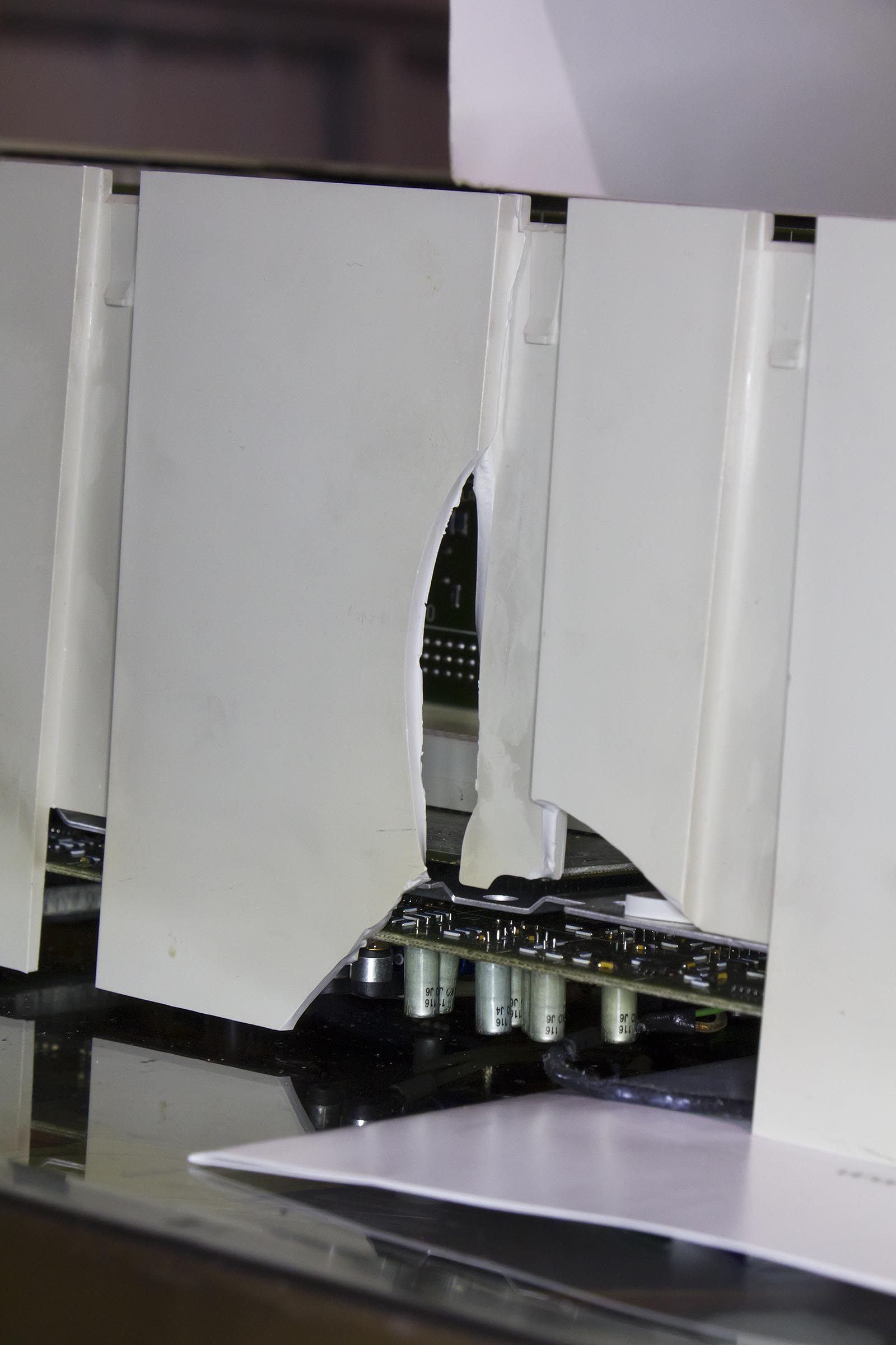

I have many of these Fluke Philips Combiscopes and they are usually pretty easy to repair.
Well, sometimes they are beyond repair...
I just bought a 2 channel version on ebay, the PM3380B and it arrived as junk.
Everything is broken in to pieces, most likely from shipping damage.
May be I can salvage some PCB's and the tube.
Here are some pictures, it shows the modular build up of the scope pretty well.
These scopes were state of the art in the 1990th.

HighVoltage - you wouldn't be interested in selling the front panel board from that broken 'scope you have, would you?
Well, I have to wait what the claim with the shipping company and the seller will bring.
I filed a claim and hope of a partial refund.
The seller claims he packed it well
The shipping company claimed we signed for the acceptance of the package and because of that we released all possible claims.
But.... lets say we will find a way ...

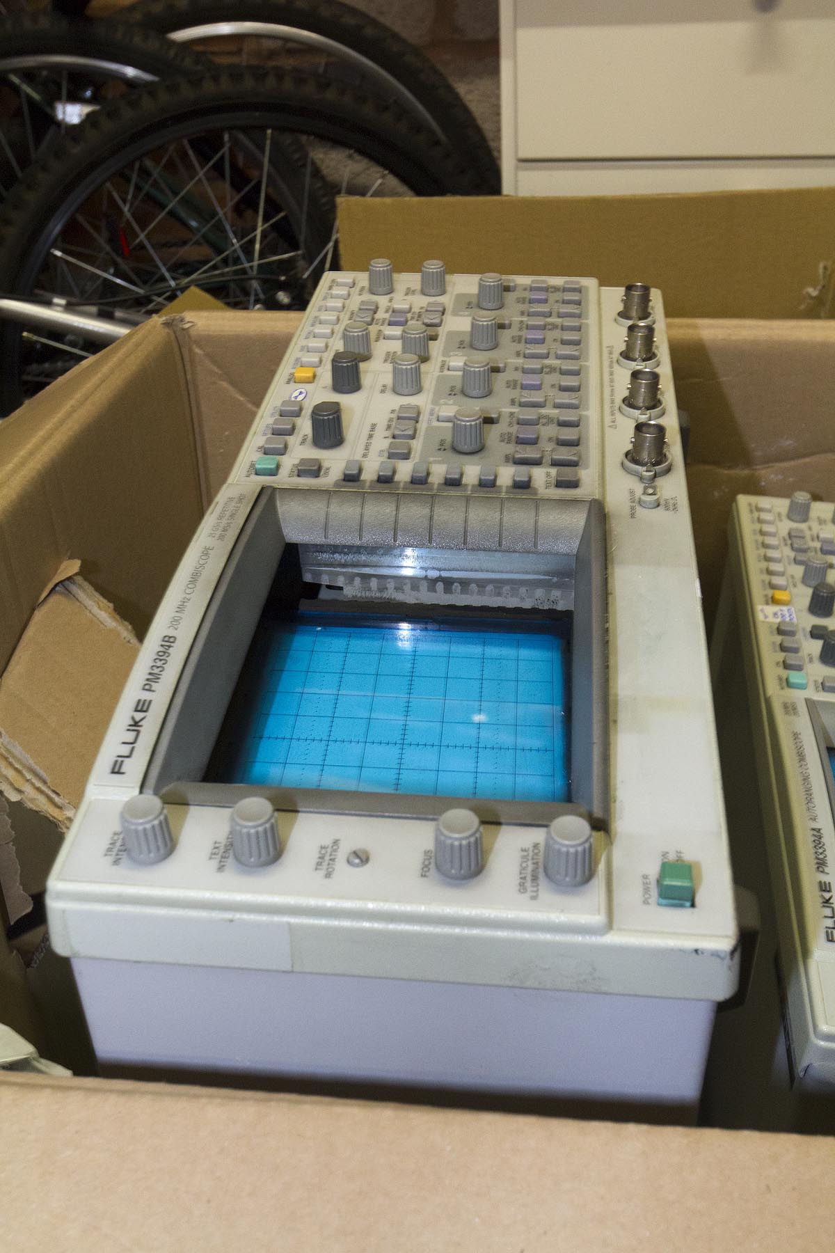

However I would argue that the seller didn't really pack it well. Unconstrained polystyrene chips and recycled Amazon crushed paper packaging are not really appropriate or adequate for an item the size and weight of this 'scope.
Are you having magic powers or how did you know what the seller used for packing this scope.
(see picture)
Making the matter worse, on the side of the box it said "Hand Towel ZIGZAG FOLD"
So, I can not even blame the shipping company 100%

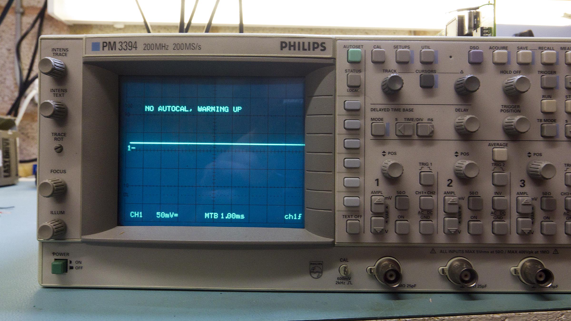

Swapping the good CPU card to the 3394 gets a good bright trace - yay!  Sadly however there's no readout text - not even the very faint text with the original CPU card.
The text is generated from the acquisition card so I'm not sure why it has disappeared - except that getting the CPU card out is no picnic.

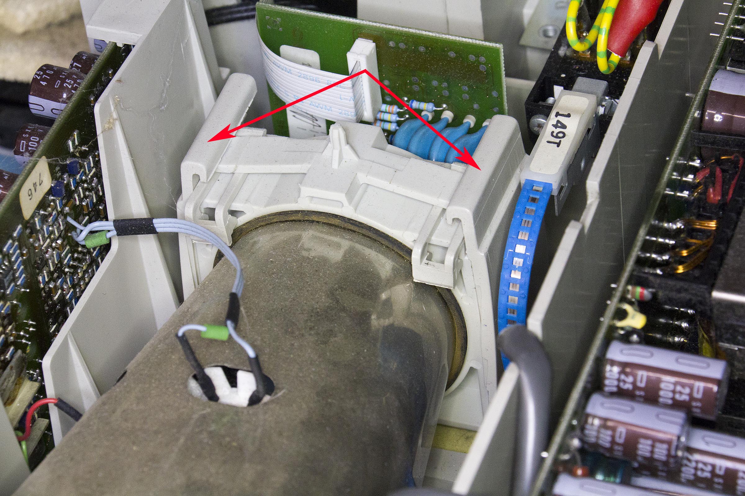

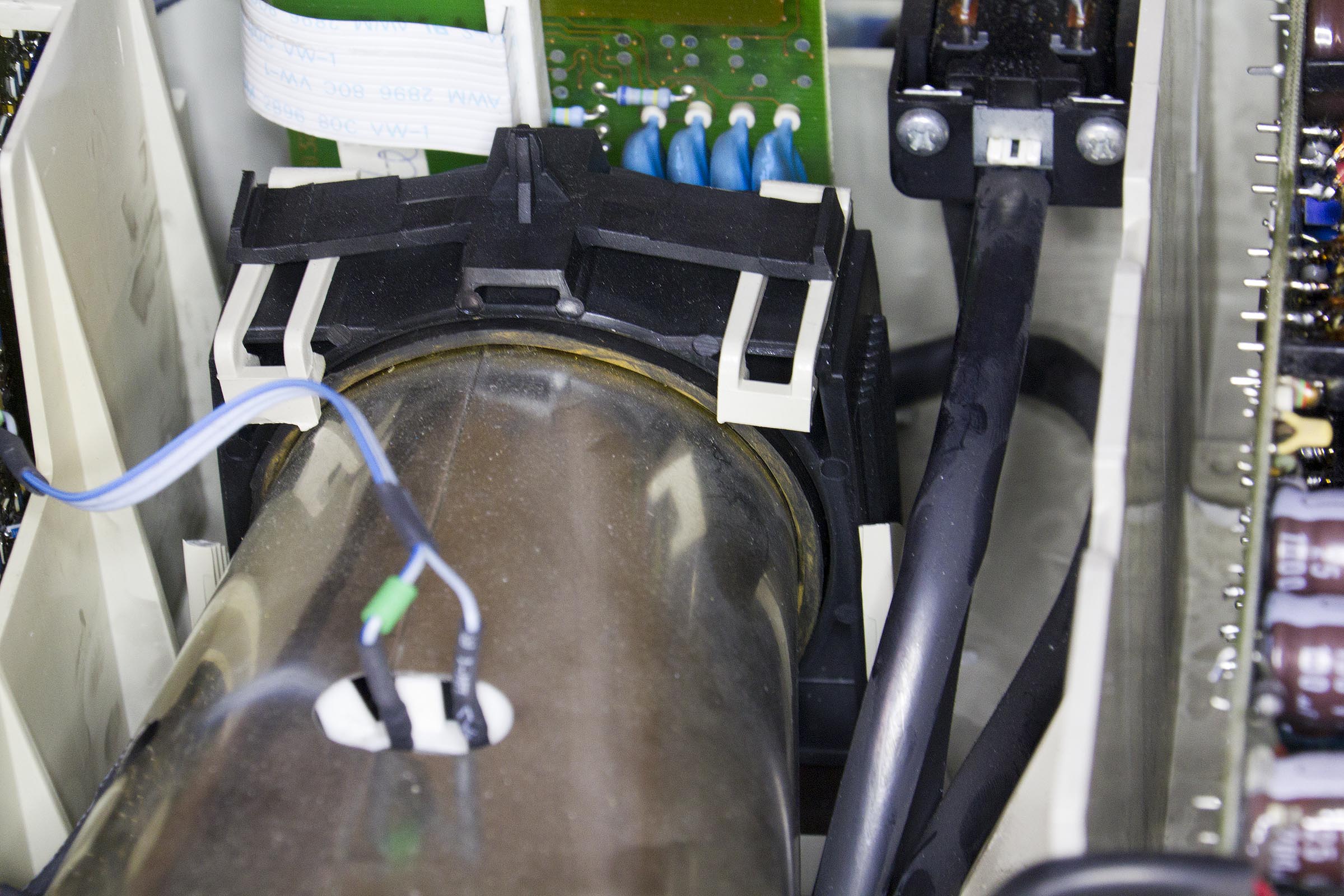

The manual says remove the retaining screw, remove the screw holding the 9-way RS232 connector to the back panel and the ribbon cable down to the A1 analogue board and the CPU card will lift up.
The manual lies!
You can see the problem in HighVoltage's photos - there are a set of coax cables which loop over the CPU board RS-232 connector to plug into the acquisition board. These make it impossible to remove the board. In the end I unplugged them from the analogue board to get some leeway but not before trying to get the required slack by unplugging the acquisition board - which promptly got wedged and I needed to manhandle it rather roughly to get it out. Or rather not get it out as there are yet more cables plugged which become obvious as you try to lift it up. So I unplugged the other end pr the cables needed to free the CPU card, however I'm now wondering whether I damaged the A8 card.
Hopefully it's OK and it's just a Z-drive issue but I need to sit down with the schematics and trace out the signals.

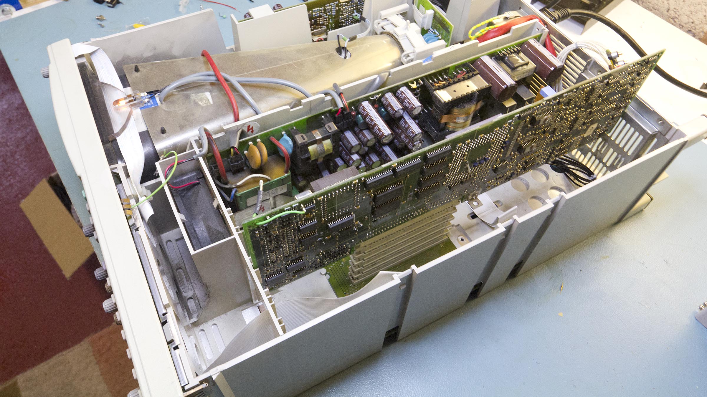

OK, as promised - some photos to complement those from HighVoltage, and the start of repair efforts.
All the images are linked to a full-size version.so just click on the image if you want a more detailed view.
First of all this is what the inside should look like when it hasn't been mangled by poor packaging and being used as a football by the courier. This is my 3382 rather than the 3394 but they are essentially identical.

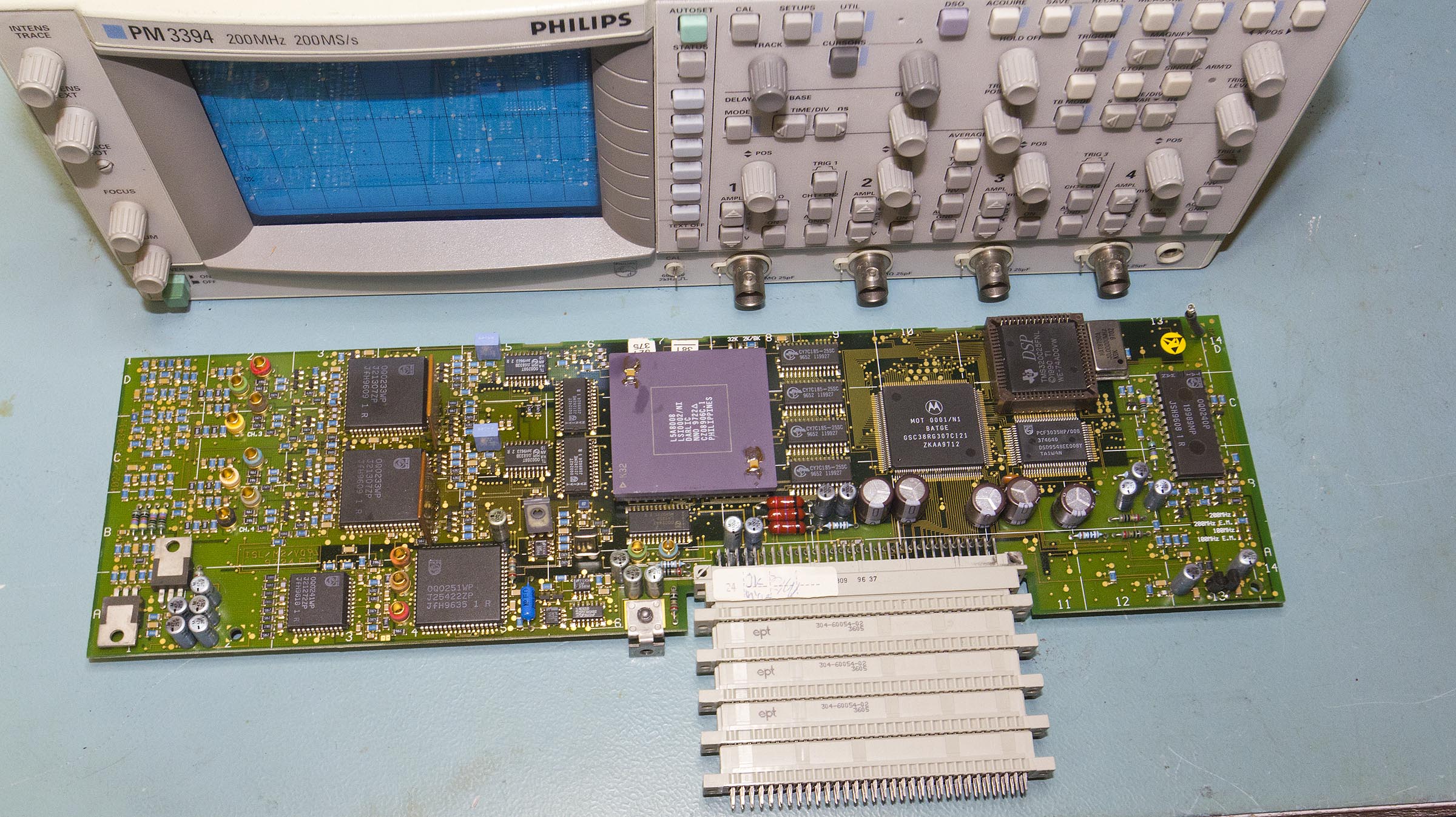

The lowest card in the picture above is the acquisition and data processing card A8 - basically the DSO part of the 'scope plus triggering and text generation. It has several custom chips, two 200Ms/s ADC's and a TMS 320C25 DSP. I'll probably need to have a more detailed look at this card to figure out why I'm not getting any readout text from the 3394.
The next card up is the main CPU A3, then the power supply A6 and at the top, just visible the final X, Y and Z amp board A2.
Underneath is the A1 board carrying the analogue front end and signal paths.
The white coax carries differential signals from each of the four channels to the digital board. If you look at the first photo you can see how these loop up and over the RS232 connector on the CPU card, making it almost impossible to remove, in the end I just unplugged them - I don't need the digital section to work to debug the CPU to UFO link. They are neatly colour coded though - if you look carefully at the full sized version you can see that each of the connectors on the board has a coloured ring which matches the one on the cable.

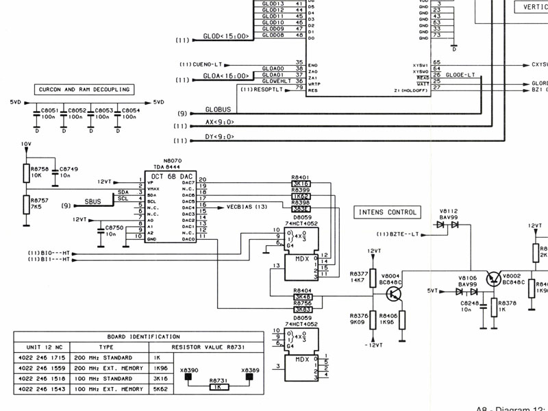

The easiest place to start is going to be with the dim readout text - this fault is quite likely to be on the A8 board since it was the same with either CPU card.
If you look at the circuit diagram the trace intensity is controlled by voltages output by a TDA 8444 I2C addressable DAC, these are then fed into a 74HCT4052 analogue multiplexer selected by a couple of control lines, and the output from that fed into the Z-Drive circuitry after a couple of other voltages are mixed in.
This is the relevant section of the circuit diagram - again it's a bit hard to follow on the thumbnail, click on the image for the full sized version
The lines control the intensity as follows:
BI1BI0
00Text
01Normal Trace
10Not Used
11Intensified Trace
Since the normal trace has good brightness it might well be that the dim text is because either the TDA8444 or the 74HCT4052 is having problems. It also ought to be fairly easy to debug - if I can get a DMM hooked up to the DAC outputs I can check whether the voltage increases/decreases as I adjust the front panel control. If not then the DAC is probably hosed - this is an obsolete part but easily available on ebay for a couple of quid.
EDIT: Anither possibility, looking at the truth table for the control lines is that BI1 is stuck high and it's actually switching between the intensified trace setting (which I'm mistaking for "normal") and the unused (and unconnected) input.
If the voltages coming out of the DAC and into the analogue switch look good then I can try to get a 'scope on the BI0 and BI1 lines and the multiplexor output and see whether that correctly follows the inputs. Or I could just replace the chips as it will be less than £5 for both.
I very much doubt it's the I2C bus as that would give lots of other problems, not do I think it is anything to do with the intensity control or Z drive after V8002 because that would affect all the intensities.

However I was spurred on to get this on the bench again following the opportunity to pick up two more of the Phillips Combiscopes - a 3394B which I have coveted for the bench for a while and a 3394A. Of course I also had the 3380B digitiser card that High Voltage sent me so I now have plenty of opportunity to narrow faults down by swapping components.
The "A" was said to be working, but making funny noises when adjusting the trigger level and the B apparently would not to boot, but I always like a challenge.
Sadly the "B" suffered the same problem as the 3380B High Voltage bought, though it was not quite as damaged. On opening the box the sight of lots of loose polystyrene chips greeted me along with two 'scopes that had barely any other protection (a bit of bubble wrap stuffed over the front panels). The CRT of the "B" had disappeared into the case. :(
As usual all pics are links to a larger version.
Fearing the worst I was actually pleasantly surprised to find that the CRT neck was not broken but the chassis had split
and the CRT mounting was completely smashed allowing the CRT to move back a couple of inches.
There is supposed to be a clip each side like this
Thankfully in this case the ebay seller was very apologetic and we quickly came to an agreement on a partial refund.

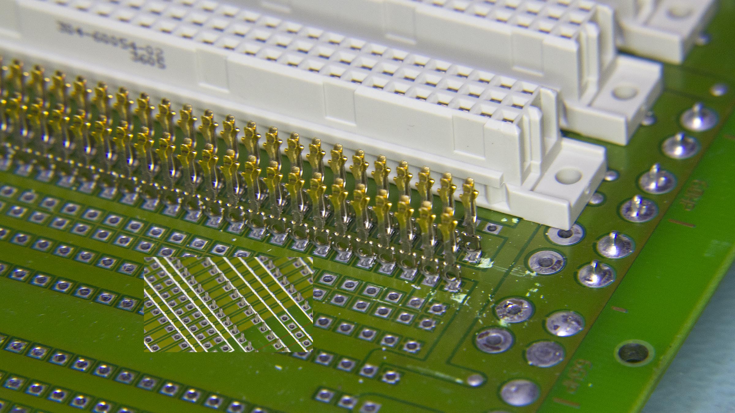

Anyway to get back to the repair - if you recall I was stuck on the issue of riser cards. Digging through my collection of "useful things" I found a Pickering RF switch system I acquired at a Radio Rally a few years back - I liked the card case it was in and there were lots of nice RF relays left (though the really juicy ones had already been stripped).
It had a DIN 41612 backplane, but the really interesting thing was that the sockets were actually not soldered but more cold-welded into place by the through hole plating. It was possible to lever off the socket to leave the pins sticking up out of the board, then push through each pin from the back before finally putting them back in the housing.
I could then stack these to form an extended connector which would allow the board to be accessed, here are the connectors on the board
and here is the board in the 'scope
It's a bit delicate but you can see that the 'scope quite happily runs like this
So, that was the riser card (or extend-a-nector) sorted so now I could try to probe some signals.
To recap, having fixed the CPU<->Front panel fault the remaining problems were very dim text which could not be adjusted by the text intensity control and an "DSP communications error" message on the screen at boot.
The first check was to plug in the digitiser from the 3380B - apart from the fact that I got an "A8 board wrong hardware ID", this appeared to work - in that it allowed the text intensity to be varied and would happily display four traces in both digital and analogue mode.
That confirmed a fault in the original digitiser board. At this point I considered just using the board from the 3380B as it works. That might sound a bit odd as the 3380B is a two channel 100MHz 'scope but in fact there are only a few real differences between the cards. For a start it might be that there is no 2-channel version of the DSO board - certainly the board High Voltage sent has components mounted for all 4 input channels so that just leaves the bandwidth difference.

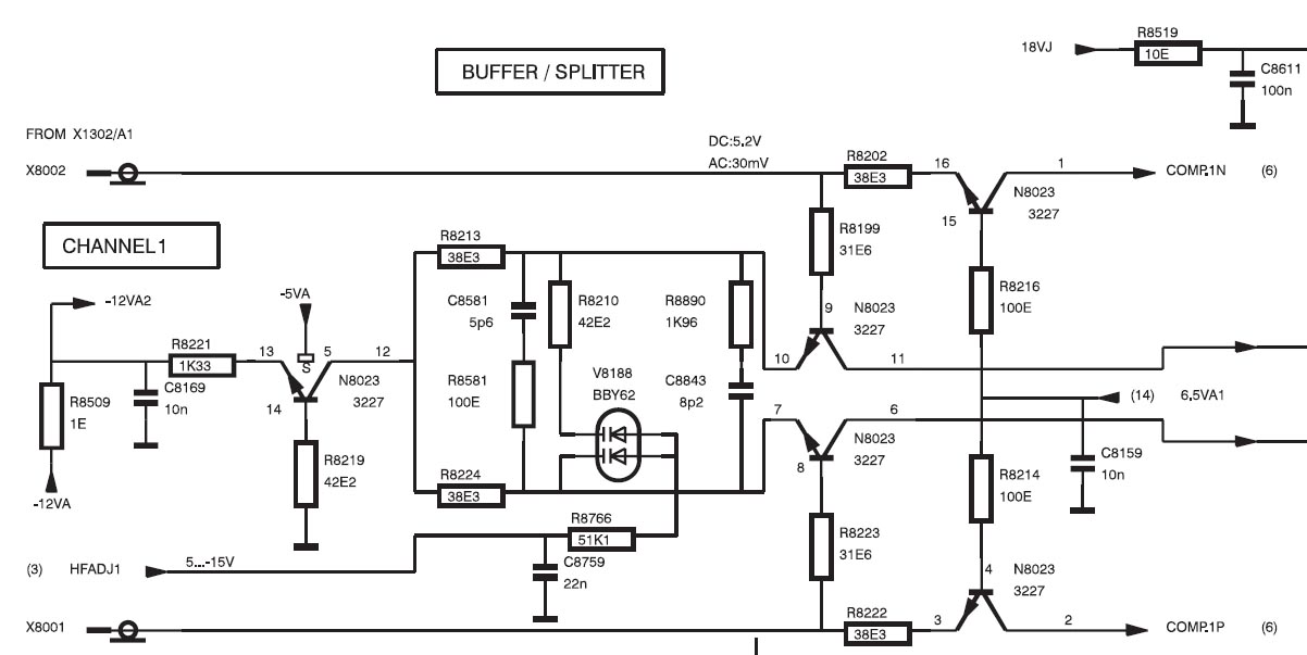

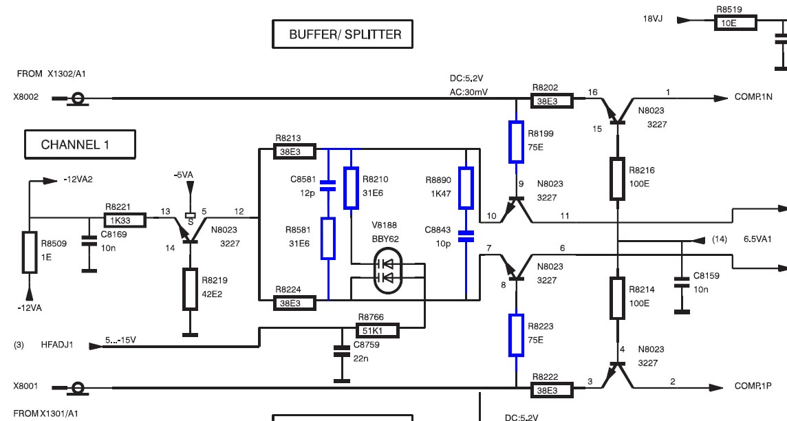

Looking over the schematics only the front end has a 100MHz and a 200Mhz version and looking in more detail at those it appears that just 7 components per channel differ - shown in blue on the 2nd (100MHz version) diagram below.
200MHz DSO front end:
100MHz DSO front end:
So, it would not be impossible to upgrade the board to 200MHz, especially as I had a donor with just the right components in situ. However I thought it would be worth persevering with the fault finding.
I was originally suspicious about the intensity control DAC and multiplexor shown below
Now that I was able to probe some signals I found that the two select lines BI0 and BI1 were always low - this puzzled me quite a bit until I realised that in analogue mode the trace is switched between text and signal by a different signal and only the normal text intensity is used - the other intensities here are for DSO mode.
That exonerated the two control lines and probably the 74HCT4052 so I checked the DAC output to find that it did not vary with the text intensity control on the faulty card but did on the 3380B card. Swapping the DACs between the two boards did not fix the problem so it was not the TDA8444's.
However, if it's not the DAC then the I2C bus falls under suspicion - but if that was hosed I couldn't understand why anything worked because all sorts of control and select signals hang from it.
Looking at the schematics afresh, the DSO board has its own  I2C bus so, along with the error message about the main CPU not being able to talk to it properly the finger of doubt pointed very clearly at the DSP.
Sure enough moving the DSP from the faulty 3394 card to the 3380B card brings the fault with it so it looks very much as the DSP is hosed. The DSP itself is a mask programmed version so the only way to obtain a replacement will be from another one of these 'scopes. Before I put the good DSP into the faulty board I want to make sure that all the voltages on the socket are OK and there isn't another fault on the board which "killed" the DSP but it looks as though the faults have now been traced to their source.

OK, well, not out of the woods yet.
I have the 3394B CPU card and DSO in the chassis. The CPU actually boots fine, the self tests pass and the 'scope will display a trace but the amplitude is off. I expected this because I have not swapped the A1 board so the calibration constants will be wrong, the "screen cal" is miles off as well.
However it will not complete an autocal giving "Calibration Error 00c"
HighVoltage (or anyone) - is there any reference as to what "Calibration Error 00c" is? It does not appear to be in the service manual, nor any other auto-calibration error codes, just the slightly unhelpful paragraph
            "Watch the CRT and check that no errors are reported. If errors are mentioned,
the oscilloscope will need corrective maintenance. The error number
indicates in what part of the oscilloscope the fault may be expected."
But, AFAICS no description of the possible errors is given, Chances are I just need to swap the A1 board in from the 3394B but it would be nice to understand what is happening.
I think to remember that I had this error before, when the manual calibration was far off scale.
Auto Calibration only works if you are not too far off with the calibration.
You probably have to do a complete manual calibration first.
The access code in the utility menu is: "32415"

Well, swapping the boards was, ahem, interesting.
In the 3394B chassis the plastic strain relief inserts in the 8 coax cables leading to the digital board had degenerated and become brittle - to the point that they crumbled as soon as they were touched, in fact most had already fallen apart even before being handled. I now have black plastic dust all over the workbench :(
Also I have fallen out of love with the latching .1" header plugs and sockets that Phillips used - it is rather difficult to get the plug out of the header without breaking it.
Unfortunately it still won't autocal - giving error 00e now.
However I think I see why, it is impossible to get the trace wide or high enough in the screen calibration section even with full gain - it's only slightly off but it's definitely off which is, I suspect, why it won't self calibrate.
It does not depend on which A2 board is in the 'scope, so I'm thinking the PSU or CRT itself. I need to check some voltages.

However upgrading the DSO board to 200MHz looks so plausible I'm half tempted to do it just to see how it goes.
It's a while since I've added to this thread but sometimes real life intervenes and keeps me from tinkering for long periods.
I had a go at upgrading a 100MHz DSP board which did not go well, however I think I just tried to do too much changing the RAM and the input components together - the result was an unstable card that would not complete calibration so I might have to try backing out some of the changes to see what went wrong.
However since then I have had chance to try to upgrade a DSP card from a 3384B - that already has the extended memory so just the card ID and bandwidth needs to be addressed and I decided to make small changes with checks along the way to see what happened.
I have also ascertained that the DSP is not a mask programmed part. Presumably the main CPU writes the DSP code into its PRAM which is good news as TMS320C25's can still be found on ebay.
There are two sets of resistors which tell the firmware what bandwidth and memory options are on the card - R8901/2/3 and R8731 (one of the four is fitted) on the "large component" side of the board and R8349/8359/8360/8365 on the rear of the board. If these are set appropriately the board will "work" without an error message in a higher bandwidth 'scope (e.g using a 3384[AB] card in a 3394[AB])
As well as the changes I identified in the front end there are also a couple of changed values in the sym/asym converter - possibly to do with biasing the amplifiers in the MASPU, there might also be differences in the input biasing which are not documented in the service manual (i.e I found values not corresponding to the schematics).
Having done this on the 3384B card I was pleasantly surprised to find that even without changing the input RC filter values the DSP bandwidth was within 3dB at 200MHz, I need to check this out further but I am wondering whether, in practice, it is even necessary to change anything other than the board ID to "upgrade" from 100MHz to 200MHz.
