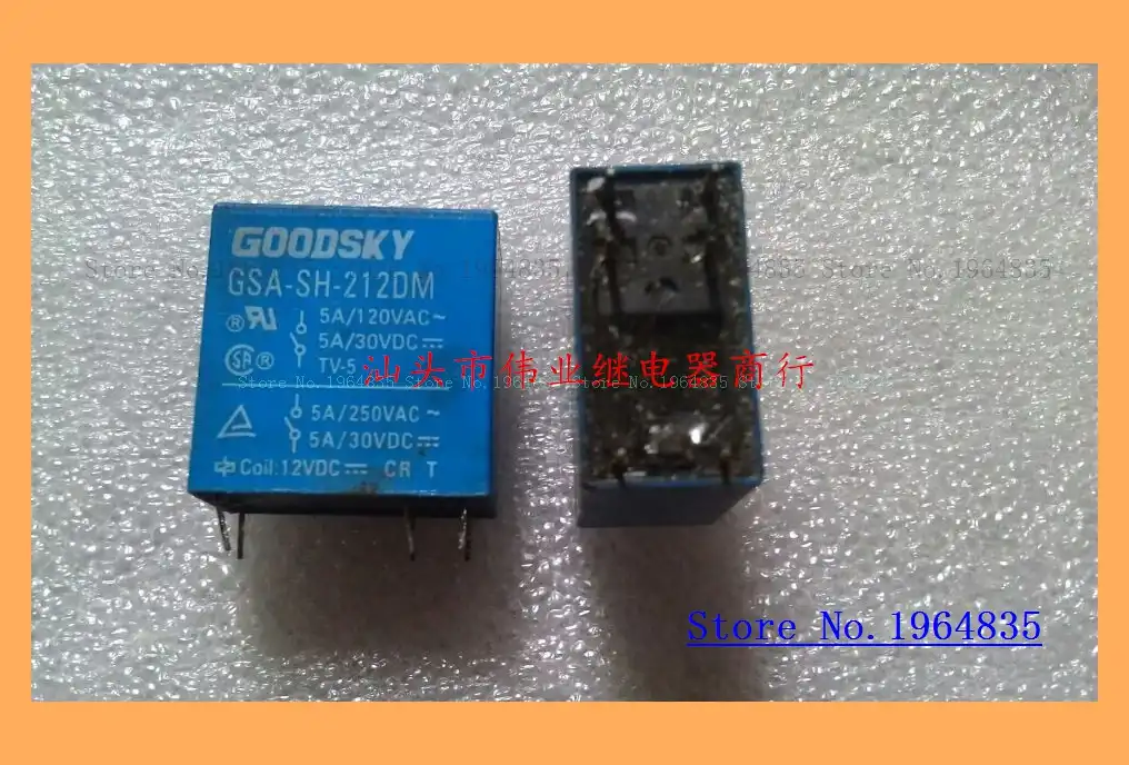

I'm trying to repair this PSU board for a Creative S750 surround sound system.
Original fault was a blown diode (D9 1N4004), I replaced it with a 1N4007 diode. I also replaced U6 7920 negative voltage regulator which used the configuration in the schematic to output -24V , I replaced it with a 7924 while removing R20, C68 and R19.
I also replaced all the crap CAPXON capacitors on the board with quality caps.
The board now outputs all the voltages it's supposed to output correctly with one problem.
When you plug the power cord the green light turns on. When you switch the unit on from the control pod for the first time after you plug the cord I hear something like a spark coming from the relay (I think), If you switch the unit off from the control pod (without unpluging the power cord) and then switch it back on, the relay click is normal without that spark sound.
One time I switched the unit off, unplugged the power cord, and then quickly plugged it in the switched it on, and it blew the D9 again.
My question, what part of this circuit can cause such a sparking sound when being turned on for the first time, or is responsible for a soft starting of the relay (if that is a thing)?
Thanks.

« Reply #1 on: September 25, 2021, 08:33:12 am »
Does D9 go open or short? Check TH1.

« Reply #3 on: September 25, 2021, 08:57:37 am »
The only thing Im able to suspect is the relay. It's doing a tough job which has possibly caused the contacts to erode causing a lot of contact bounce.

« Reply #6 on: September 25, 2021, 10:31:28 am »
BTW, you have not included your country in your profile.
If it was the relay, why does it do that spark sound the first time it clicks, and not every time its clicks, as I mentioned it only does that sound the first time after connecting the power cord, every other relay click after that is normal.

« Reply #8 on: September 25, 2021, 10:39:13 am »
The country is Egypt, I don't know why that's relevant :D.
The bridge is ok, all diodes are measuring fine. Please remember the unit is working fine
Im thinking that it's to do with whether the capacitors are charged or not, maybe. Knowing your country allows us the figure out the main voltage there. Can you easily remove the relay's cover?

« Reply #9 on: September 25, 2021, 10:51:15 am »
No, it's potted.
Looks like this one, expect it's 9v.
I'm thinking the same thing regarding charged capacitors. Maybe while replacing the capacitors I made a mistake. But where should I look?
What part of the circuit will cause such a spark or is responsible for suppressing such a spark when it's first turned on.
I think (not 100% sure) that before replacing the caps on the board, when I first got the unit and just replaced the D9 it didn't make that sparky sound. Or maybe it did and I didn't notice.

« Reply #10 on: September 25, 2021, 11:32:45 am »
Im not blaming the capacitors for being faulty or not fitted right, just the state of charge they happen to be in when the relay turns on.
You could just replace the relay if it's not to difficult to find a replacement.
Im still not certain if it's responsible for D9 shorting. While D9 is shorted, does it cause a problem? I wouldn't expect so.

« Reply #11 on: September 25, 2021, 11:41:14 am »
The purpose of D9 is to prevent C61 discharging into the 470uF capacitors when the relay first turns on. This would be audible and bad for the relay also.
Is D9 shorted at the moment?

« Reply #12 on: September 25, 2021, 12:24:56 pm »
Replacing the relay won't be easy since I can't find it locally, plus I still don't think it's an issue with the relay since all subsequent clicking sounds of the relay after the initial one is normal.
You are correct about when the D9 shorted, the unit continued to function the 0.5 minute I gave it before turning it off, didn't blow the fuse.
No, I replaced it once it went bang.
How do I prevent C61 from discharging into the 470uF capacitors? What other part of that circuit should I check?

« Reply #13 on: September 25, 2021, 12:34:49 pm »
Im out of clues for now. Only D9 is responsible for preventing C61 discharging into the 470uF capacitors at relay turn on.
