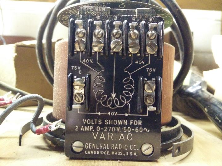

So, I inherited a bunch of WW2 era US Signal Corps and amateur radio vacuum tube gear, and the related stuff that goes along with it.  I think I've got 9 vacuum tube testers, and thousands of vacuum tubes.  Anyway.  I apparently now own one of these: https://www.recycledgoods.com/general-radio-v5h-variac-auto-transformer-pri-230vac-sec-0-260vac/ -- it looks to be in pretty good shape.  I disassembled the case, took the power cord section home and replaced the cord.  Easy peasy, lemon squeezy.
Only until I looked at the aforementioned link, did I notice its specs:
INPUT 230V
OUTPUT 0-270V
2 AMPS
...which means that it's got a tiny bit of travel beyond the input taps on the transformer to boost voltage.  Problem is: the input voltage is 230V :(
So, the variac has seven taps on it:
Of course I left the body at home and can't ohm out the different taps on the transformer's windings; but anybody have any bright ideas if it's possible, or a good idea to try to rewire this thing for:
INPUT 110V
OUTPUT 0-2??V
It came wired to terminals 2, 3, and 5; 2 + 5 were output common, 2 + 3 were input common, which I suppose makes sense for a variable transformer.
It looks like the taps are:
1) 10 o'clock tap
2) winding start
3) brush tap
4) winding end
5) 2 o'clock tap
6) 7 o'clock tap
7) 5 o'clock tap

With the existing wiring configuration that it had, if you feed it 120 volts it will work just fine. Output will be 0 to 140ish.
With all those taps you may be able to get output voltage higher, but the current capacity will take a huge hit.

I believe you remembered the connections wrong. I believe 2 is common to both in and out and 5 is 120V in. Terminal 3 is the wiper that goes from 0V to 140V. If I recall the plate on the knob is reversible depending on the taps you are using. Just divide the voltage it shows on the dial plate by 2 to get the correct voltage out with 120V in. The max current will be the 2A on the rating plate.
If you were to connect the input between 2 and 3 you would burn the winding out as you turned the knob toward 0V or you would blow a fuse. I would strongly advise using a 3-wire cord with the neutral connected to terminal 2.
Oh, and I'm editing to add one last thought. Because this is a transformer (variable autotransformer), when the wiper is toward the low end, the current flow in the lower part of the winding required to blow a 2A line fuse will be determined by the ratio of the in/out voltages. If you set the output to 12V with 120V in then it will take approximately 20A (10:1 ratio) on the output to blow the 2A line fuse and the winding on the lower part of the variac will be seeing 20A which could burn the winding open before the line fuse blows. Best solution is to use two 2A fuses, one for the line and one on the output in series with terminal 3.

Input side pin 2 is neutral, pin 6 is line. then output is pin 2 common and pin 3 variable, which will allow you to get 0V to 270VAC at the output, with the caveat that below 120VAC the max current is limited to 2A, and above 120VAC the input current is limited to 2A. Output is not isolated. If you want a lower max voltage connect input line to pin7 instead of pin 6, and this will limit max output voltage to around 210VAC, with the same caveats about current and voltage limits. Max current 2A on output or max power 240VA, whichever is lower.

The plate says "volts shown for 270V". As you should know, transformers are just voltage ratio devices: N primary turns & M secondary turns makes for an input:output voltage ratio of N:M. You can apply any primary AC voltage you like as long as the windings are insulated to at least that much.
This one is an autotransformer: there is no primary or secondary, just a single winding with several taps. The schematic is shown for 270VAC from the lowest to the highest tap, with 40, 75, 40, 75, 40 between each adjacent pair of taps to add up to 270. This is fully ratiometric, so it could be redrawn with 20, 37.5, 20, 37.5, 20 between each pair to add up to 135. The input and output cable wiring does not change.

Good news - finally got the unit at home, wiped down the brush surface with some isopropyl alcohol and a soft cloth to remove the 50+ years worth of dust.  Ohmed out the taps in order of position along the transformer and saw a progressive higher ohms along the way as I expected.
Scrapped the old power cord, scrapped the internal wiring, and put in 18ga black/hot white/neutral.  Discovered the switch is dual pole single throw, so off is *totally* off, not just switching hot.  Wired it up for 115v in, 0-270v out & hooked up a cheap outlet probe (the cheap kind that has a chime and like eight LEDs that light up from 12v to 400v) and everything seems to be in order.  Next is to find some fuse holders I can ... somehow mount in the case.  Thanks everyone!

I would not advise using a variac as a step-up transformer, because it could burn out the winding. It's best to keep them wired as they are delivered, as output=input*(0 to 110%). Also beware of wiring the wiper to the input, instead of correctly to the output: this can quickly burn it as power is delivered to a short length of winding.

There is no problem using a Variac with fixed taps for up to 1:2 ratio step up, as long as you never exceed the rated wiper current (other than as specified for short term overload).
Also, to avoid saturation, the input may not be applied to a winding tap with a lower rated voltage than the supply voltage.
At ratios above 1:2 you have to derate the output current so the current in the lower part of the winding (between the L in tap and N) does not exceed the rated wiper current:
From KCL, Ilower=Iin-Iout.
Iin*Vin=Iout*Vout
Iin=Iout*Vout/Vin
Ilower=Iout*(Vout/Vin-1)
=> for Vout/Vin>2, the derating factor is 1/(Vout/Vin -1)
For a Variac like the O.P's one, that outputs up to 270V and 2A at 230V input, with 115V input applied to a suitable tap, so that the maximum output is still 270V,  the derating factor is 74%, so the maximum output current will be fractionally under 1.5A at maximum voltage. At 250V it will be able to supply 1.7A.  When set to below 230V, the full rating will be available, but if you want it to be foolproof, use a 1.5A breaker on its output.

As long as you use an appropriate input tap, and derate correctly so that no part of the winding ever carries more than the wiper current there really shouldn't be any issues.  Its not a great deal different to using a fixed autotransformer in a step-up configuration.   However it would be prudent to initially power it up with a suitable incandescent bulb in series and check the output voltage range is as expected just in case one has made a mistake with the input tap connections.
