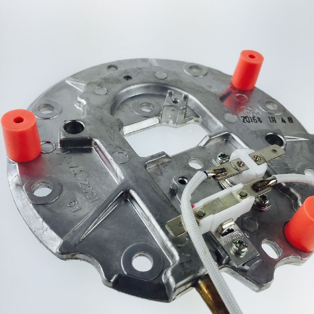

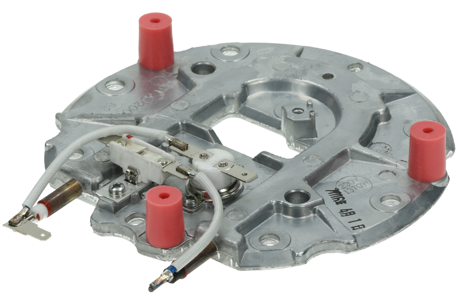

I was reading the words and not looking at the pictures.  So now I am a little unclear on what you found.
From the pictures it appears there is a thermostat in series with a thermal fuse.  The thermostat  would be the somewhat rectangular device, while the thermal fuse is the somewhat cylindrical device.  The thermostat does not match the more common configurations for an iron thermostat.  (see the link for some examples https://www.alibaba.com/showroom/steam-iron-thermostat_2.html?spm=a2700.7724857.pagination.1.71712b3696Zq0Q  )
The thermostat opens and closes as the iron temperature passes up and down through it's normal operating point and would normally be the primary temperature control.  The presence of an electronic control board casts some doubt on this, but in my opinion the board is likely to implement a timer function which automatically turns the iron off if it has not moved for a preset time, and possibly other safety/convenience features.  The thermal fuse should remain closed unless the iron goes above a preset safety temperature and then open permanently.  Its purpose is to prevent a fire if the thermostat or other control circuits fail.
The thermal fuse should show near zero ohms.  If it is open it is probably because of another failure which must be found and corrected, though there is some chance that this fuse may be the only failure.
When you said you were probing around the fuse and intermittently could get the iron to heat up what were you probing?  If it was the thermostat it would indicate a failure of this part, but a failure in the open condition which would be unlikely to damage other parts of the iron.  There is some chance to restore temporary operation by cleaning the contacts of the thermostat (the contacts between the bimetal leaves, not the power connections).  As you can see from the alibaba link there is also usually a method to change outside pressure on the leaves to change the operating temperature.  This does not show in your pictures which may indicate a different temperature control approach, or a broken/missing part.

Well, I thought the thermal fuse was the somewhat rectangular device which I posted a picture in post #4.
I thought it would be the thermal fuse because I found this catalog of Thermaster, is I think it is a thermal fuses manufacturer. The last item of this catalog is very similar (maybe with different parameters) and explains how it works. These 2 sheets of metal are tied together with a "drop" of solder which melts if a certain temperature is reached.
Quoting the catalog:
The TF2 is equipped with a solder insert placed in
direct contact with the sensing plate. Upon reaching
the specified temperature, the solder melts, opening
the electrical contacts. Resetting is impossible.
This is an actual picture of this rectangular device which has that tiny thing that looks like the solder I quoted from the link above.
https://drive.google.com/open?id=1El2SL1aeCXdYDYlEofFoGhMxRC24SmcY
Somehow I'm not being able to transfer pictures from my smartphone bluetooth to my laptop, that's why I'm uploading them to Drive. Sorry for any inconvenience.
I was probing this rectangular device and when I placed the probe on top of these 2 metal sheets, they made contact and the heating element heated up. And to make sure we are talking about the same thing, this iron has 2 heating elements. The one on the iron itself and the one we are talking now which heats up the water container to build up pressure and "produce" steam. So, I assumed this was the fuse.
Are you 100% sure this rectangular device is a thermostat instead of a thermofuse? I mean, it makes sense it is  a thermofuse.
The 2 leads of the circular device (you say it's the thermofuse) reads 0.10 ohm.

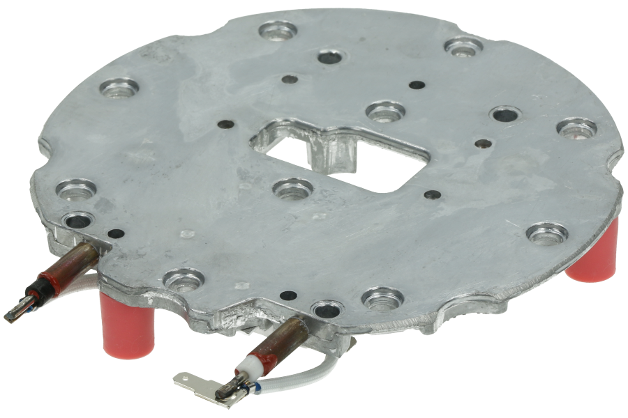

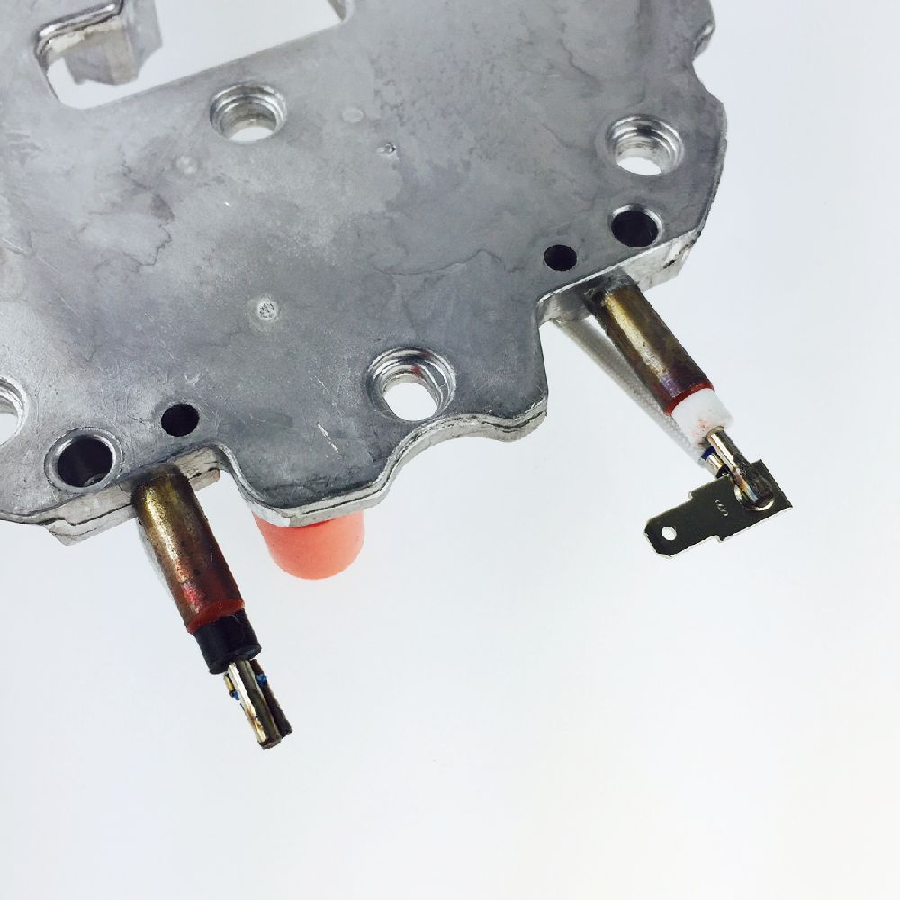

... The idea was to add a fuse before the Thermaster it, for instance 12A. That way I could check if the heating element is fine without damaging the thermaster again...
The type of heating element pictured would usually fail in one of two ways. Either, its resistance wire could fracture (go open circuit) or the insulation surrounding the wire could fail - creating a short circuit to the metal sheath that encapsulates the element. As the element heats up (when you close the Thermaster device), it cannot be open circuit. Measuring the resistance between one end of the element and the metal chassis, would determine if there was a short circuit present. So, there's no real need to power the element up to test it.
Thermaster device is a thermal cut-off. It goes open circuit when its sensing plate reaches a specified temperature (set by the melting point of the solder that lies between the plate and the sprung contact). The large surface area of the sensing plate and contact means that the current passing through the device is unlikely to heat it up sufficiently to trip it.
The most likely reason for the thermal cut-off opening is that the fixed temperature bimetallic thermostat, which is also in series with the element, has failed in the closed position (its contacts have welded together). Whenever a thermal cut-off needs to be replaced, the thermostat should be replaced at the same time:

I agree with JFJ's analysis.  Appearances can be deceiving.  Thermal fuses are packaged in identical packages to the thermostat in yours.  And I was not familiar with the type of thermal fuse in yours.  The appearance is similar to a thermostat.

@JFJ I was trying to understand (exactly) what you said in your last post about the resistance wire to fracture, etc.
Coul you please point out in the same picture you used in your post, what is this wire you're talking about? And also point out the insulation you refer to?
And then, please also let me know exactly what you mean here:
I mean, I understand what you say but I'm afraid of not understanding the exact parts you're referring to. When you say the end of the element and the metal chassis, I'm not 100% sure to what parts you're referring to! I'm sorry, I'm trying to be 100% sure in what I'm trying to do!
