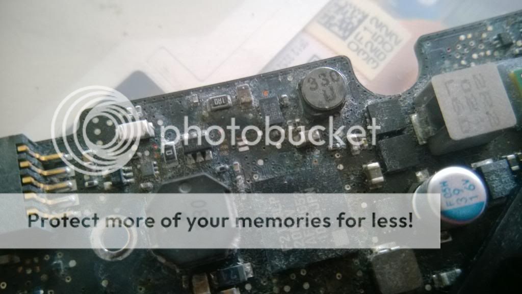

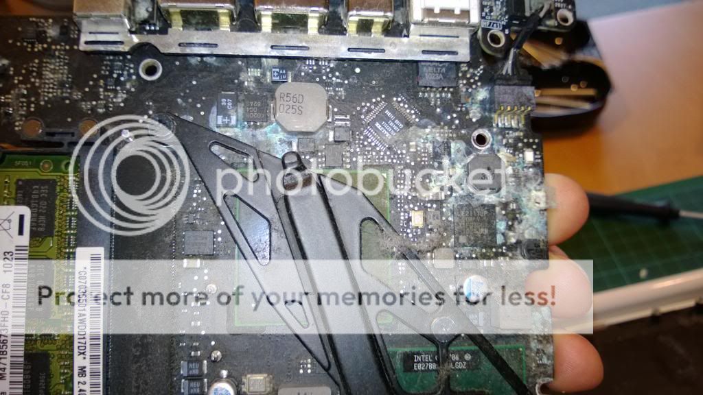

Hello!
I got a water damaged macbook I want to repair. I opened it and found nothing obvious.
Than I removed all the components and saw the backside of the logic board. It was quite dirty.
 I scraped some of the dirt with a little screwdriver off.
Then I reconnected all the components and connected the power supply. There was no effect when I pushed the on button. The power supply works with with another mac, so I know it works. In addition, the screen is damaged. You can see a lot of tiny bubbles in the panel.
Maybe it still works, but I can not test it as long as the logic board is not working.
When I will have the macbook repaired, I either want to used it or sell it on ebay. I found a macbook that is working on ebay: http://www.ebay.de/itm/200980412901?ssPageName=STRK:MEWAX:IT&_trksid=p3984.m1423.l2648
The seller writes that sometimes the screen does not work or shows green rows. He sells the macbook for 200€ as an auction or 300€ if you want to buy it immediatly. Does it is more trouble than its worth to repair the macbook with the macbook from ebay? Or can I maybe repair the logicboard of my macbook? Is it very likely than components were dameged when the water went inside the macbook? Are there any fuses on the pcb that protect the components on the pcb? Can you give me instructions what I could check? I have a soldering iron, a scope and a multimeter.
« Last Edit: October 29, 2013, 02:46:08 pm by Heribert Hechtersheim »

Your best bet is to ask on the macrumors forums.Ive recently fixed an A1278 with water damage,though nowhere near as bad as yours.
http://forums.macrumors.com/showthread.php?t=972699
Youll also find various schematics there .Good luck with it .
EDIT: Clean up the board with isopropyl alcohol and a brush and see how bad it looks .The hardest part will be identifying all the parts that need replacing.Make a decision,try and repair it or salvage as many parts as possible to sell on,namely the HDD,memory,dvd , keyboard, and  the logic board even in its present state would sell.

you need isopropylic alcool (IPA), a toothbrush or an ultrasonic bath (or both)
you spray the ipa on the corroded parts, then brush with energy and rince again with ipa
then a bath some minutes with ipa under ultrasonic pulses
you let it dry some hours
and you try to power on
sometimes you have to start this over 2 or 3 times, depends if you have some "alive" signs or not.
the display is dead you must buy another part but for the logic board it's not totally lost IMHO
good luck.

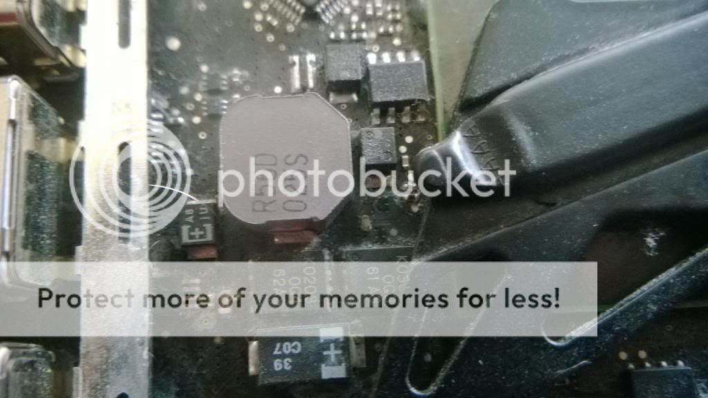

I poured a bit IPA on the pcb and cleaned it with an electric toothbrush.
The result does not satisfy me. Dust is still sticking on the pcb and components and the fluid left some lines on the surface behind. Maybe I have to repeat the process more times or pure more IPA on the pcb.
For now, I will keep the parts. If I fail repairing the macbook, I will try to sell them.

A lot of that crud is dissolved minerals and electrolytes in tap water.
You can use distilled water sold specifically for steam irons (and it should say on the jug) to rinse the water soluble minerals.
Basically want to wash away the stuff the IPA would not clean. And once it looks as clean as possible then dry it the best you can, then pack it in a bag of dry rice to absorb the water.
Anyway, that would be my next step if it were me and I was determined to try to get it working.

if you want to go radical do it in the dishwasher (Glass-Program). That sould clean anything, after this into the oven at 50°C or if you have this "Nachtspeicheröfen" at home on one of these. Then total drying for days.
Another Idea, less crazy, would be the TFT-Spray from Kontakt-Chemie. Optional: After cleaning pour with clean water and a brush, don't be shy but try not to dump coils, transformers, switches and so on.
And, dry, dry, dry. At least 3 days on a warm spot.
Thank you for your suggestion. I decided to put my main board in the dishwasher too. Now I put it on the ground and let it dry because we have floor heating.
I didn't want to spend money again for distilled water and dry ice. The ipa was already an expensive purchase and I was very lazy. So I just put it in the dish washer.
Define "water", was it saltwater, then forget it the corrosion will only continue over time. I see a lot of corrosion which seems to suggest that either it was immersed in saltwater or water very, very high in minerals.
My brother said it was a bottle filled with tap water which opened up in his bag.
The "power system architecture" page of the schematic will be very useful for figuring out where to look for voltages.
That F2117LP BGA is the EC. MC34845 below it is the backlight controller.
Seeing as the LED on the power in connector is controlled by a digital protocol and it's turning on (under control of the EC), indicates there is some sign of activity and the EC might be running - you can scope the center pin on the connector to confirm the communication.
Thank you for your suggestions. I will check that when the board is dry again.
Hello to the Forum!!
and about the macbook, i have just fixed a water damaged macbook. i did not got so mutch water as your machine but it did not work anymore. so the macbook was a total failure anyway. I decided to go for it and try to fix it the simple way, and hell yes it worked!!!!
the macbook did have the problem that it wont charge anymore, the rest was fine. and it has same kind of corrosion inside...
what i have done:
take out the mainboard, clean it very good with some kind of PCB or electronic cleaner, brush all corrosion away, and then put it in to you'r ReflowOven... yes sure I dont have a ReflowOven as well... just put it in your oven, 230C for 15 minutes.
let it cool down and reassemble the blody mainboard and see if it works...
and yes, my macbook works again now, but since it was in the oven the wireles and Bluetooth dont work anymore... all the rest is now working again...
gooooood luck!
Thank you! What oven mode did you use? Circulating hot air or heating from above/below (I don't know the technical terms in english)? In circulating air mode, our oven can only get up to 190° C. Does gravity affect the components on the bottom side when the solder is liquid?
