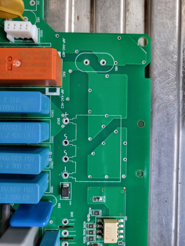

Hey Whales, OK, I put more detailed pictures although you're interpretation is correct. I mean the circeled (in red, by you) zones. The strange thing is that the other side (component side) of the print looks impeccable, as new. So the burn traces are really just on the back side surface of the board. I join the front side picture too. I assume the burns are 'fresh' and not due to dust accumulation by heath over the years. My experience is that such 'dirt' can easily be wiped off. Not on this spots...  It really looks to be caused by 'fire' or 'explosions'. So I assume some burned tracks. The white 'rectangles' are so imprinted on the pcb... Maybe showing the position of 'plates' in between the multi layers of the board?
The two soldering points top left of that rectangles (on the new bigger picture) is the mounting of a varistor on component side. This too looks 'as new' at component side! The location is indicated by an oval and the letters 'VR1'. You can also see the (now) open holes for the (dismounted) rectifier and one of the IGBT's?  So I was quite surprised by looking at the back side as my first impression when inspecting the component side of the pcb was 'notting visibly wrong'.
Quite bizar, that white rectangles, as if indicates the place where some component should be installed, but it is the back side of the pcb, and no 'fallen of' components found... ;-). I think it indicates the location of a 'plate' in between the multiple layers, and those where connected by the burned 'bridges' (?). So I'm afraid it's end of story. Even if I 'd find out the 'value' of what is missing (?) there, how should I solder it? To what connection?

Offline Whales
  • Posts: 2116
    • Halestrom
Re: Repair of Bosch induction cooktop touch controls
« Reply #59 on: January 08, 2024, 10:28:41 pm »
Thankyou for the higher res photos.
Wow those 3 spots are indeed blown traces.  The copper has completely vaporised in 3 locations in series with each other.  There must have been a lot of continual high-voltage and high-frequency arcing.  Possibly the high frequency nature of the AC made it do a really neat and tidy job of milling away the copper?
The white circle are caused by the heat affecting the green soldermask.  I am not sure what caused the different smoke colours (brown & black), perhaps the 1st arc was a different temperature and size, then the others were smaller because of the higher series resistance of having to sustain multiple arcs.
Something is very wrong with your board if it was arcing for this long, eating away 3 different spots in series, all without stopping or complaining.  Possibly the entire high-power LC tank circuit is bad (bad capacitors?) or maybe the IGBTs were being driven too hard (bad sensing?).  I wish I could be of more help, sorry.
