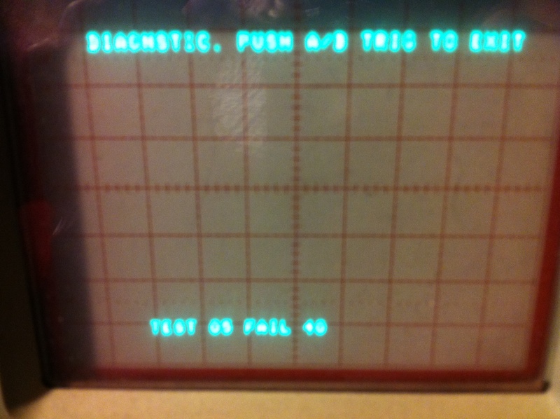

Upon power up there was a very blurred barely visible image. Good, I thought, at least there is beam current. I fiddled around a bit, but couldn't get an intelligible trace or menu. I left it on for a while and when I came back the image had improved and the screen displayed an error code. TEST 05 FAIL 40.
I referred to the handy service manual which revealed that some voltages were too high. I took the back off of it and found the test points.
The -8V rail was reading -5.7 and the -5V rail was reading -3.8, no good. These symptoms reek awfully of PSU capacitors to me. Teardown time.

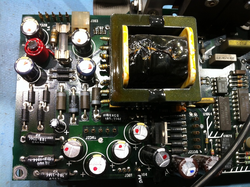

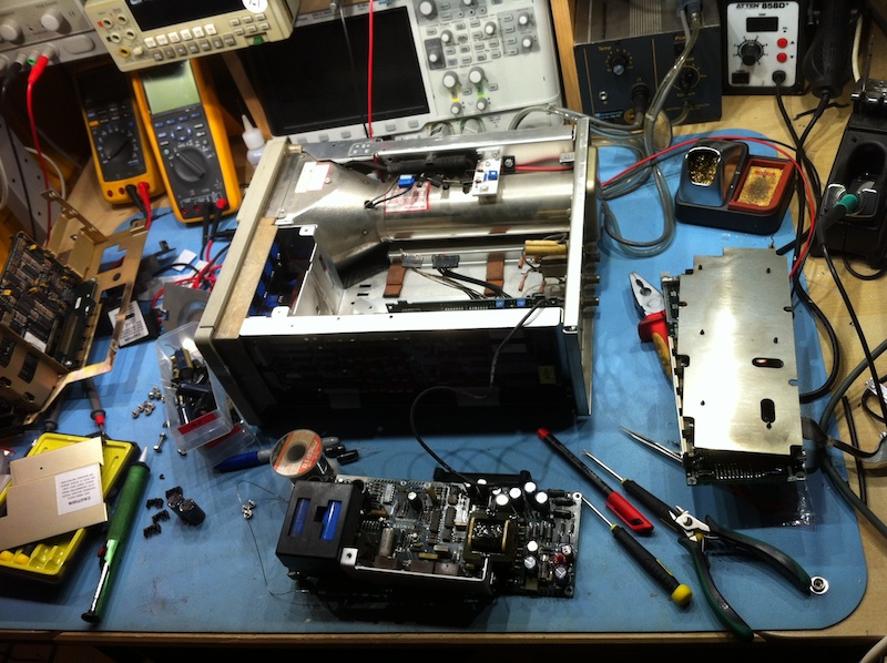

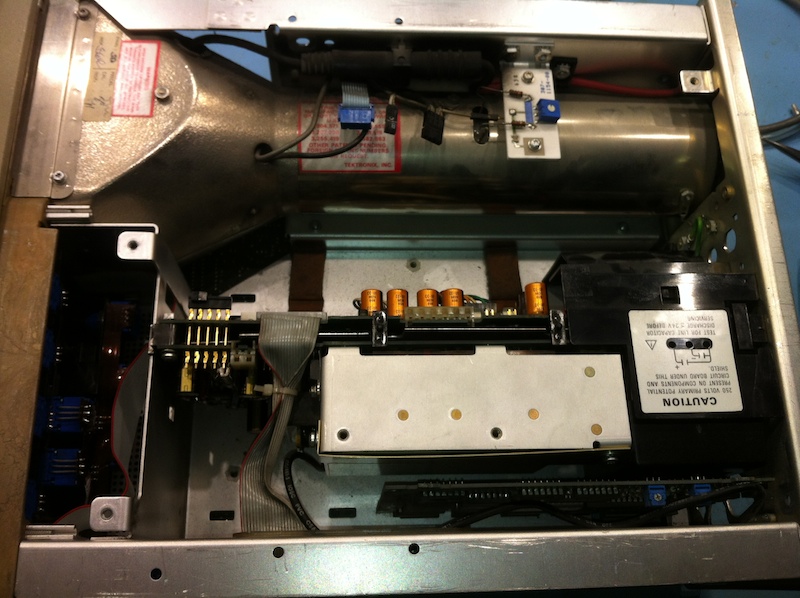

Here is the power supply module in the middle.
Got it all out.

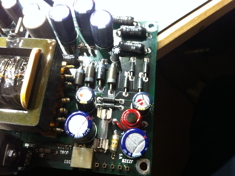

Someone had already had a go at this in the past. However, they had replaced the original 105ºC capacitors with 85ºC ones. One of theirs had a big dent in it.

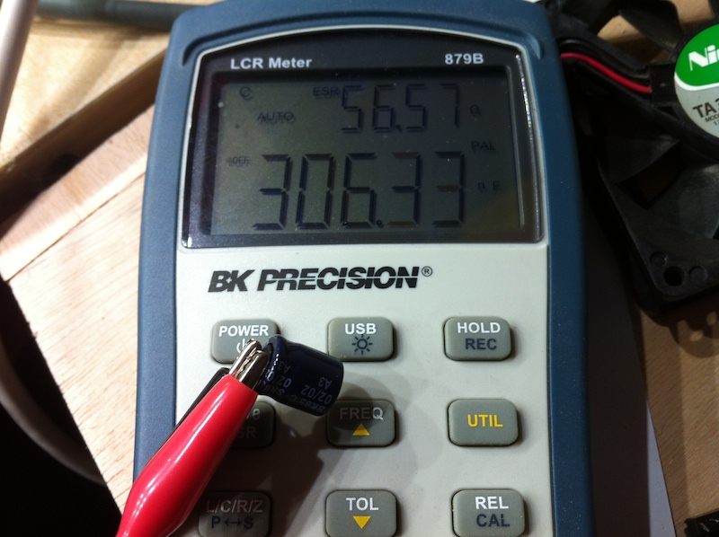

Another one had an ESR of more than 50?.
I set about testing and if necessary replacing all of the output capacitors. I put red marks on my new 105ºC capacitors. Only two capacitors (factory originals) had a good low ESR, so I put them back in.

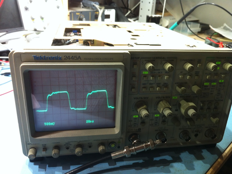

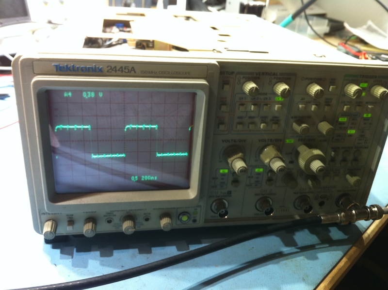

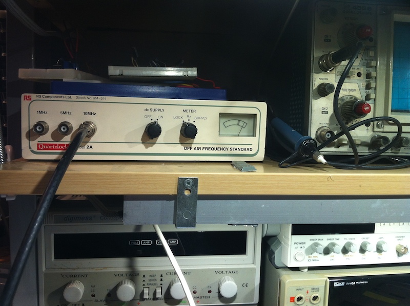

Here it is connected to my Off Air frequency standard. My frequency standard doesn't have very fast logic in it, so the waveform is not very clean, but it is accurate.
10MHz into Ch1.
1MHz into Ch4.
Looks spot on to me.
