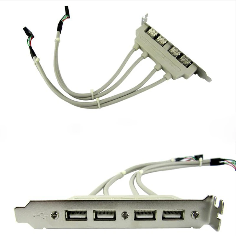

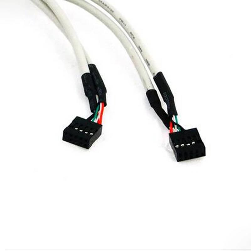

Use something like this:
https://ae01.alicdn.com/kf/HTB1APEKSpXXXXbhXpXXq6xXFXXXy/6-pcs-PCI-C-bles-9pin-USB2-0-Connecteur-Carte-M-re-USB-Extension-C-ble.jpg
https://ae01.alicdn.com/kf/HTB14QP_SpXXXXakapXXq6xXFXXXR/6-pcs-PCI-C-bles-9pin-USB2-0-Connecteur-Carte-M-re-USB-Extension-C-ble.jpg
Then plug a regular USB flash drive into it.
I didn't find time to solder a new flash chip on the module yet, BUT...
I've tried with the cable and USB flash drive, like you suggested, and it actually detects the USB drive - usb drive blinks and the console message on the firewall is different:
But I'm not sure which partition type should I use.
Startup process is stuck at "Recovering partition ...".
Maybe I should remove that flash module from the working Firewall and try to attach it to the computer using USB A to duPont pin adaptor cable to check the partition type, and maybe clone the contents of that flash?
I'll have probably the same situation when I try to boot using that original module with replaced flash.
