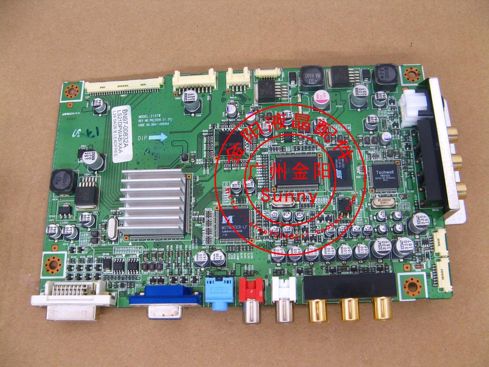

I have a weird failure with this Samsung 215TW. Let me start off by stating what I've done:
I replaced the bad caps (bloated CapXon) on the power supply board and checked voltages at the local regulators. Everything looks good with voltage, but no fix yet. I also checked over the main board for bad solder joints and other physical maladies.
Here's a picture of the strange glitch:
As you can see, it looks pretty scrambled. This should be something like a message stating "no source found" or something like that. It floats around the screen. And when I try to change inputs, it pops up into the upper-left corner where the input message box would normally be. Besides that, I haven't got video when testing the inputs. To be fair, and you can beat me up over this if you want, I have only tested the VGA input. But I really don't think that's going to be the issue because something looks wrong besides input. I'm thinking it's a communications issue somewhere on the main board. There is a service manual available online that details the schematics of the monitor.
Any ideas?

Looks like there's some dual port RAM that's not getting written.

Hm, there's a 128M SDRAM chip, but it looks like the only thing writing to it is the main ADC / Prescaler / LVDS. I'll see if I can give it a probe.

It looks like the eeprom is corrupt to me .

My main monitor is a Belinea 21' that does similar thing on VGA :), but works perfectly on DVI. When on DVI and with 1:1 mapping video is bypassing scaler completely. Try dvi before going further, even with corrupted flash or bad memory there is a chance it will work.
http://www.d43d.ru/forums/index.php?/gallery/image/1357-samsung-215tw/
http://img03.taobaocdn.com/bao/uploaded/i3/T1M9Y0XoNkXXaoqCvb_094912.jpg
http://remont-aud.net/_fr/86/4958775.jpg
as for the fault I dont think its flash, even solid background is corrupted on your picture. Check lvds cables, freeze/heat/tap ram chip.
