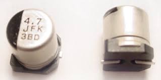

How would I test the surface mount caps on the board for failure? Or even the solid metal can surface mount caps?
You need to look up the part numbers of the 2 large chips. Get their data sheets and look at the block diagrams for how they work internally.

The main board only has some of the small surface mount caps, like these and these.  They look pretty well sealed, do they dry up in the same way? Can they be tested in the same way as regular caps? (Unsolder one side, measure capacitance and ESR). I have a budget ESR meter on order from an eBay seller, it's not good, but all I can afford right now. It will give a rough estimate, at least.

Those silver can electrolytics are evil.
They dry out and leak just like any other electrolytic capacitor which has a liquid electrolyte
have a look around 20:15 onward to see what they're capable of.
 |O :palm:
so you spend $20 to measure $5 of capacitors, instead of replacing all of them :clap:
