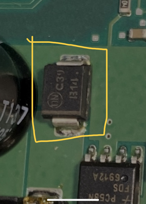

I'm working on a Siemens PCU 50 Industrial PC and I could use some help identifying the below part. No matter where I type in the part number to identify a datasheet it's coming back with nothing.
Your help would be appreciated, thank you

I don't see any pic.

Sorry for not being able to see the image apparently I cannot use the share feature on Sync.com to host my photo's.
You should be able to see the photo now.

Most likely candidate is ON Semi MBRA140. 1A 40V Schottky.

Hi markav2,
The datasheet of the part can be found
here
