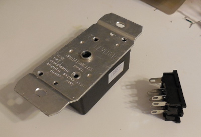

I decided I could insert an isolation relay, thus moving all the arcing to the relay contacts (0.6A valve with 2A surge), and the wiper would only have to drive the 120VAC coil (about 10mA).
To house the relay socket and wiring, I ripped out the guts of a dimmer:
I also scratched the circuit into back of the enclosure and wiped it with some white paint:
There's plenty of room near the valve, but the valve is operated by a Neutral wire (white) and a Valve wire (brown) that the wiper connects to Line (black).  I needed an unswitched Line for the relay COMmon contacts, so I forked a spade connector in the junction box:
