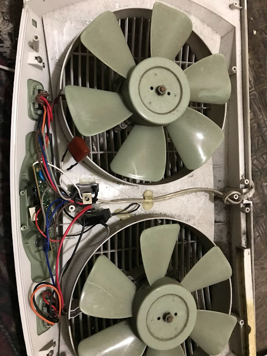

A very common window fan type, and has been for at least two decades. This one purch'd new in 2008, but with relatively low hours.
PROBLEM: Takes a while (20 min) for fan to start working correctly. During that time, both fans just barely turn when multi-mode (electronic) button is pressed. Then (after 5 min) it will go into speeds (1, 2, 3) but only for second ... before off'ing.
But  then (after 15 min of being plugged in) the unit works perfectly, EXCEPT, the fans (either / both) won't spin in reverse (exhaust). When switched, to EXHAUST, they stop and hum/buzz.
IMPORTANT-----BOTH FANS (MIS)BEHAVE THE SAME WAY (including non-operation on INDEPENDENT reverse switches)
Took the fan apart but haven't tested anything yet (e.g., capacitance, ESR). I've heard that the starting cap (black, rectangular 2.5 uF, 250 v) can  cause issues. But these are plastic (poly/ mylar???) caps, albeit cheap Chinese. There is single low-voltage electro cap on the PCB, but it does not look bulged.

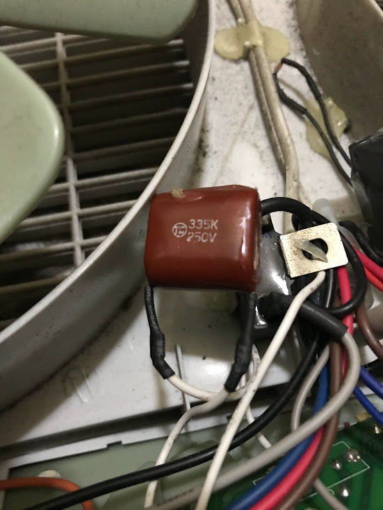

Plastic film capacitors can degrade too. Every time they are hit with a voltage transient (surge) they can lose a bit of their capacitance, little by little with every transient the capacitor is subjected to.
How does the electronic speed control work? Is it switching between different speed windings on the motors, or using some kind of TRIAC circuit? Does the control board use a capacitive dropper power supply? If so, don't forget to check that cap too as it's likely a film cap also and since it receives power at all times the unit is plugged in, would definitely be vulnerable to degradation by surges.

Yes, I think it's going to be either the motor run (not "starting") caps self healing themselves to death - they will have been hit with the same number and size of transients, or lubrication failure.
I wouldn't be at all surprised if it was a combination of both.

ANYWAY, the problem is solved. My first hunch was right ... that it ain't the poly's. The answer is in the photo(s) and in my first paragraph.

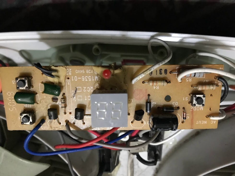

Going back to the problem, my bet is on the electrolytic - once it has warmed up sufficiently, its ESR drops enough to smooth the supply to the MCU and it doesn't keep resetting.

That's a reasonable guess, can't say without testing the ESR or replacing it, although I would expect other symptoms like a dim/flickering display or obvious signs of resetting.

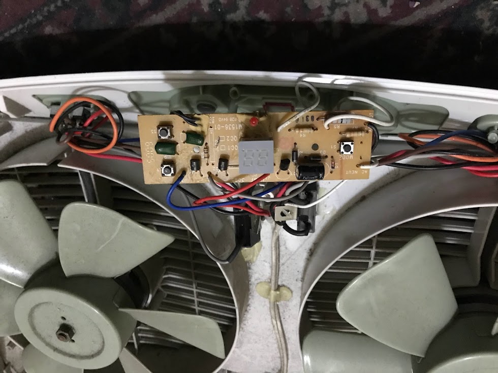

There is old adhesive on the pcb.

Yes ... that electro cap (6.3v 1000uF). If you look at the photo, you can kinda see it swelling at top. All I had was a 50v 330uf. Which worked.
