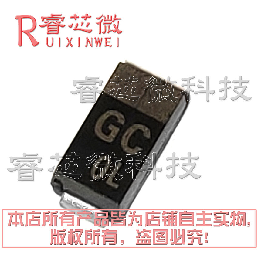

I don't get stumped often this ones got me.. Diode ID?? GC 1E anyone?
Possible Candidate? U1GC44 or RB068VWM-30TF

U1GC44, Toshiba, rectifier diode, 1A, 400V, marking GC, SMA/DO-214AC:
https://datasheet.sisoog.com/file/7a657573/datasheet/f8d7de9079fb65a94acbecefc451543271450002.pdf
http://markingcodes.com/search/c/gc
https://www.taobao.com/list/item/625881089506.htm
(photo of UIGC44)
https://img.alicdn.com/imgextra/i1/1819684702/O1CN01UXoq3f1kbYxj9tncb_!!1819684702.jpg
