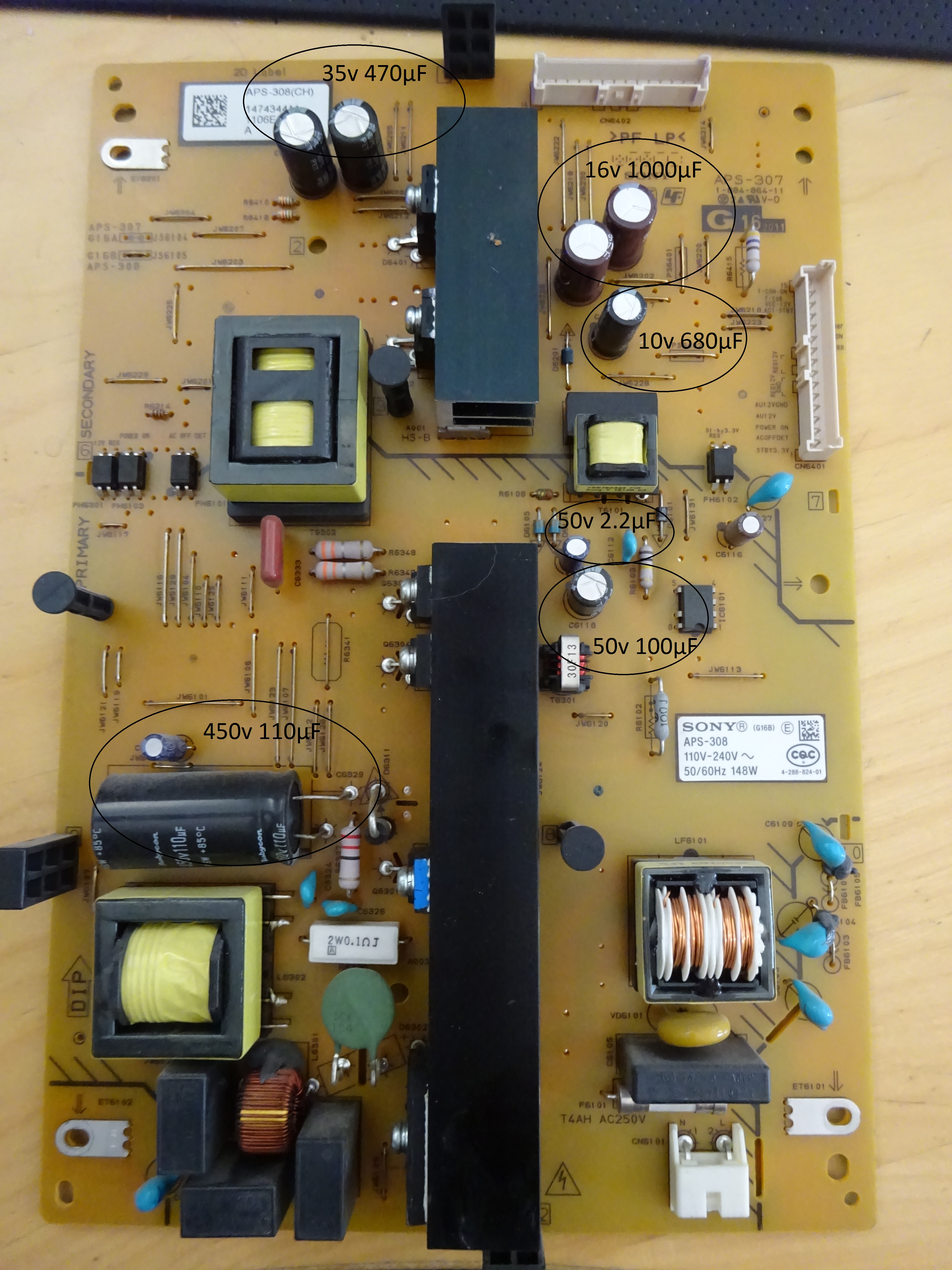

I took a high-res picture of the Sony APS-308 power supply with the capacitor values next to it:
The two caps on the left top (just under the type number) are 470µF each and when I measure I get 1226µF (or sometimes even higher) and I suspect these are in parallel with some others.

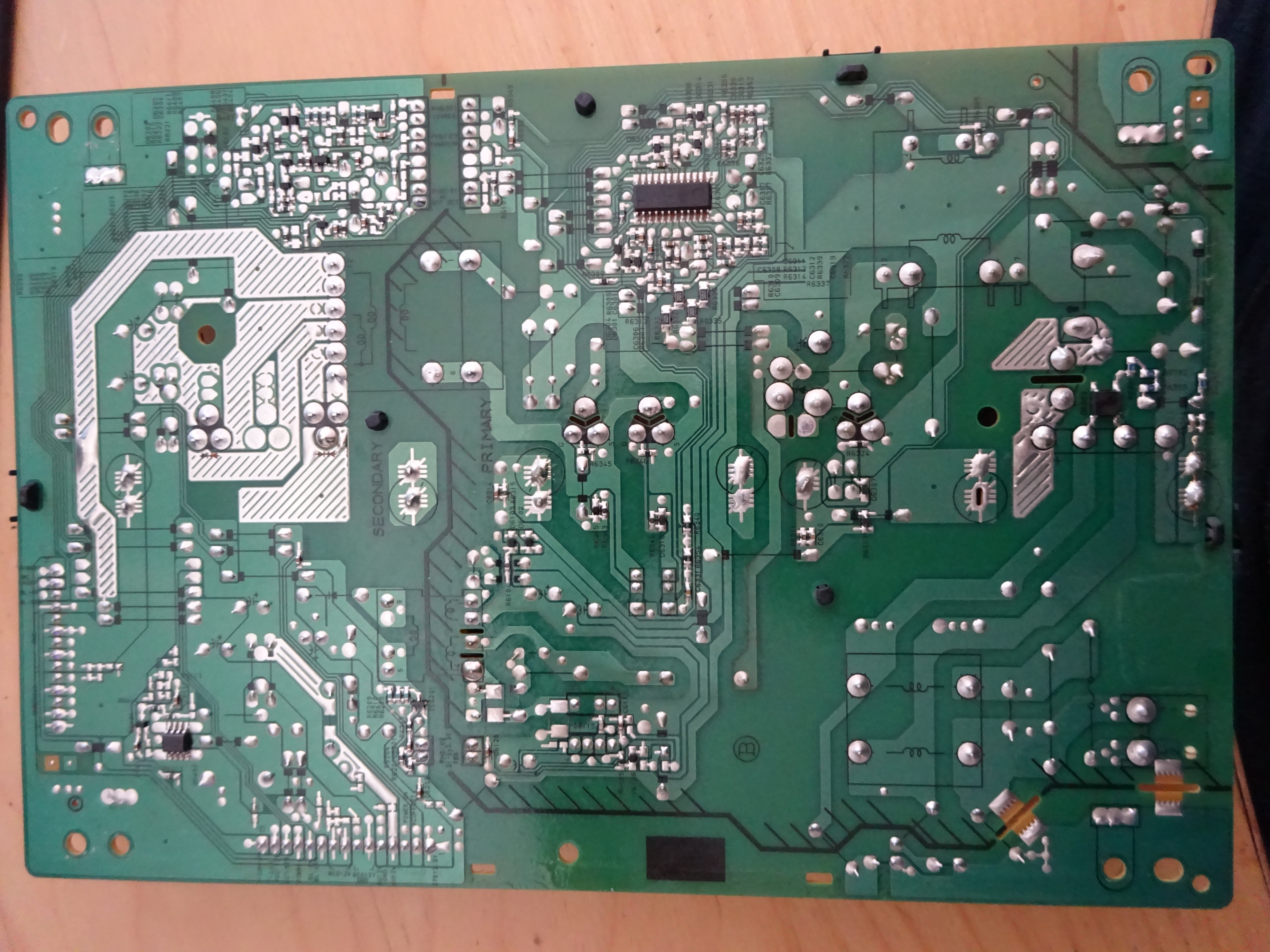

I also created a picture of the back:
What would be the right next step to diagnose this issue?

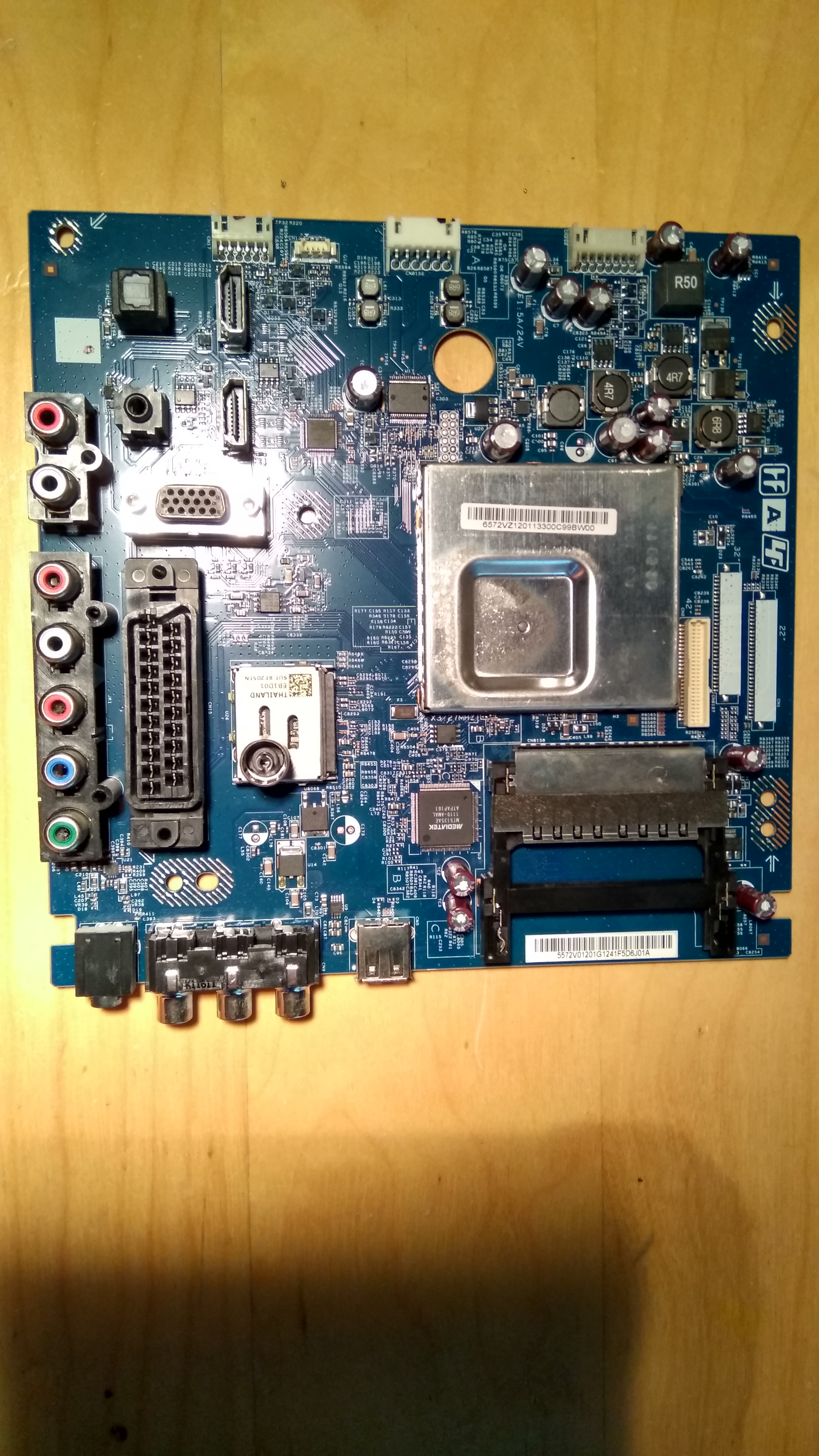

After some testing I can tell the power supply is fine and that the problem is in the t-conn board.
Here's a picture:
I can see that the 3.3v (t-conn-on) is going up and down which causes the power supply to shutdown. I do see a 12v rail to be turned on on the t-conn board which means POWER ON is high on the power supply. This rail is staying on during reboot but I do see voltage drops on other parts of the board (on test points). I took off a cap that I thought was defective but it was just fine testing it standonline.
 I have a hard time figuring out how to proceed with testing this and I really want to learn how to diagnose this. Anyone that can point me in the right direction?

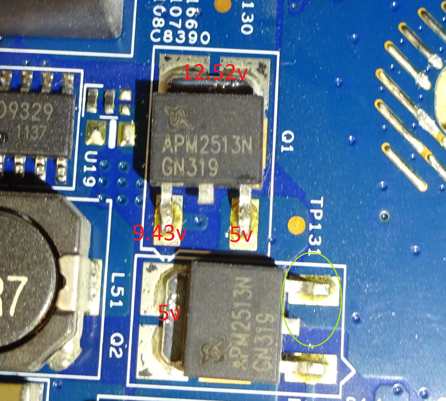

I think I messed up  :-\. While measuring Q1 and Q2 is shorted two pins on Q2 (the two pins in the green circle). And now this DC-DC converter N-Channel Enhancement Mode MOSFET is a dead short. It needs to be replaced :(. I'm sure this is what they call a rookie mistake.
This is what I measured so far (red probe on the pin, black probe on ground):
I did found the datasheet here: http://www.anpec.com.tw/ashx_prod_file.ashx?prod_id=161&file_path=20081121131637724.pdf&original_name=APM2513NU.pdf

It looks like you shorted the 5V rail to ground based on the picture.  This would have killed Q1 as it is being supplied 12V from the PSU.  The pin you measured 9.43V on is the gate of the MOSFET and is usually a square wave control signal.  You can quickly test all the MOSFETs for shorts using your meter in diode test mode.  There should be no reading from the gate pin to the drain or source pins unless there is a pulldown or pullup resistor to improve the MOSFET switching times.  Between the source and drain pin you should get the diode drop voltage of the internal protection diode in one direction and in the other no reading.
Thanks for your message! I think both Q1 and Q2 are dead. All pins I measure are a direct short to ground. I've ordered new parts and I need to wait for those to arrive.  :-[
