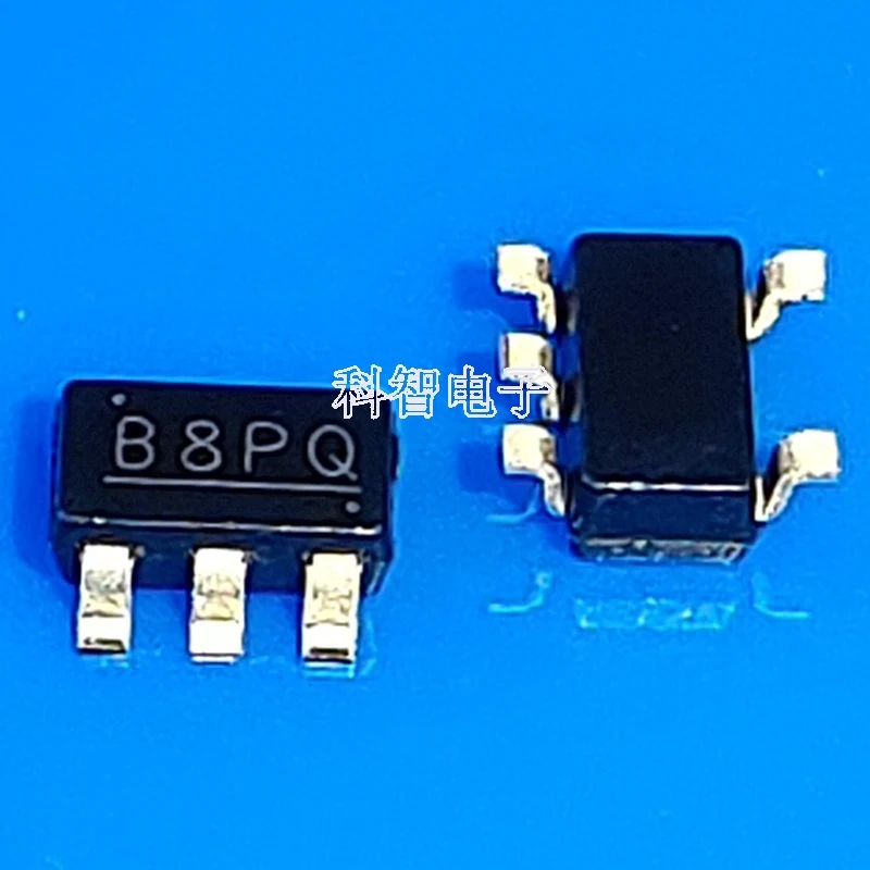

U1 is marked B8PW

Assuming it is a voltage detector, I would expect the output of U1 to be either at it's Vdd or Vss pins not some halfway value. It may well be an open-drain output. What happens if you put a lowish value resistor say 1k between pins 1&2 (it may help to remove it first)
Oh, if you did have a short between pins 2&3 that would permanantly load the top battery cell via R2/R10 which isn't ideal although hopefully the battery charger/BMS can cope with it.
Someone over on badcaps mentioned it looks like aS-80830CNMC a 3v voltage detector
looking up the datasheet
S-80830CNMC-B8P-T2
Series Seiko Instruments
SOT-23-5
Voltage detector IC
3.0V±2%, -Reset ODO
Nch open-drain output (Active Low)
So should be passing battery voltage - like you say not some halfway value
I can try adding a high value resistor between pin 1 and 2 - I'll report back.
Correct on loading the top battery cell, thankfully I've only used my batteries for testing this briefly and as theres no output from this board through the pmos should be drawing minimal current :)

Sorry, I messed up yesterday, I meant to say bridge pins 1&3 not 1&2 with the resistor (was feeling under the weather which is why I was on here instead of working!). The o/p of U1 doesn't "pass through" anything as it looks to be an open-drain output so should basically do the same - bridging OUT & VSS when it asserts its output.
That should provide the PMOS (Q3?) with a Vgs to turn on via R8. (I think that the source of that FET i.e. junction of R7/R4 should be at VBAT +20V?). Then hopefully Q3/R13 node goes to VBAT.

Ok I think I was looking at the cmos implementation, thanks for explaining.
So output is floating below 3v detect voltage or pulled down to VSS when above 3v detected, with a hysteresis width?
bridging pin 1 and 3 with 1kohm does pull the output to vss
you're correct with resistor added Q3 has Vss via R8, and VBat at R7/R4 and again at Q3/R13

Looking at the datasheet for the Seiko/Ablic device it lookls like the o/p is pulled low when the battery is low, so looks like that end of the circuit is working. I'd expect the gate signal to pull up to VBAT so not sure about your 18.67V reading, probably your meter's internal Z affecting the reading.
You could temporarily remove R8 I suppose to isolate U1 & get on with fault finding.
